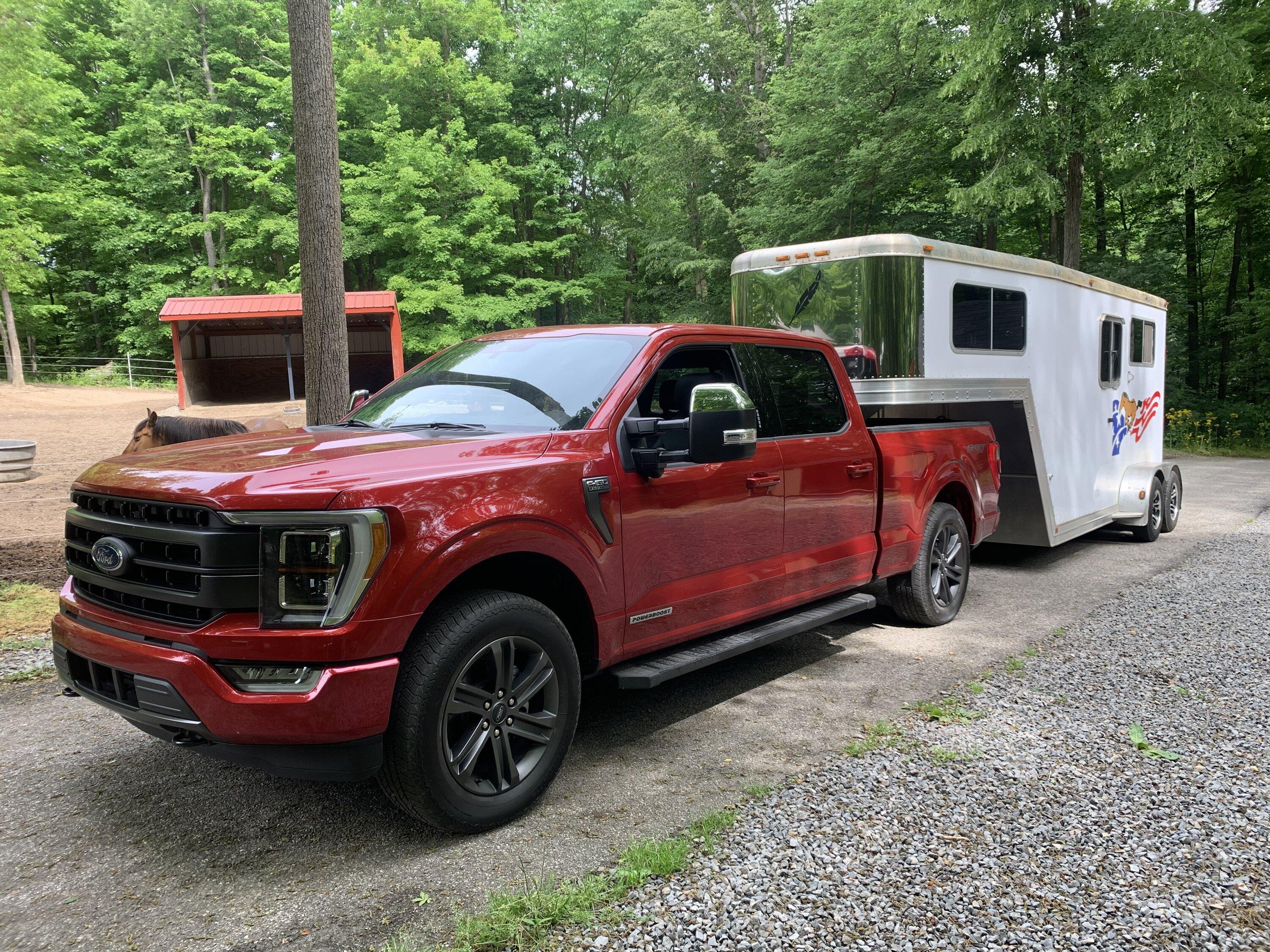

After 18 months, my truck got the OTA update to use stickers for Pro Trailer Backup Assist, so I now want to move my yaw sensor to my gooseneck horse trailer. Anybody use theirs with a gooseneck? How did it go? Anything I should know?

Yes, I am aware of all this, but I know I saw a post or two somewhere that it can be hacked to work, however the posts were long ago, and now lost to time.
The yaw sensor supplied with a Super Duty is the same, the camera positions are probably different, but perhaps when I add a trailer if I call it a conventional trailer... We'll see.
I installed the yaw sensor to the vertical front wall of the trailer, so all that remains is the calibration test. Details to follow.

Got it to work, amazingly. Mounted the yaw sensor to the left front vertical wall of the trailer. Added a new trailer, and selected 'conventional' instead of 'gooseneck.' Took it to a parking lot to calibrate, punched the button, drove straight, turned once, and bingo, calibrated! Much faster calibration than my utility trailer using a sticker.
Ford F-150 Pro Trailer Backup Assist on a Gooseneck - Update: It works!! IMG_0069
Ford F-150 Pro Trailer Backup Assist on a Gooseneck - Update: It works!! IMG_0070
Tested it in the parking lot, and it works just fine. Holds straight when the knob is released and centered, turns when the knob is turned. No problems. If you have a yaw sensor, give it a try.
