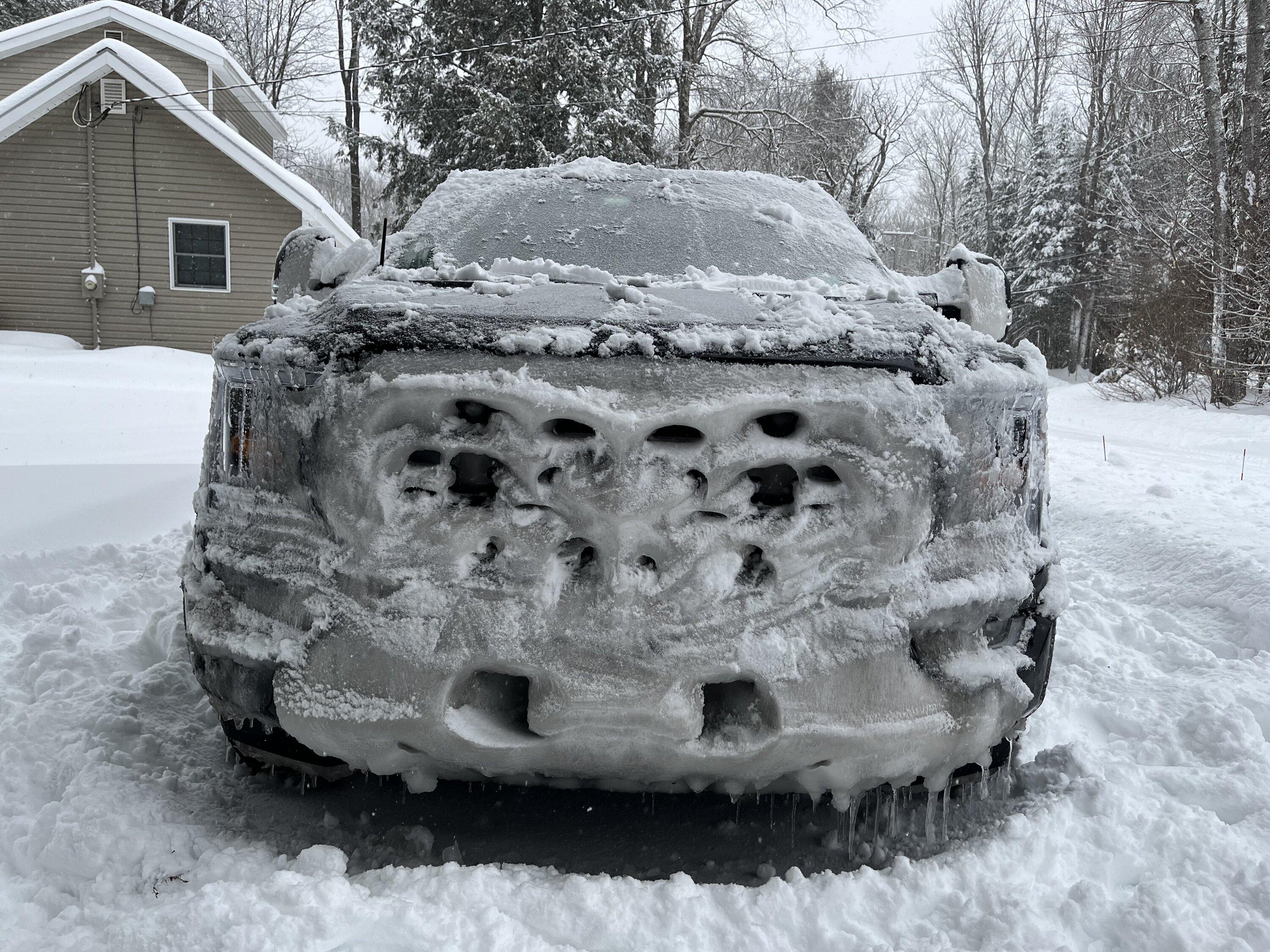

Mine has been doing that for the last week, almost every day. It happened last winter too and when I asked the dealer about it when I went in for an oil change, they looked it up and it was the air dam. The malfunction comes up after it’s cold enough the free the dam open or shut. It’s gotten cold here ( highs below freezing) over the last week and a half. It’s getting very annoying but I have ordered a 2024 so as long as it keeps going off on its own, I’m going to ignore it. Even though the new one won’t arrive for a couple months.
I don’t know if I’d accept that as being the cause. I’ve frozen mine solid for a few days until they thawed and I never had a warning or error message on the dash.
For example…
Ford F-150 Powertrain Malfunction Again IMG_3659
