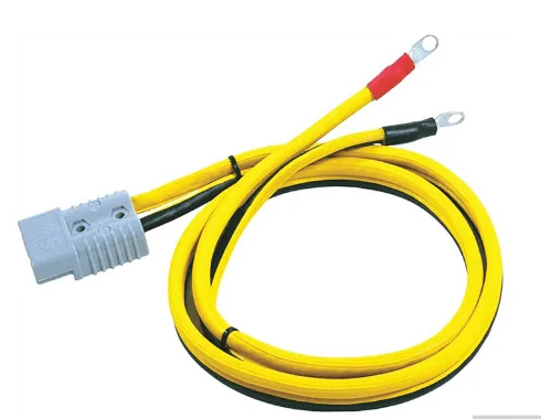

You'll want at least a cable with 4AWG wire, and you'll need an equally capable connector. I would highly recommend a fuse, circuit breaker, and possibly a disconnect switch also to be in the circuit. Automotive or Marine parts shops should have the types of parts you need.
