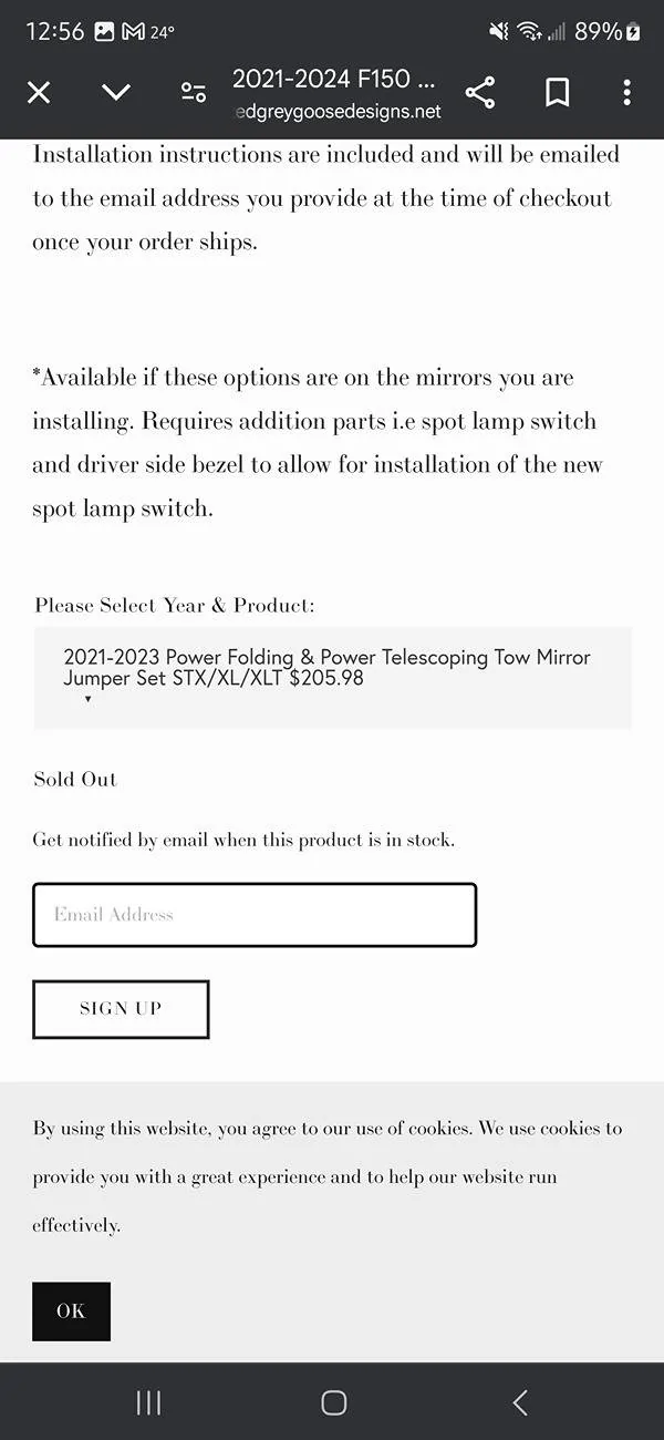

I have read too many threads to keep it straight so I will ask here. I upgraded from standard manual tow mirrors to power fold and telescoping. Bought the OEM kit from ford, or should I say half a kit. It doesn’t come with pig tail for switch think I found the correct one. No wire instructions. Boosted grey goose list one but on back order and not responding. The mirrors are on the truck. Can any one tell me what wires I need to add to make them work. Also need a new master window switch. I know I need to do for scan to make it all work once wired. Ford parts is useless in doing this upgrade.

I'd buy them, but they've been out for a while for my truck.
Any idea where else I can look?

They are the only one I could find. The other option people have said is to find a truck with them and use that vin to order a door harness. That’s a can of worms from what I could get. It took like 4 months to get mine. I just checked every day to see if it was in stock. Their communication is terrible. I tried emailing them never heard back. I bought the power fold harness so I could at least get them to fold, until the other one was in stock.

Same situation with them from my end.

Still waiting to hear back from boosted gray goose about when they'll be in stock.
Has anyone had any progress with another option? Does anyone else make this harness.
I have a 2022 Lariat. I've already installed the factory mirrors and have the new trim piece with the button, just need harness to get these things fully functional.

From my experience with them don’t expect to hear back. I just kept checking everyday for it to be there. I even just ordered the power fold harness to get them working. Then waited for the correct harness to be in stock.

I checked every day for like 5 months. I even had to do a double check when I saw it in stock. They were not in stock long. I tried emailing a few times never got a reply back.
