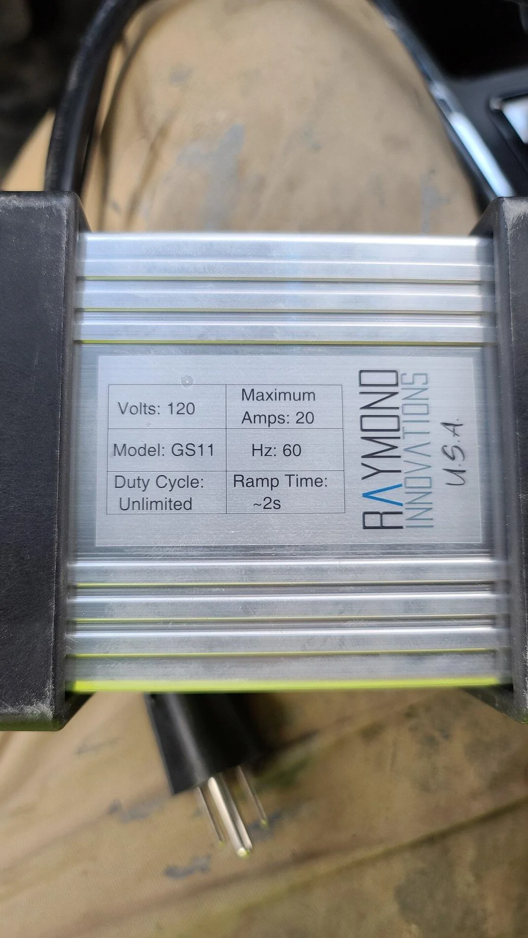

There's a few of us powerboost peeps here that have found that some tools won't work without a little help. The inrush current is what causes the issue. It's not uncommon to see over 30 amps pulled while starting up a 15 amp saw. I know there was one person with the same issue as you, a skil saw wouldn't start. Mine (7.2 kWh) wouldn't run my handheld concrete core drill even though it's only rated at 12 amps.
Ford doesn't have a solution, but I've fixed my issue with a soft starter. I use it on every big current draw tool now, the smooth startup is nice, and I haven't had a breaker trip since.

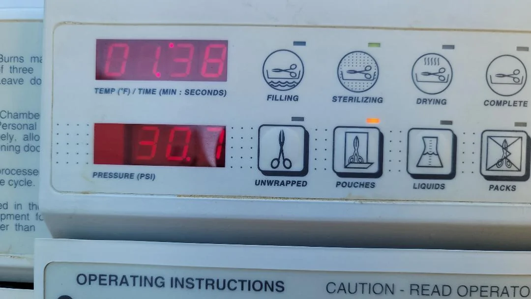

I have the Pro Power 2KW onboard and was running Table Top Sterilizers (1 at a time all day the other day) with no issues. These draw 1400-1500 watts during heat up. No issues.

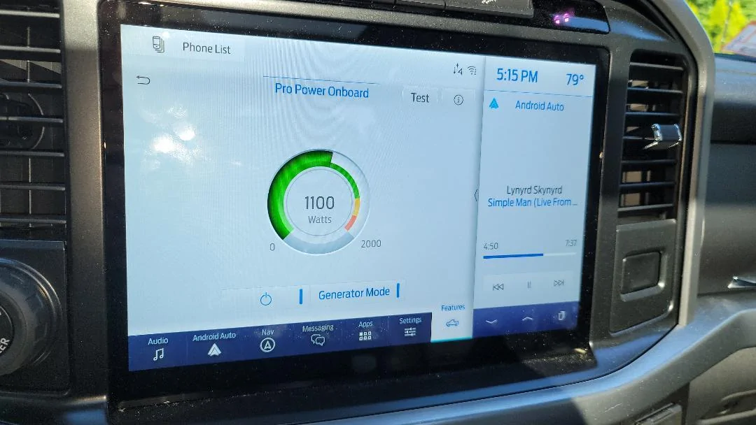

I run tabletop autoclaves on my 2K Pro Power system. This smaller one uses about 1100 to 1200 Watts. The Larger ones run 1400 + /- watts
