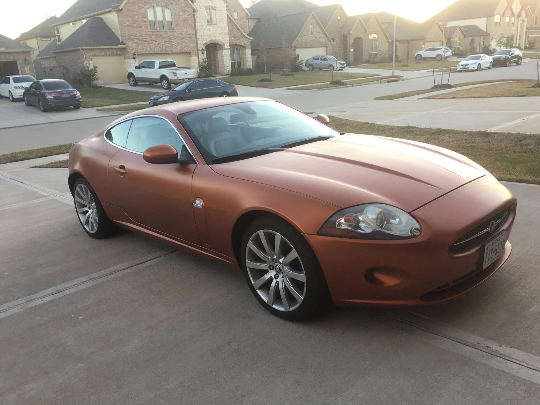

I've done multiple sets of wheels and even a few cars in peelable paint. Depending on how far you go, it can be extremely durable.
If you just want a color change and matte or satin finish is okay, then plastidip is fine. Check out dipyourcar on youtube, he has thousands of videos showing you how to do it.
If you want something extra durable, or want glossy, then check out a product called Halo EFX. it is a similar product, but it can be clear coated, which makes it glossy and much more durable. The white on my 2-tone truck is done in Halo EFX with 3 coats of cheap clear over the top, it's both glossy and much more durable and the cars I did in plastidip.
Either product will peel off easily if you get enough material on the wheels. Aim for a minimum of 7 coats. If you get the material on too thin, it will shred when you try to peel it off, and you will spend hours with xylene disolving it and washing everything. I got it too thin on the hood of my Jaguar XK when I dipped it and that was a nightmare to get off.
The truck is HALO EFX + Clear, the car is Plastidip
