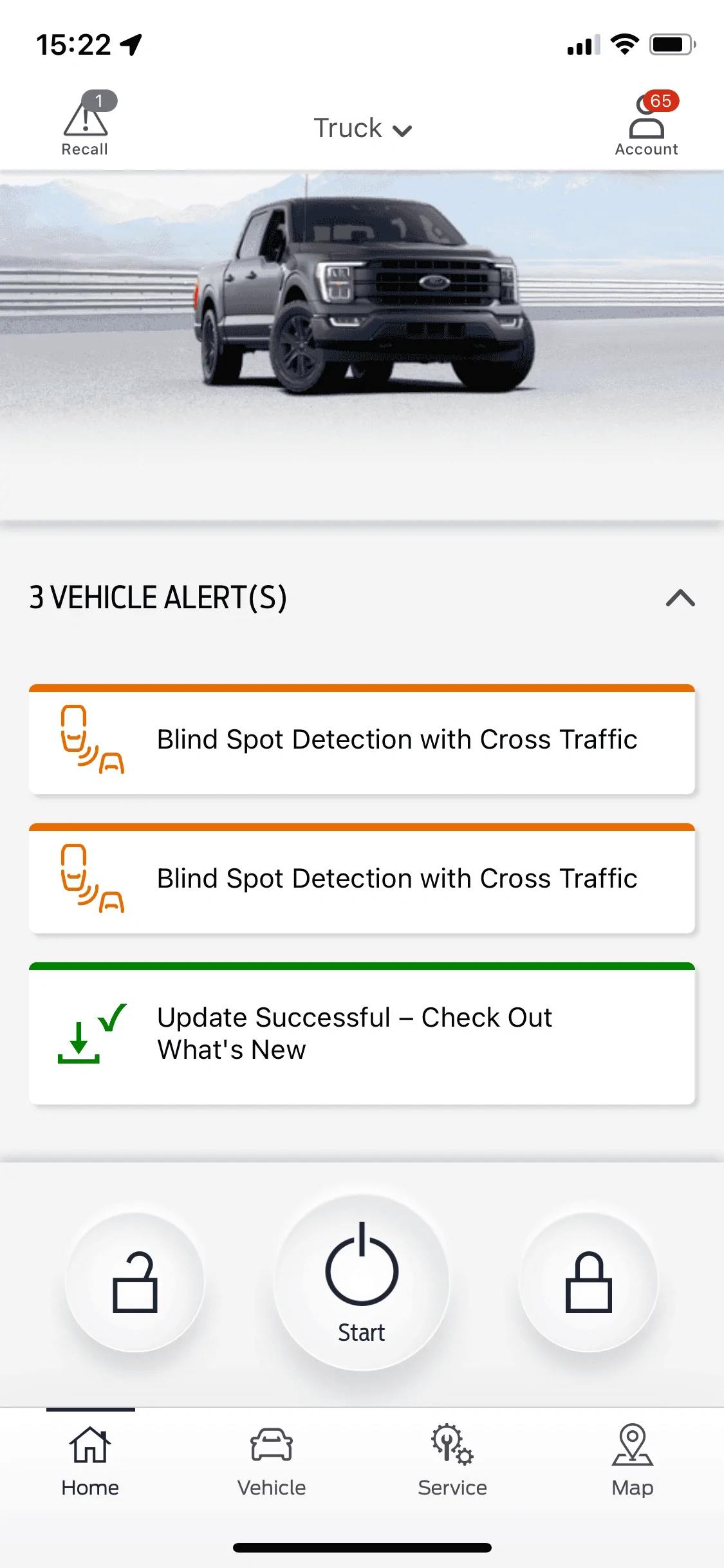

But worried about the BLIS and rear cross-traffic errors. My app shows:
Ford F-150 OTA 2.8.1 Caused BLIS Error 51983819-BDCD-4F21-831D-C51BBF79F528
Ford F-150 OTA 2.8.1 Caused BLIS Error 79E2FC8F-C9A5-45D6-9902-712845C06C1E
Ford F-150 OTA 2.8.1 Caused BLIS Error C08D1C84-6542-49C1-9E33-A45BC9016636
Has anybody else seen these problems? is my 2.8.1 different than anybody else’s? Please tell me that I can do something besides go back to my clueless dealer.

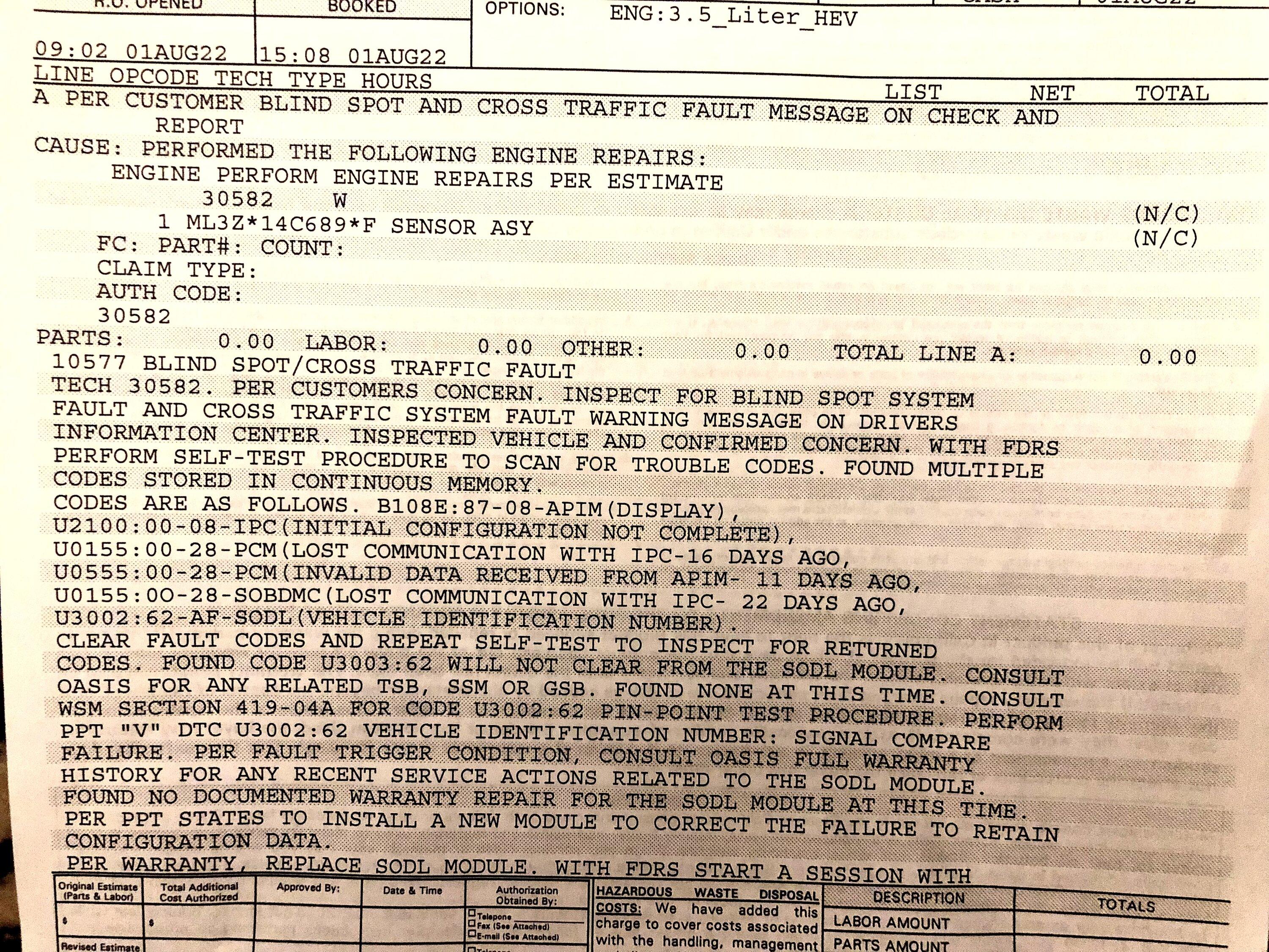

@BascoNate22 I just got my truck back from the dealership today. They fixed the dash warnings. They said I needed a sensor assembly
Ford F-150 OTA 2.8.1 Caused BLIS Error 092BF6DF-080E-4A52-87AE-D51EFB178FF2
. I find it hard to believe that that part would have failed at the exact time of getting that update but I guess it could be.
