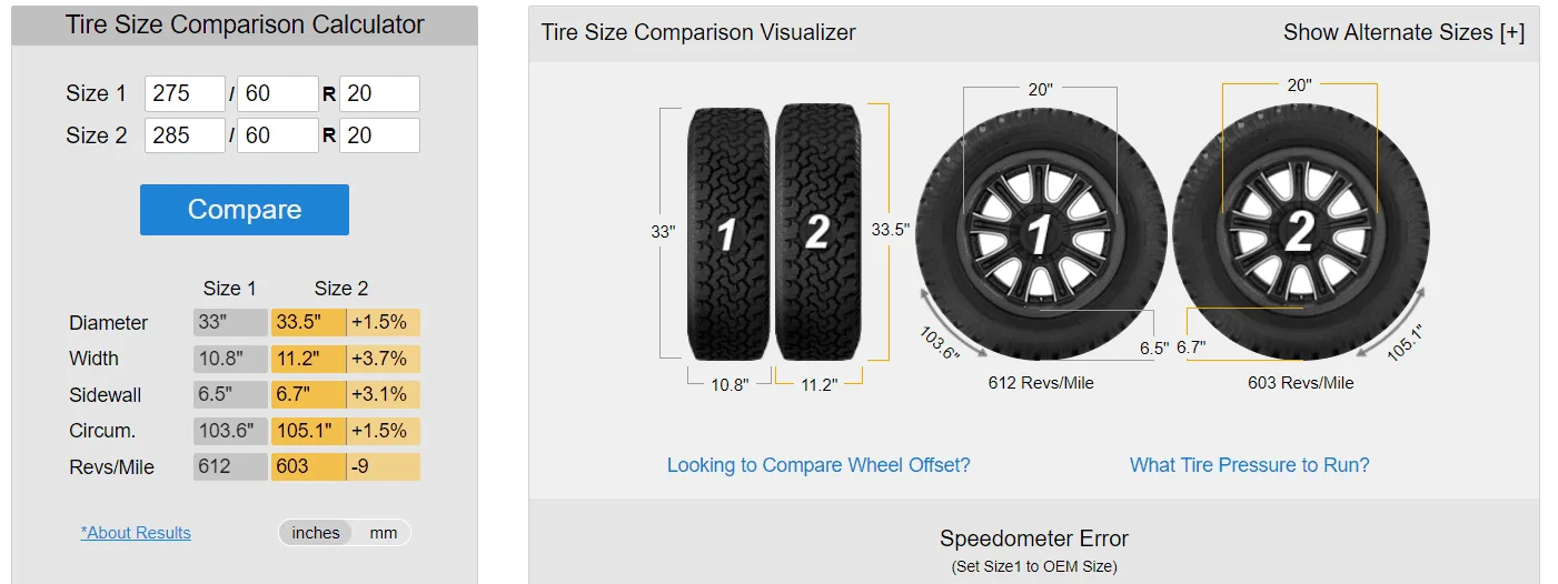

I'm running XD Rims with 275/60/20 33 1/4 tall M/T Road One Calvary. It my 3 set on my last 4 Trucks. They are Great tires low noise and ride great. and they Pull . Don't break the bank. They do have a A/T Tire we are getting ready to put on my sons truck. Check them out eBay they have a good selection.
