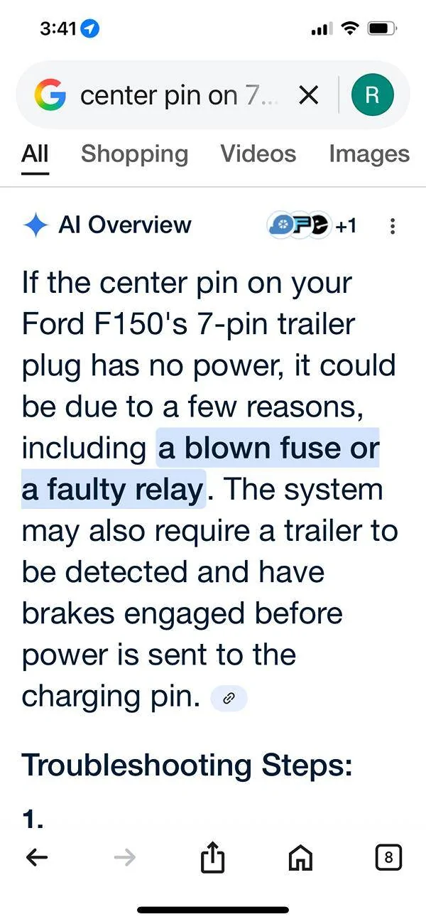

Need to make sure your center pin has 12 volts. Have read other post where the center pin had no power due to missing fuse.
Looks like that’s the pin the use for wiring Jack.

Multiple use pin. My co worker had this is on a 2020 no power on pin
Ford F-150 Non-functional powered tongue jack when connected to my 2019 F-150 IMG_5357
