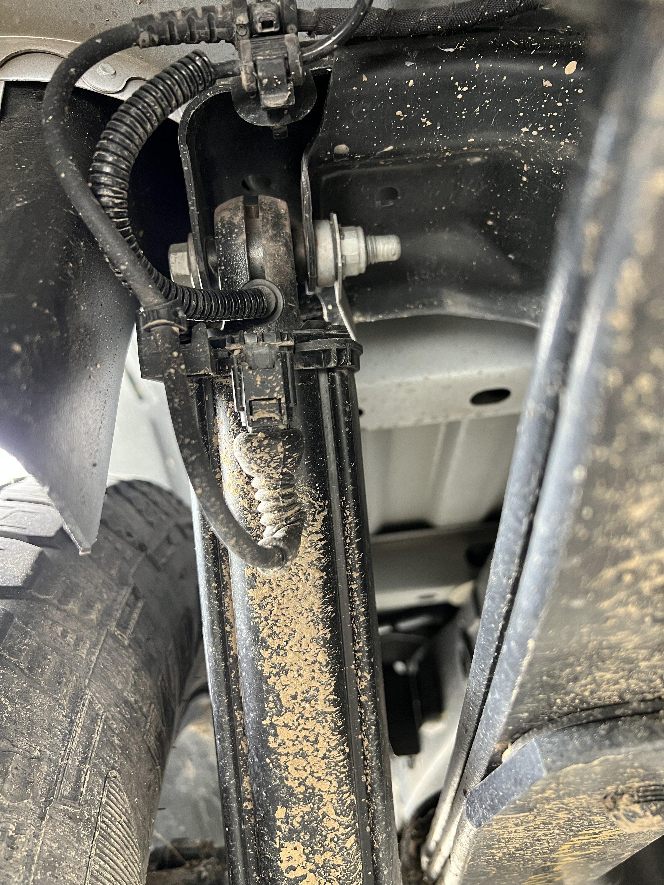

When I ordered my 2022, I could choose scales and not be forced into CCD.
But if I chose CCD, I was forced to get scales and could not get FX4 package.
I wanted CCD bad. :)
So I have a 157" KingRanch Powerboost CCD/Scales and happy to have it.
It seems strange to have CCD rear shocks and not have scales since the height sensors for CCD are integral. Does your CCD rear shocks look different?
I have the same shocks. I wonder if the scales software can be added?
