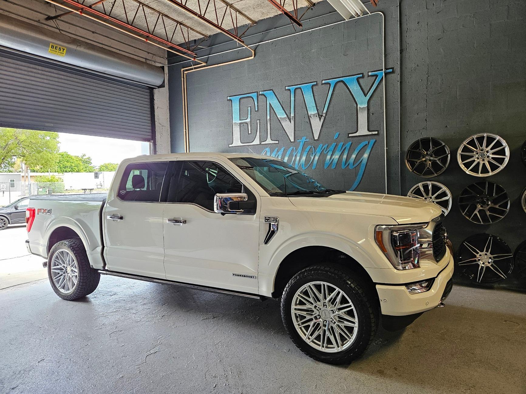

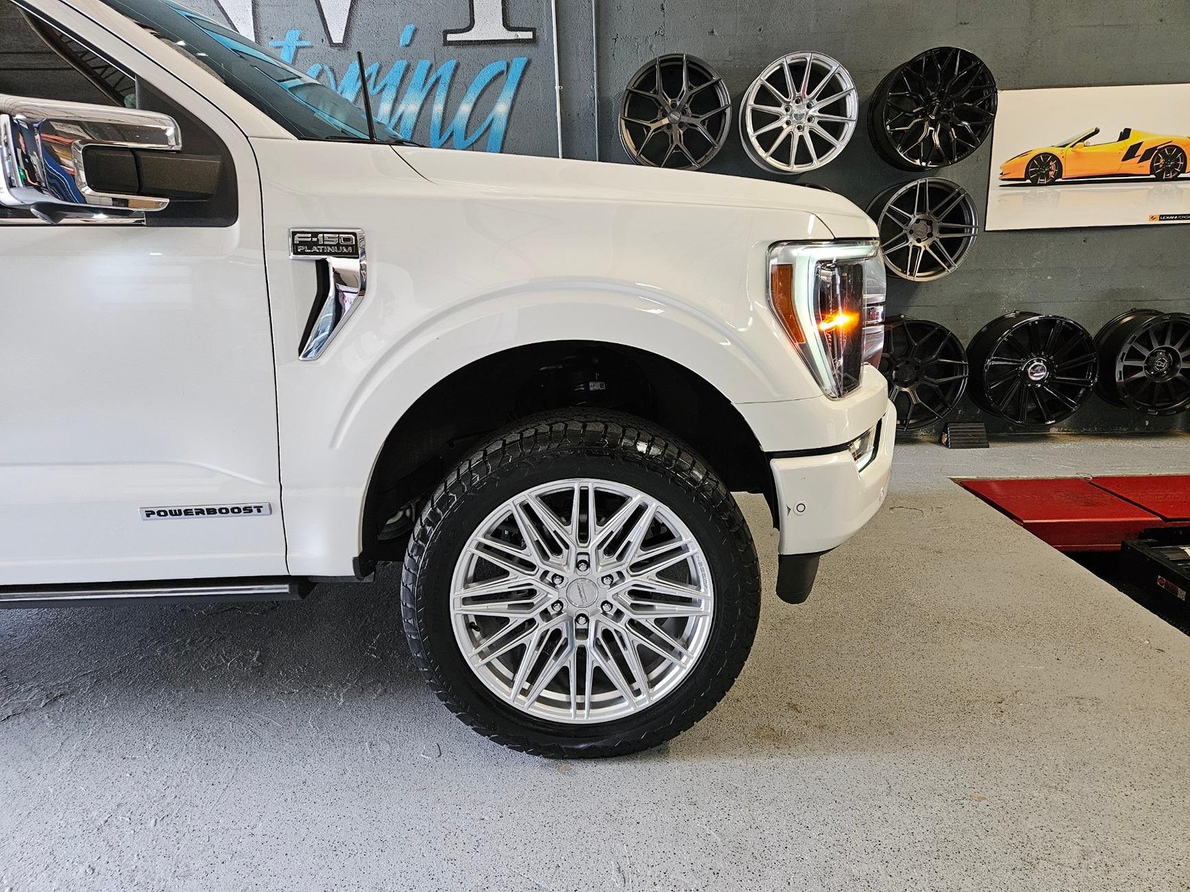

Hi All,
Yesterday I had a level kit, new rims, and tires installed on the F150. I wanted to share my combo in efforts that it helps others when making a new shoes decision. The setup I went with requires no cutting and has zero rubbing.
Wheels - Vossen HF6-5 22x10
Tires - 305/45 r22 AT
Level - Ready Lift 2.25
Installation: ENVY MOTORING in Ft Lauderdale Fl
IMO the truck rides better then stock.

Truck looks good mate , even though i personally am not a big wheel guy myself but shes nice mate!. What is the offset of the rims as they will also be helpful.

Thank you!
I apologize, but I can't provide the details of the offset it was done by VOSSEN in conjunction with ENVY Motoring. I was very particular of the fitment - no rubbing, no cutting, max 1" poke.

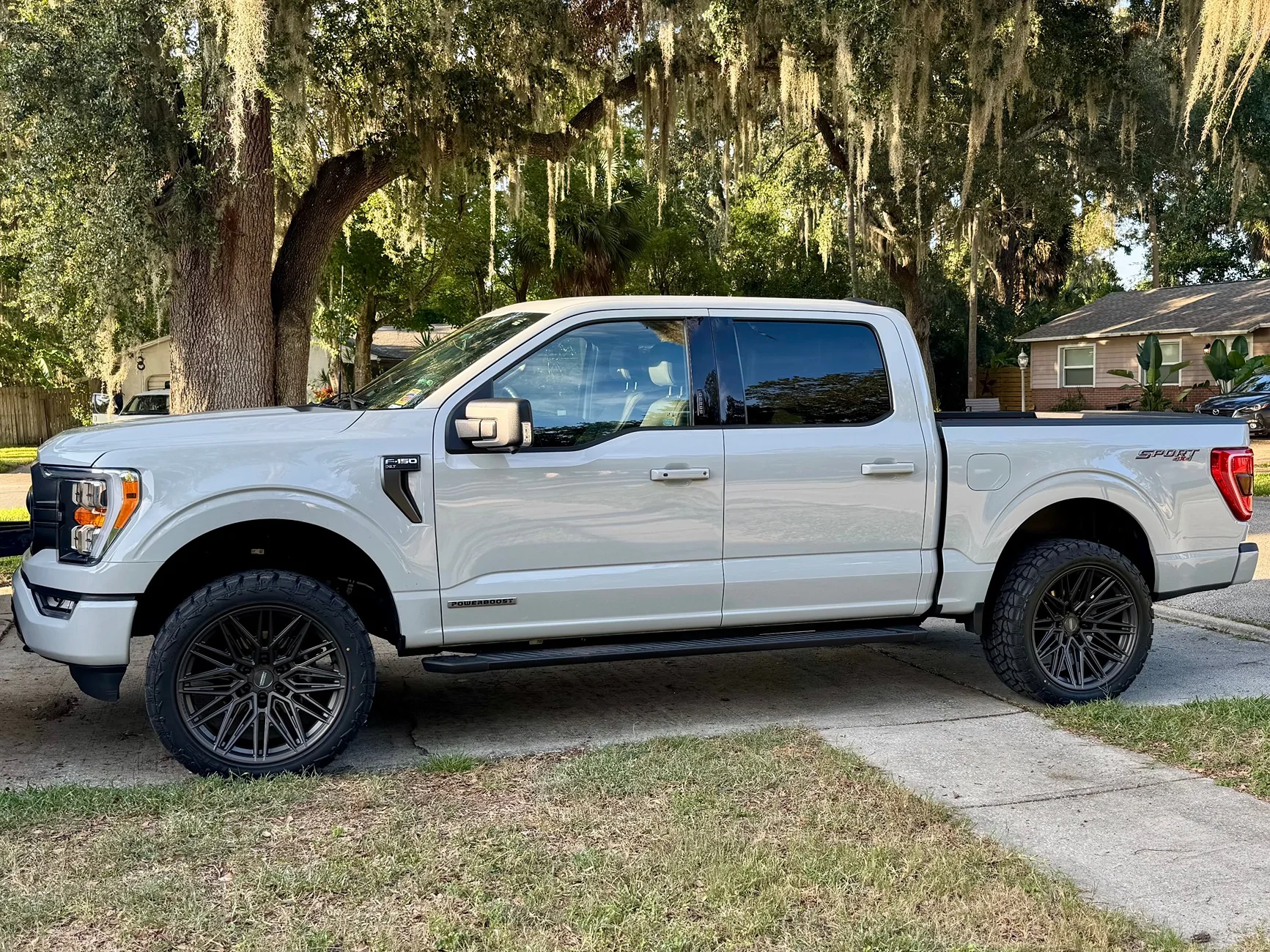

I’m also curious of the offset. I have the same setup and my tires rubbed bumper and inner fender badly.

Yeah. That’s what I have. He must have got a custom offset. I shimmed the bumper out a bit and trimmed the frame rail attachment behind bumper. All good now.
