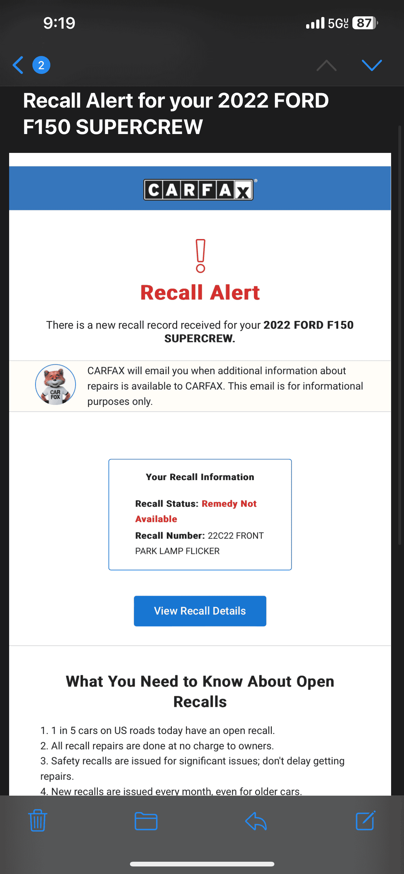

Did anybody receive this notification recently?
Ford F-150 New recall: Front Park Lamp Flicker (NHTSA # 22V686) 53EEBA04-0CE9-4D3A-BEBB-6DC2A0B86D75

thats for some of the headlights from certain months in 2022 i believe. They flicker

No flicker recall for mine. Build date 1/12/22.
https://static.nhtsa.gov/odi/rcl/2022/RCLRPT-22V686-3271.PDF
Vehicles may exhibit a park lamp flickering that does not meet the steady burning requirement of FMVSS 108.
2022-2022 Ford F150
Production Dates : MAR 11, 2022 - JUL 23, 2022
77,804 F150 vehicles are affected.
Description of the Defect : Parking lamp flickering may occur during any of the three following scenarios.
1: When the customer manually selects the “position lamp on” mode.
2: When the customer manually selects “Headlamp On” Mode.
3: When the customer is driving in automatic headlamp mode, and the environment gets dark enough to trigger “Night Mode”, which turns on the headlamp and parking lamp function.
The frequency of operation of the LED driver module is currently 200Hz. At 200Hz, the lamp is susceptible to flickering due to insufficient capacitance on the capacitor when operating between 2.95 and 3.14 volts and the lamp has LED string voltage greater than 12.5 volts.
The remedy component is an LED driver module (NC5A-13B626-FB) with updated software. The software update increases the frequency of operation of the LED driver module from 200Hz to 400Hz. The lamp is susceptible to flickering due to insufficient capacitance at the 200 Hz voltage on the capacitor when operating between 2.95 and 3.14 volts and a lamp with LED string voltage greater than 12.5 volts. Increasing the frequency of operation to 400HZ reduces the required capacitance more than 50%. This allows the lamp to operate without flickering.
