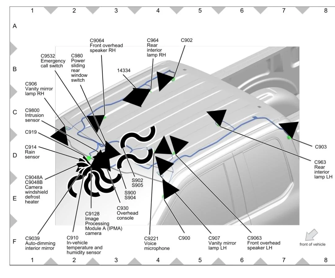

Not sure what's behind the speaker-looking portion, but the little round black thing is the interior motion sensor for the alarm. I thought that was a forced delete on 23s, but maybe the sensor itself is still there.

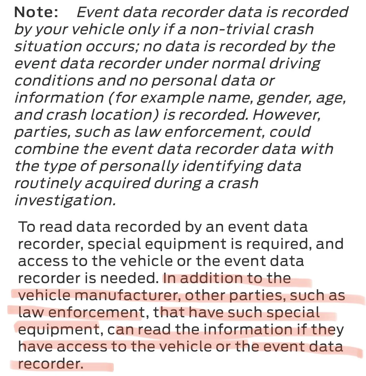

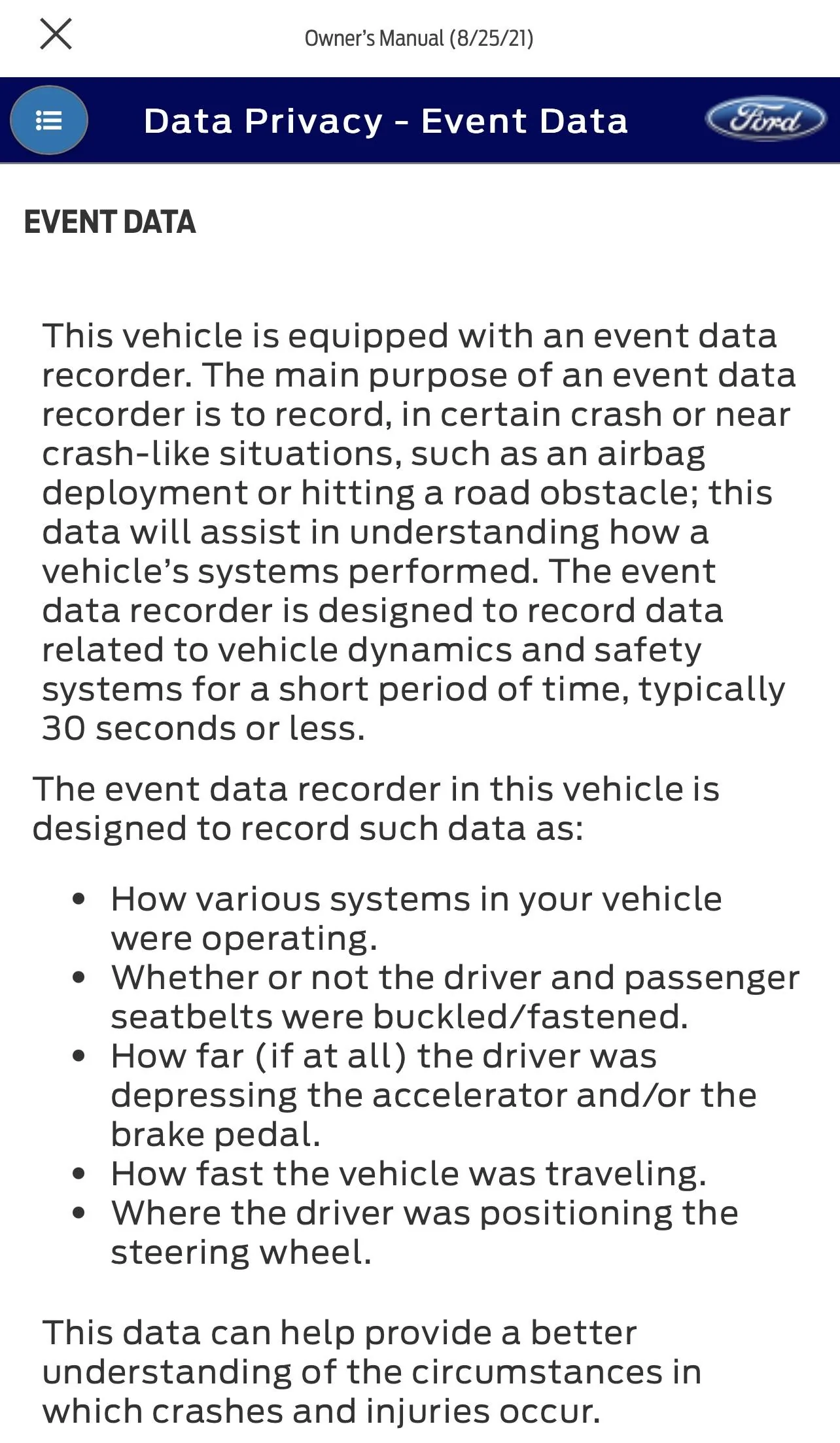

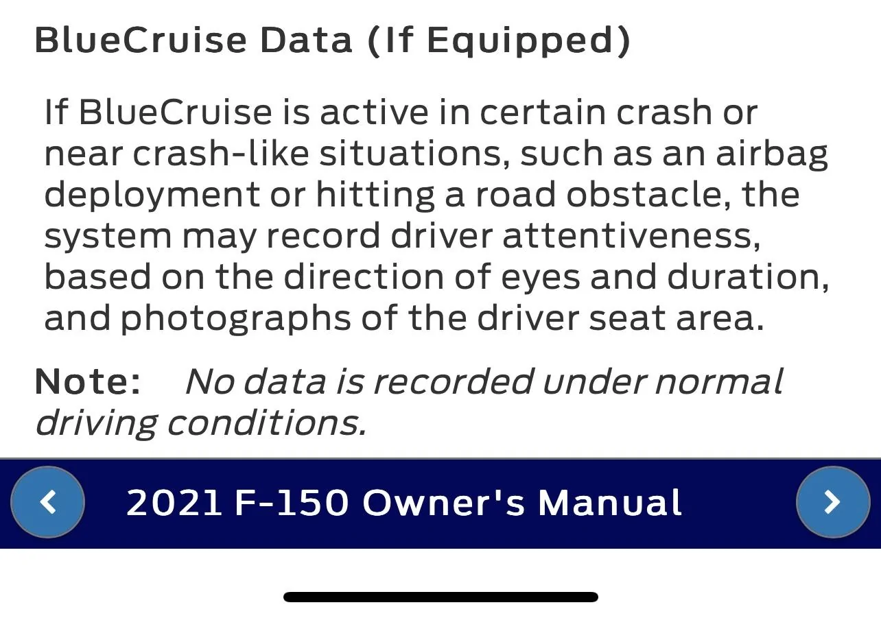

Yeah, go to the data And privacy section. I attached the parts about the “event data recorder”

It's not a camera that records images though right? Is it just for the blue cruise?

The little thing by the rear view mirror does not record images from my understanding. At first I thought it did but then I found out it’s just the cameras in the high end trim models with blue cruise that have cameras inside the cabin. Or at least I think, correct me if I’m wrong

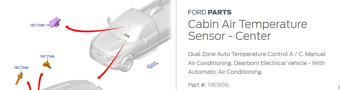

It's not a button or a calibration thingy...it's your internal air temp sensor.
Interesting. Correct me if I'm wrong, but doesn't that part image show the climate sensor (up top, normally behind the 'grille' on the console) and the intrusion detector (round black thing on bottom)? Either way, the interior temp sensor being just opposite the windshield explains the auto climate acting erratic at times with temp settings. I would have expected that sensor to be located down near the lower dash area, away from sunlight.
EDIT: Maybe they put it up there to keep some distance from the HVAC vents?
