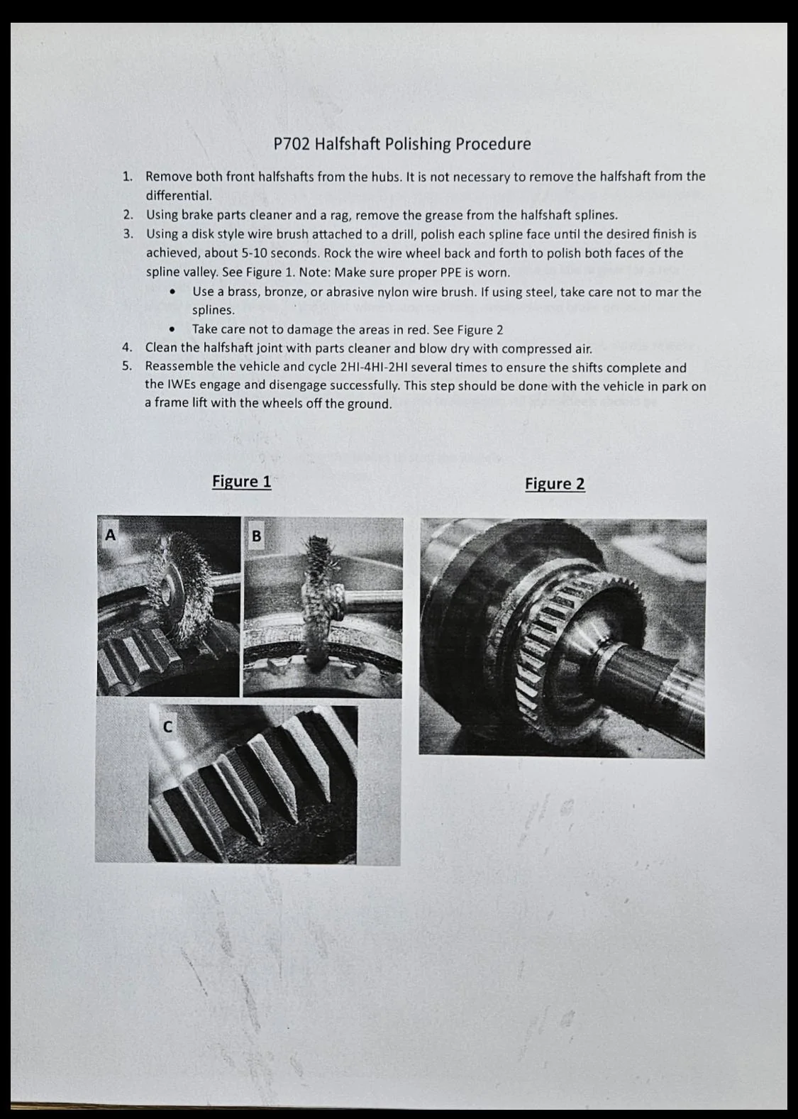

They are now Electric (EIWE).. had the issue with a 2013.. my 22 tremor is doing the same thing. Lots of people reporting similar problems.. seems issue is more prominent in colder weather. Conflicting reports that replacing Hubs/Actuators work and don’t work. Lot’s of dealers cannot duplicate the issue. No fix from Ford. Attaching photo from a user who claimed success.. was shared from a Ford engineer (apparently). Have not had time to try it with dealer.
Ford F-150 Need help identifying this noise, not sure if it's Powerboost specific IMG_3297
