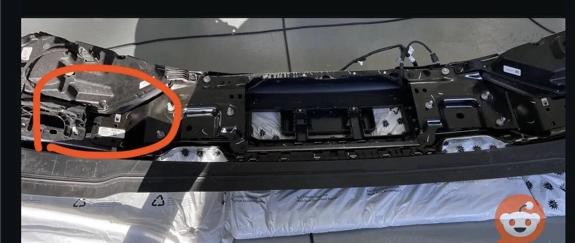

Bought a truck that had been repaired from a front collision. It’s a 2023 lariat powerboost with the 502a package.
I’m needing help figuring out what I’m missing.

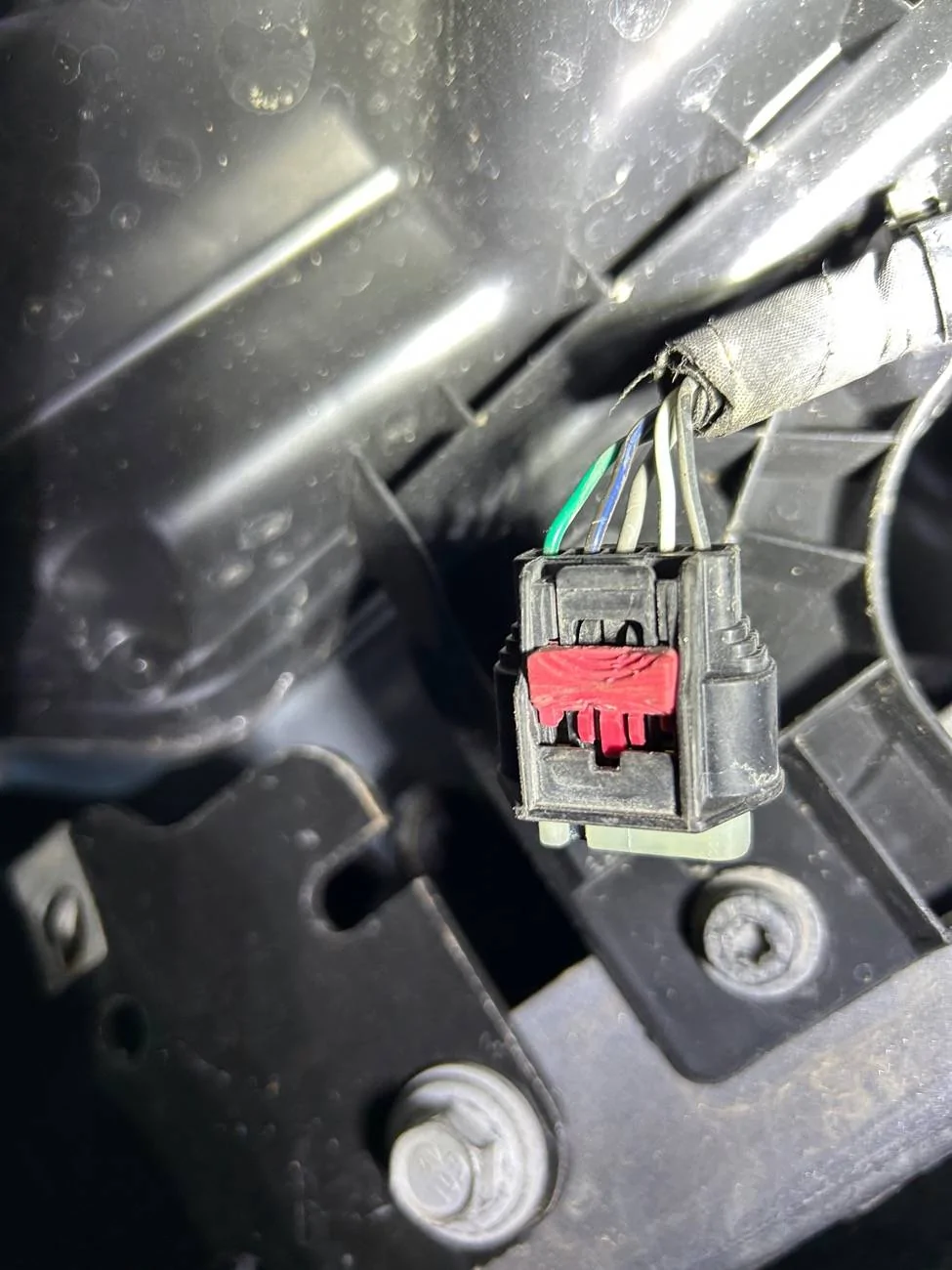

Borrowed picture has red highlighted is of the front bumper assembly. Where I have circled on both sides it looks to have two sensors missing. The passenger side connector has 5 wires black/wht, white, grey, black/blue, green.. The driver side has two wires I will confirm the colors here shortly.
Added other pictures of location and wires.

Active air dam is missing. You can read about it here. Several people remove them once they break/fail.

Makes sense, I appreciate the reply!

you may have to become Sherlock Holmes to solve everything that is missing. Find another 2023 PB and take pictures. My son has the same model as you but I won't see him for another month. I can tell from your picture that the speaker hanging down looks not to be installed. It's the one that generate the back-up peeps. My 2024 has it up by the radiator and not easy to get my hands on. Seems like you have several locations that are vacant.
Can you get a hold of any parts schematics? I've taken my VIN to the parts department at my local dealer and they have shown me what parts should be on my F150. Maybe treat them to a case of their favorite beverage and they will help you after hours when they won't be holding up other customers.
