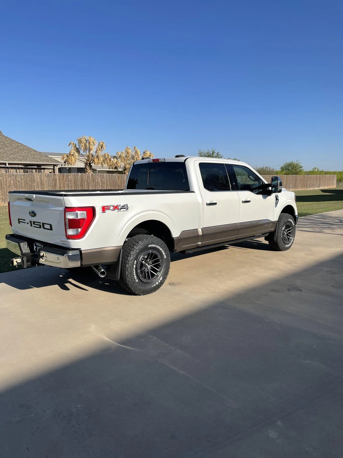

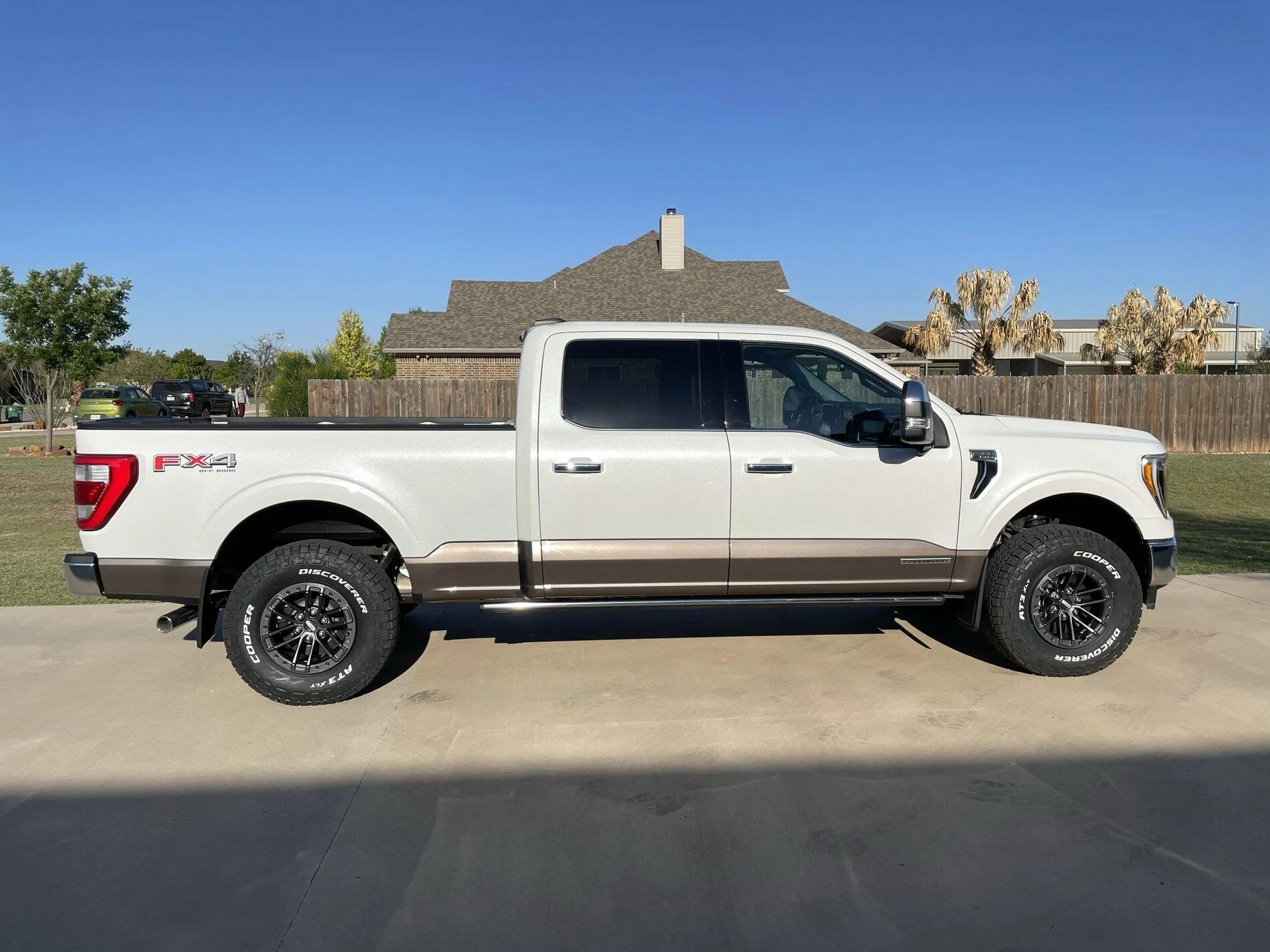

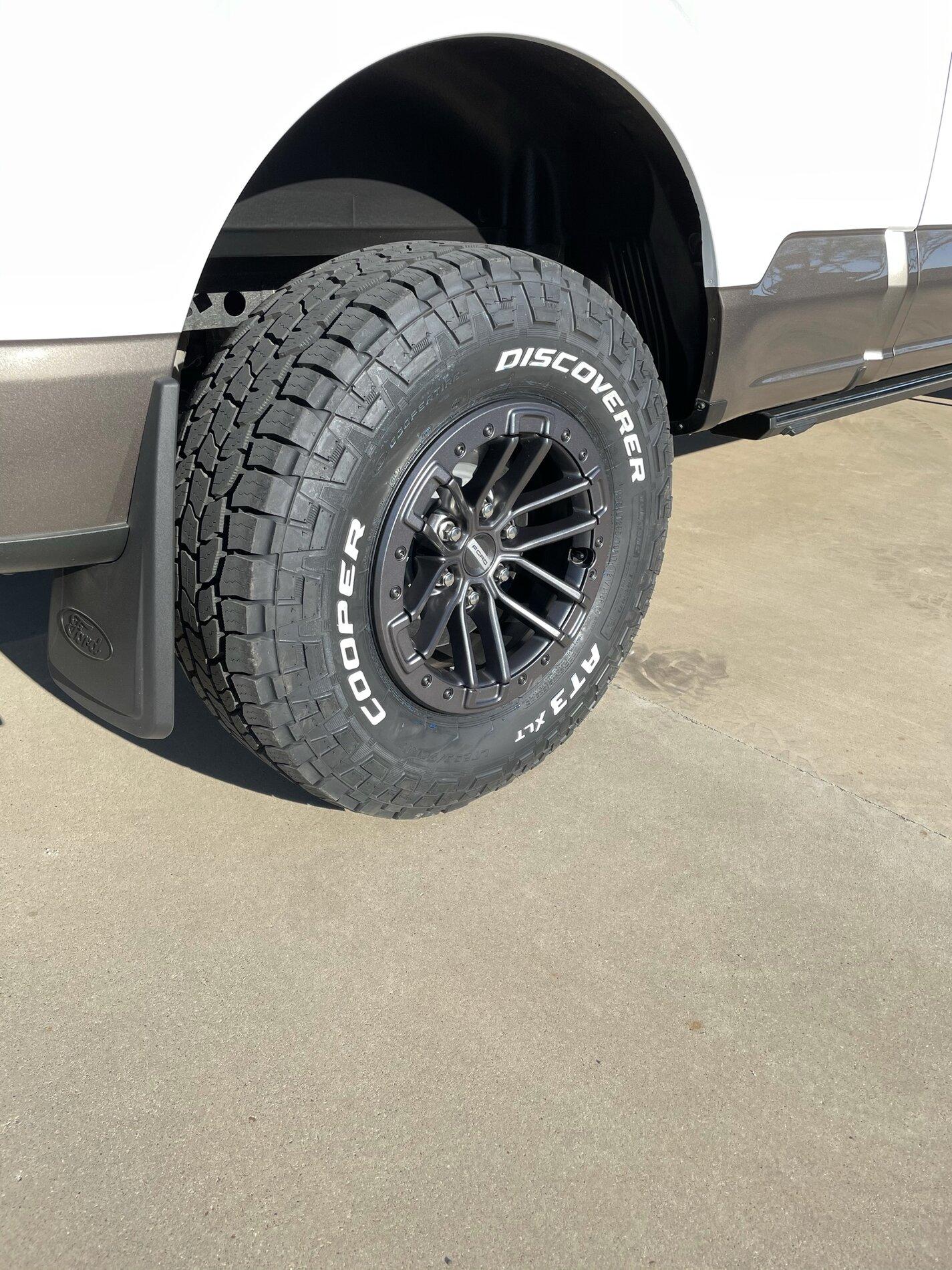

Cooper Discover AT XLTs in 295 70 17”s on 2019 Raptor headlock capable wheels 34mm offset 8.5” wide.
Truck has a 2” level but wheels and tires fit with no level with zero rubbing.
