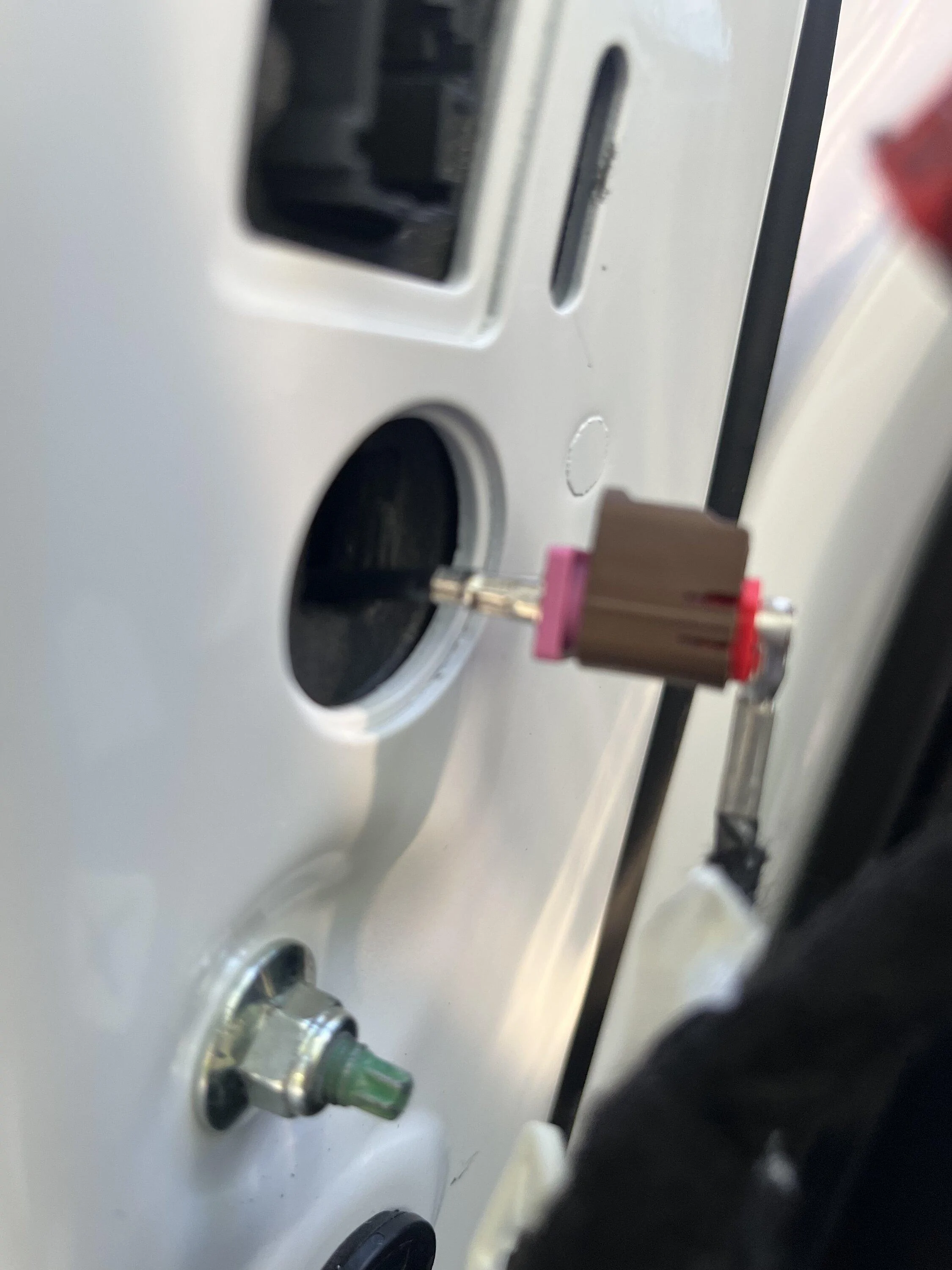

Hello I am doing a mirror swap and I purchased a mint set of power mirrors online and ones missing a cable end. Anyone know if the is can be purchased ala carte? Thanks

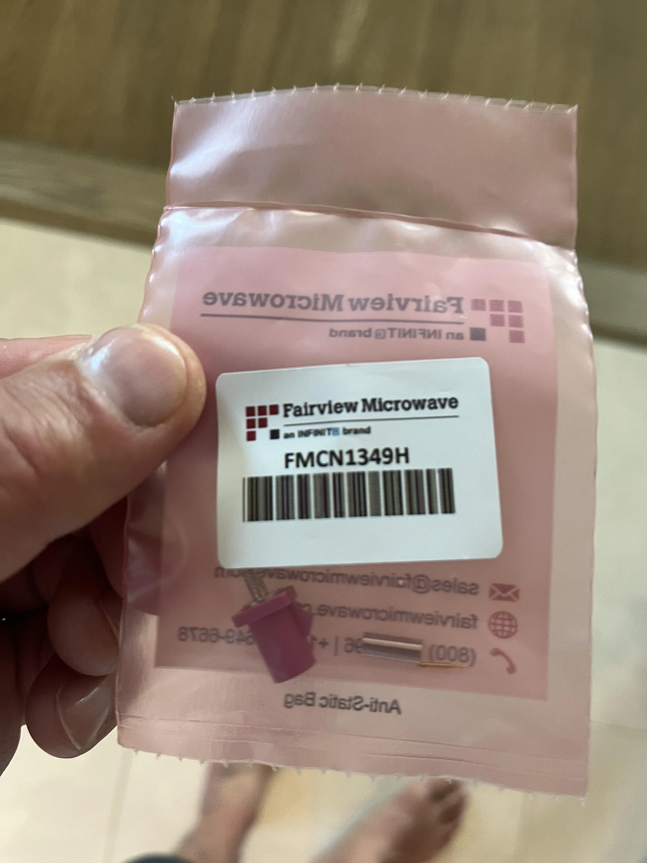

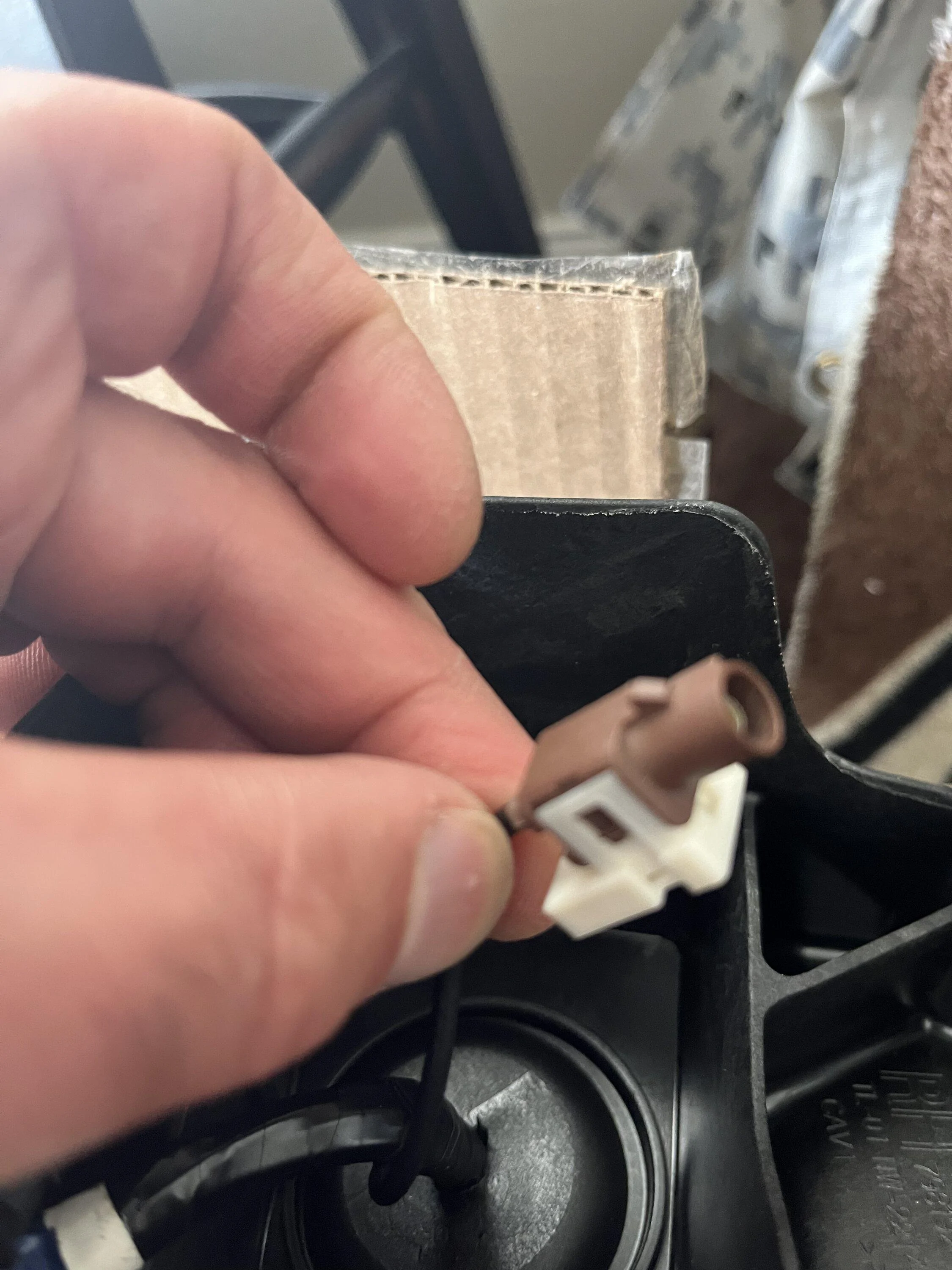

Update incase anyone else encounters this issue. I was able to purchase a replacement end from a microwave company for 12 bucks. I got a crimping tool on Amazon and i was able to repair the missing end and it is functional.

It looks like you're having to go with that end not being anchored to the mirror. I'm close to giving up on trying to find a "factory" replacement for that specific coax inside the mirror and was assuming I'd have to leave a loose end as well. I'm curious if you happen to recall how the original one was anchored... My mirror has the hole through the weather seal for the coax but the only thing on the other side is a thin metal bar running perpendicular to the mirror body... Doesn't appear ready (or even capable) of properly anchoring a connector to.
Regardless, thank you for sharing the Fairview cable end pic above!!!
