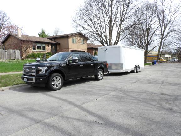

Happy to offer up my experience. I have a Featherlite 20' 4916 enclosed aluminum trailer (7" inside, GVWR 9600#, 16" load range E tires, 4.8k# axles). It weighed 3200# empty including spare tire. The car weighs 3550# and in total the trailer with spare tires, tools, built in cabinets, winch, compressor, generator, 55 qt cooler, etc including the car total weight is 8400#.
The aluminum trailer is only marginally lighter but will last forever and will not rust. Steel trailers are inexpensive but depreciate quickly due to rust.
Here are the important parts (2)
1. You need a weight distribution hitch. I got an Equalizer 12000 hitch to match the truck.
https://www.amazon.com/Equal-i-zer-4-point-90-00-1201-Distribution-Included/dp/B004TR8PU2/ref=sr_1_3?crid=2XNU0W9NS4FAU&dchild=1&keywords=equalizer+hitch&qid=1607970700&sprefix=equalizer+hit,aps,181&sr=8-3
You will need a shank to match your hitch (Class III or IV)
2. Invest the money in trailer tire pressure monitors. Trailer tires need to start at 80 PSI for my trailer and the TPM has been very useful in detecting slow leaks, etc.
I think you will be ok. My 2017 has the max tow package good for 12300, I never got close.
