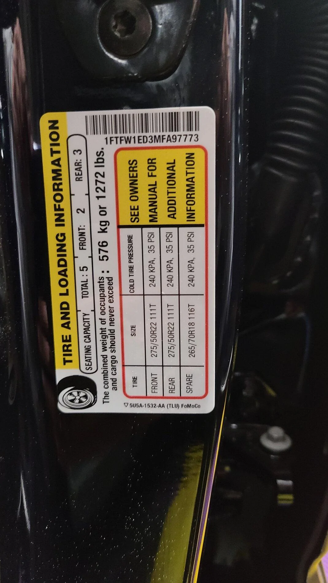

FYI here is the sticker from my limited. It's a Powerboost 4x4. Options are max recline,work surface, spray in liner and hard tonneau cover.
This is extremely helpful, thanks. I'm going to stick with the 23' airstream that has a loaded pin weight of 467 lbs. With me and the fam in the truck (w/ luggage in the trailer) we will be right at 85% payload ish. My truck is in build limbo right now so I wont know for sure until I get it.
Wow. That’s really better than I would have thought. Not bad at all comparatively speaking.
