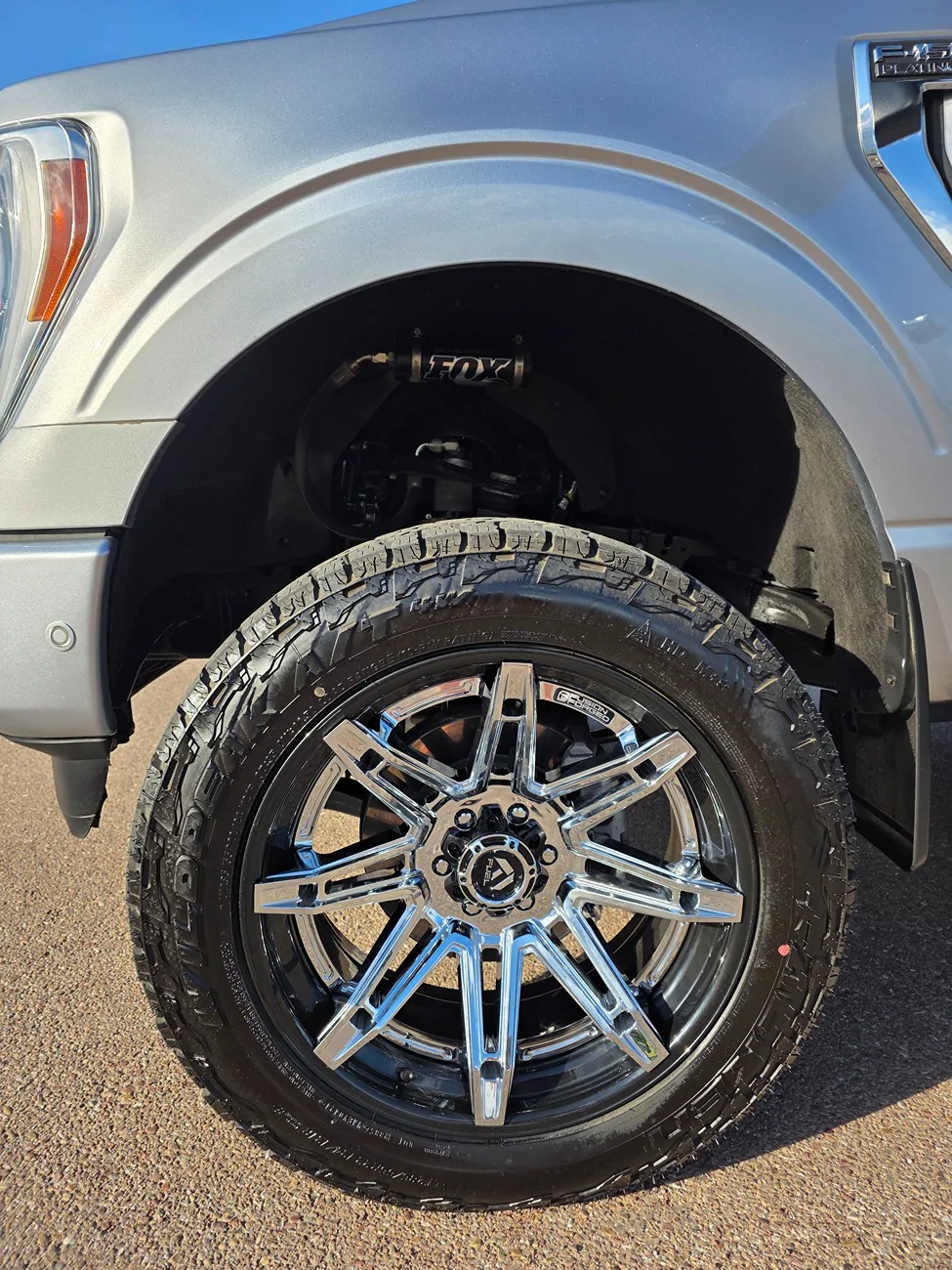

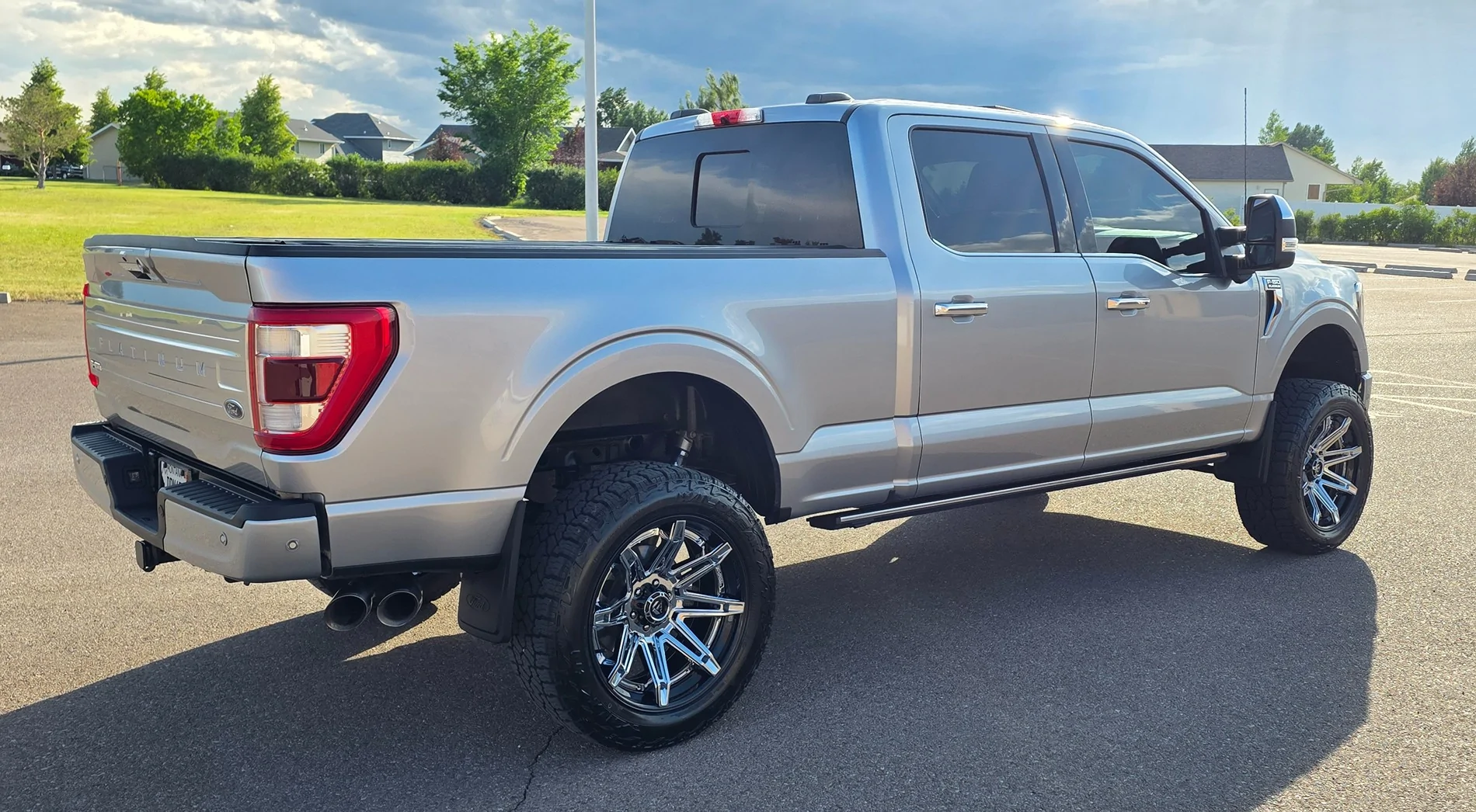

Here's my 2021 with BDS 6" lift, 22x10 -18mm wheels and 285/55R22 (34.6") tires. Zero rubbing and no cutting aside from trimming the corners of the air dam.
