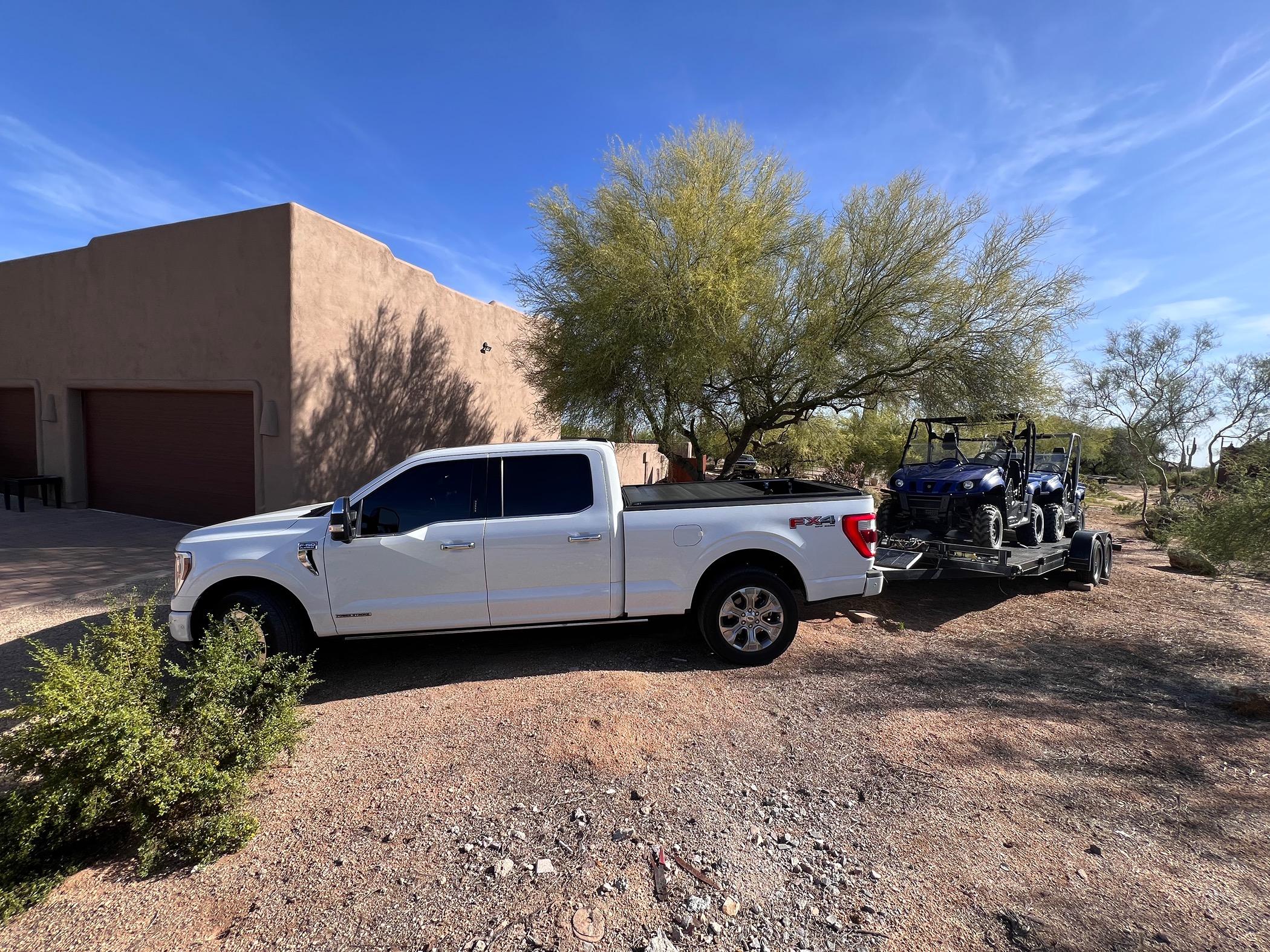

This is my truck pulling a trailer of 2 ATV Rhinos.
Ford F-150 Leveling Kits:  Bilstein's 5100 or Eibach's Pro Stage 2/R? IMG_1423
