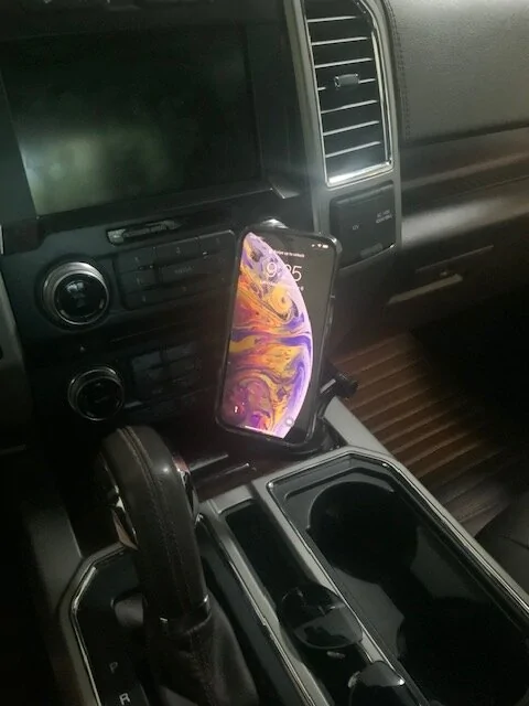

Here's my setup. I have an iPhone 12 Pro Max (i.e. the largest and heaviest) and it stays put (and I don't drive like a g'ma, just ask my wife).
This is in my 2015 (still waiting on 2021!). I have the suction base sitting on the cover panel for the space behind the shifter/cupholders and the power wire into the power connection inside that space.
It's a MagSafe Charger (15 Watts) with good magnets. Then also a MagSafe case (it repeats the magnets in the phone, in the case, so it is a strong as using phone without the case, for magnetic attachment.
Phone Case: https://smile.amazon.com/gp/product/B08NFDS7Z5/ref=ppx_yo_dt_b_asin_title_o09_s00?ie=UTF8&psc=1
Charger: https://smile.amazon.com/gp/product/B08Q3LV881/ref=ppx_yo_dt_b_asin_title_o07_s00?ie=UTF8&psc=1
