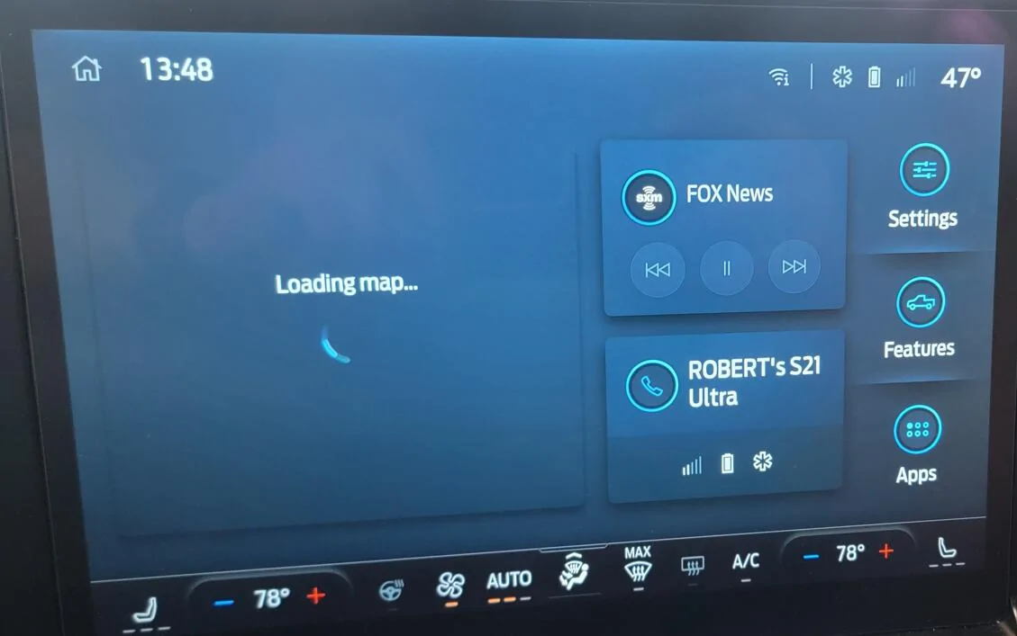

I am looking for pictures of what the HVAC controls look like on the screen when added using Forscan. I would like to do this mod to my 2025 Lariat, but would like to see what it looks like first. TIA

I added them to my '21 several years ago. Had to enable the 'Unreal' Sync theme, then added the climate bar at the bottom, then added the heated steering wheel to the climate bar, and then added the heated/cooled seats to the climate bar.
Ford F-150 HVAC Controls on screen 1740509577808-8g

Thanks roadPilot. I thought there might be a tab just like Nav, Audio etc. Are you able to activate the different settings and temps by touching the individual icons?

Yes. The screen controls were actually added when they started removing hard buttons from the vehicle.
