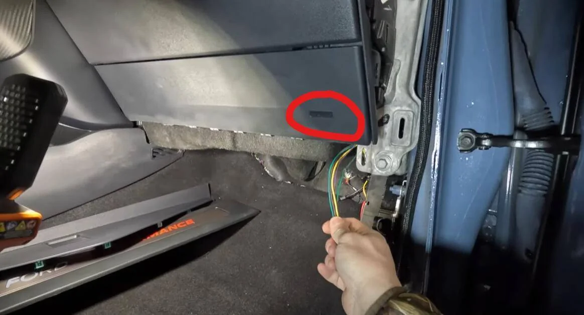

In this video I show how to install and run all the necessary wiring for the MPower ORV light on my Raptor. I've had my eye on this light for a while so finally pulled the triggers. I also show where and how to use the pass through wires in the passenger footwell so you can use the AUX switches to connected the ORV light.
Some wiring notes for the lights themselves. You can select amber STEADY or FLASH based on which wire lead you use at the MPower bezel. You select what color the light is based on which main power wire you hook to you switch lead. If you hook up RED, the lights will be AMBER. If you hook up GREEN, the lights will be WHITE. Only AMBER has the baility to FLASH, WHITE is only steady on.
Here are the wire colors for both the switch leads under the hood and the pass through wires in the passenger side just below the glove box. In my video I used the Yellow/orange wire for the MPower lights. You HAVE to connect the hot wire under the hood to the pass through wire in order for the pass through wire to work when you flip the switch.
AUX 1 - Violet/Green (10A)
AUX 2 - Green/Brown (15A)
AUX 3 - Green/Blue (15A)
AUX 4 - Brown (10A)
AUX 5 - Blue/Orange (5A)
AUX 6 - Yellow/Orange (5A)
The wires are taped to another harness behind the lower panel. I marked where they are at with a red circle:
Hope this helps!
