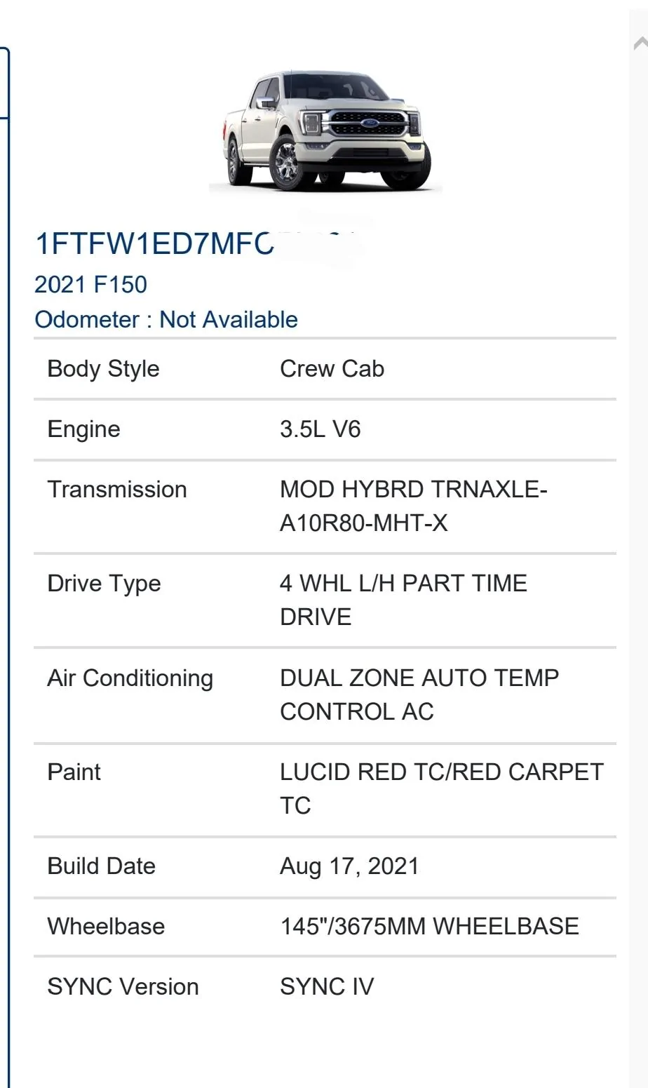

You have to have the Copilot 360 ACTIVE prep in order to be able to use Bluecruise. You may only have Copilot 360 Assist. Got a window sticker you can post?

Nice looking truck. Unfortunately, judging by the headlights this is a 501A Lariat, and I believe BlueCruise is only available as an option on 502A and up.

Here's your truck (sweet truck)

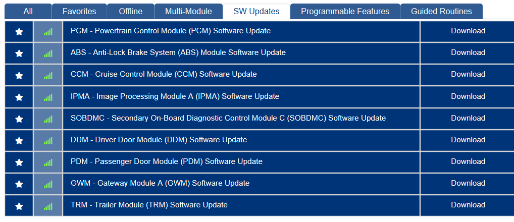

And here are all the updates that your truck is eagerly waiting for. Lol

Some of those have to be done at the dealer.
Going back to your Blue Cruise comment, you do in fact have CoPilot 2.0 Assist, which is not BlueCruise capable.
You would need CoPilot 2.0 Active (or Active Prep) for that feature.
Ford isn't clear with their naming conventions.
Just FYI, WiFi has nothing to do with OTA updates. It might sometime in the future, but currently OTA updates are only delivered trough the Telematics Control Module which is a cellular connection with the Ford cloud/server.
Ok, when your APIM module (Sync4) states no "updates available", that simply means that Ford doesn't have your VIN queued up currently to receive any of the updates that were listed in that screenshot above via OTA. But your VIN does have those updates available regardless.
To apply those updates directly, without waiting for OTA delivery, you would either have the dealership do it with FDRS (Ford Diagnostic & Repair Software) or you could purchase the ODB device and use FDRS yourself.
Or you can just wait. Perhaps someday soon Ford will have OTA working properly and all the 2021 F150's will be uptodate.
Many of us on the forum got tired of waiting and there's now a community of 2021 fellas that have enabled all the latest features and improvements to our trucks.
But for now? Enjoy your sweet new ride and take your time exploring the details behind these claims. :)

How and where do you run that report based on my VIN? just had it at the dealer so curious how many of these they completed.
Thanks to a couple of fellas on this forum, that had the dogged determination to address the OTA snafu on their trucks, many other owners decided to follow their efforts.
In short, we purchased our own Motorcraft license to the same software that the dealership uses to diagnose and repair/update the various modules onboard. The image you referred to in your question is a view of a specific VIN in that software program. (FDRS)
There's a huge thread regarding FDRS and is now the defacto "How To" for addressing these issues yourself and avoiding the dealership altogether.
