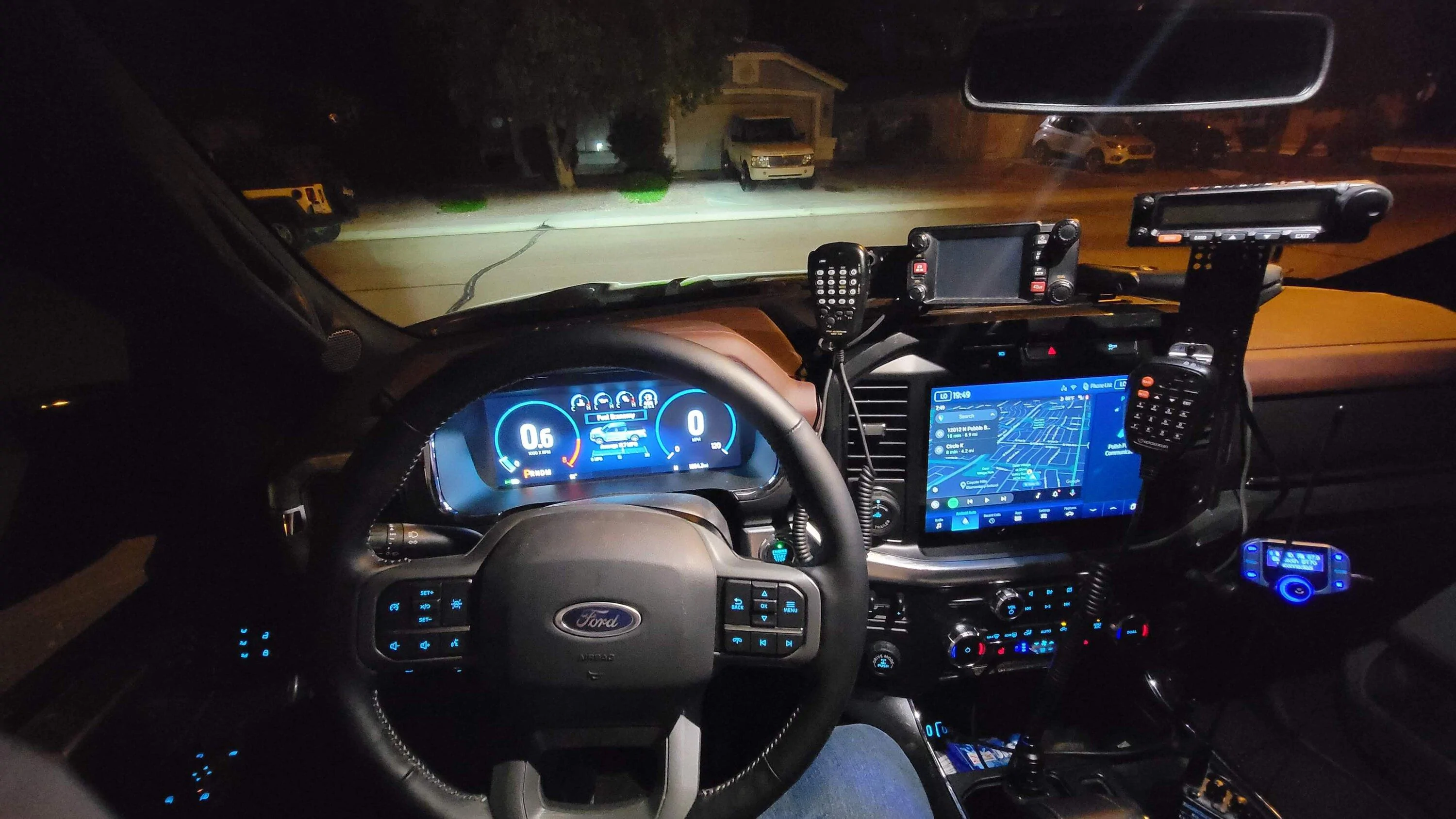

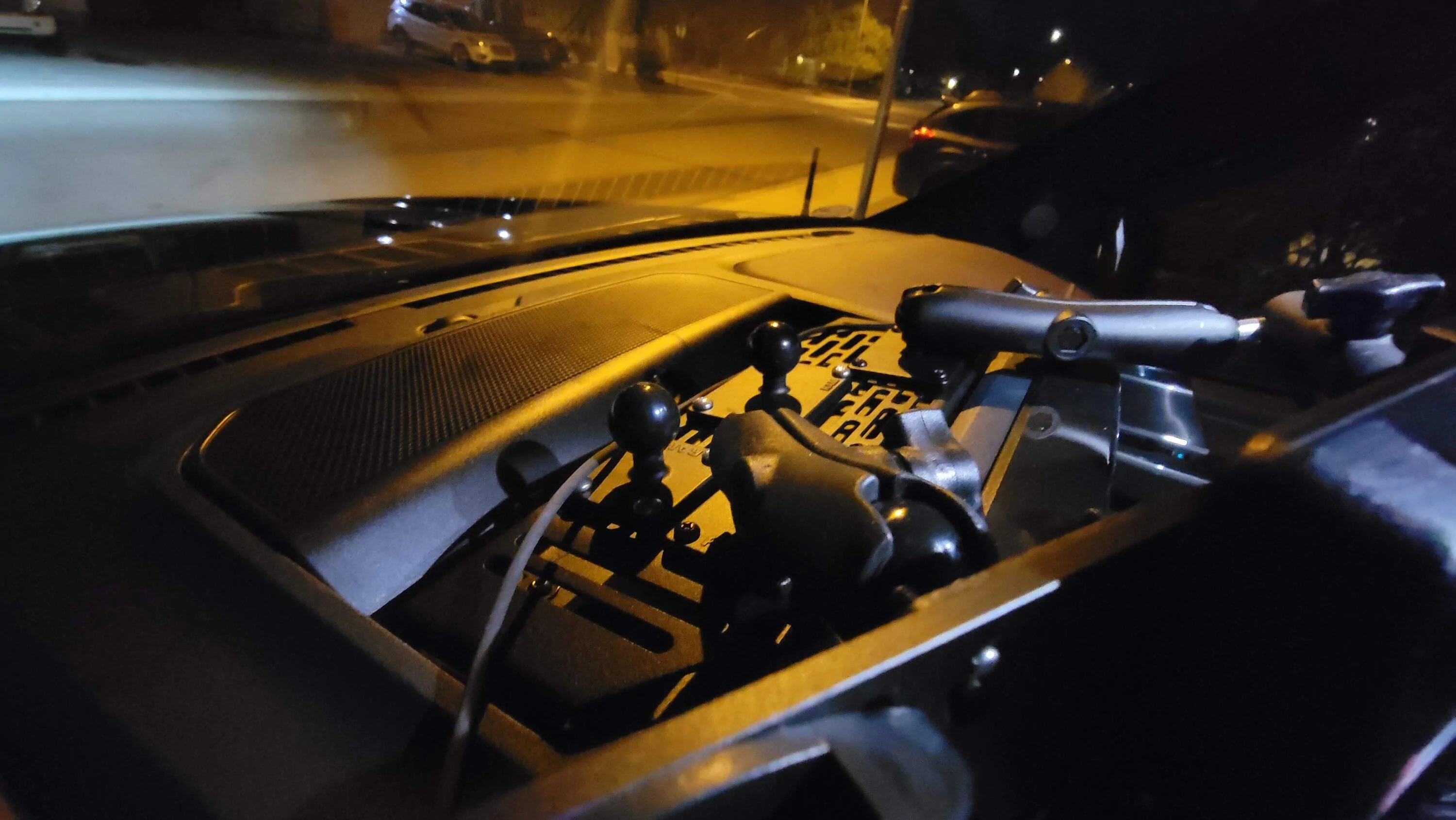

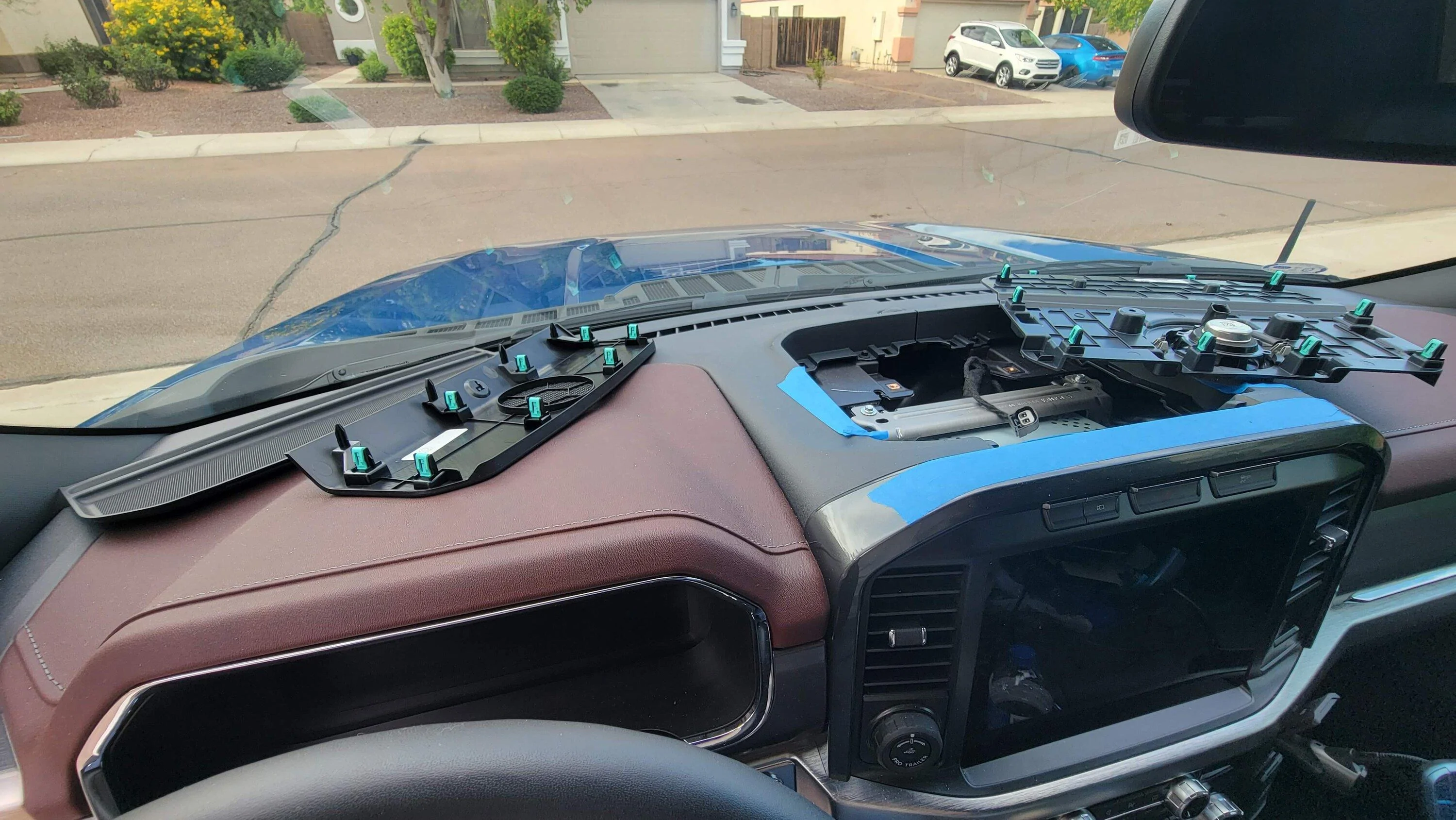

I made progress today. I got my dash mount installed today. I also put together my RAM Mounts, Lido Radio FTM-400DR bracket along with the Lido Wouxun KG-1000G mounting brackets.
Short Sturdiness Test Video Here on YouTube -
3 Minute Video of Dual Radio Install on YouTube -
Inside Truck Pics Taken Tonight:
Ford F-150 Ham & GMRS Install 20220910_162126
Ford F-150 Ham & GMRS Install 20220910_194924
Ford F-150 Ham & GMRS Install 20220910_194933
Ford F-150 Ham & GMRS Install 20220910_195523
I installed a couple extra Ram mounts in case I want to throw up a fuzzbuster or something else in the future.

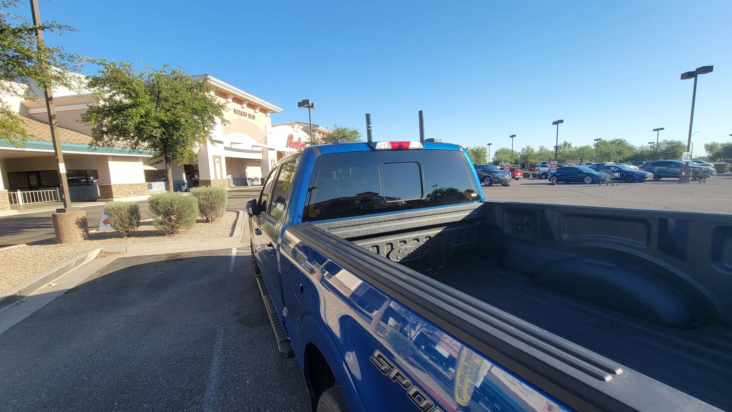

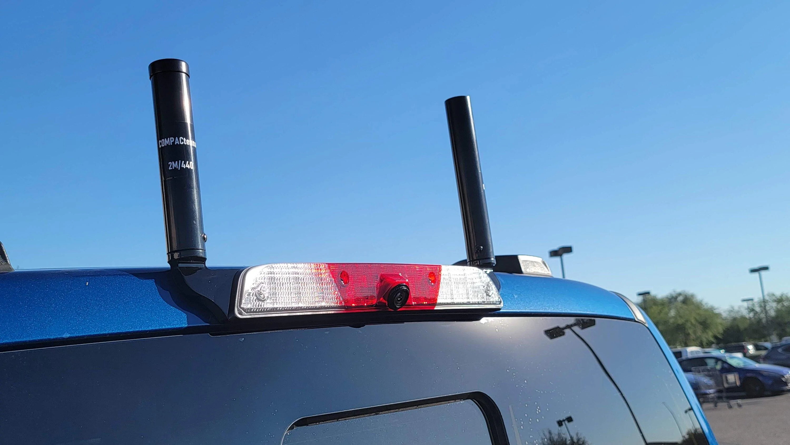

My antenna mount is from a company in Mesa, AZ called Bulletproof Diesel and they have an awesome invention here to mount your antenna(s) on your third brake light.
Antenna Mounting Pics Below ....
Ford F-150 Ham & GMRS Install 20220901_170404
Ford F-150 Ham & GMRS Install 20220901_170346
Ford F-150 Ham & GMRS Install 20220901_170322
Ford F-150 Ham & GMRS Install 20220901_170314
Antennas
I'm testing out the Compactenna Ham and GMRS antennae to start out with. I've tested the SWR and am not too happy with the results of the Compactenna. Although, it clearly states that best results come from mounting them on the rear corner of your roof. I contacted the inventor and he said that I should be fine using the third brake antenna mount. I've been riding around Phoenix the last couple weeks testing a little bit with my Yaesu HT. Once I get my mobiles powered on, we'll see how they work. If I get complaints about the TX quality, I'll switch back over to traditional NMO whip style antennas. RX seems to be pretty good so far with these antennas though.
