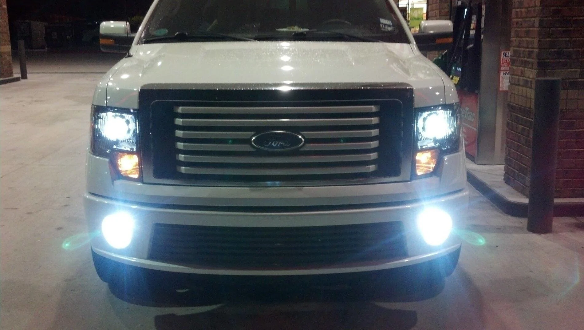

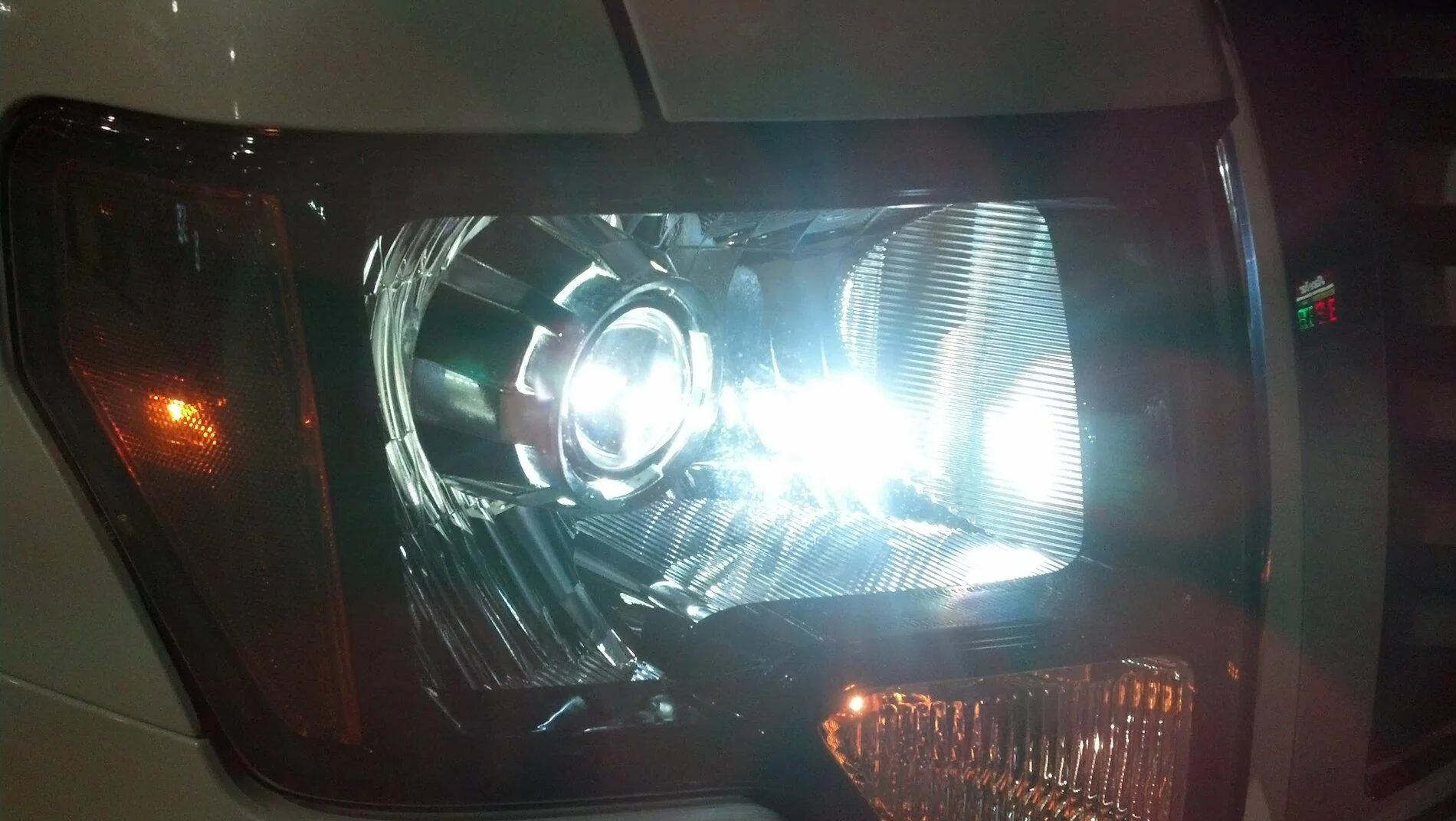

I did a custom projector setup on my 2011. The halogens sucked so bad. The Retrofit Source was awesome:
Ford F-150 Halogen vs LED OEM headlights? 13th gen owner input? 1601330053820
Ford F-150 Halogen vs LED OEM headlights? 13th gen owner input? 1601331170301

That’s why I go for a true projector setup (and proper aiming). I hate blinding other drivers, and the standard light output from most setups is lackluster. When you choose a projector pattern you can also determine width and focus. I chose a setup to make sure my pattern was extremely wide so I could see animals on those pure dark back roads.
