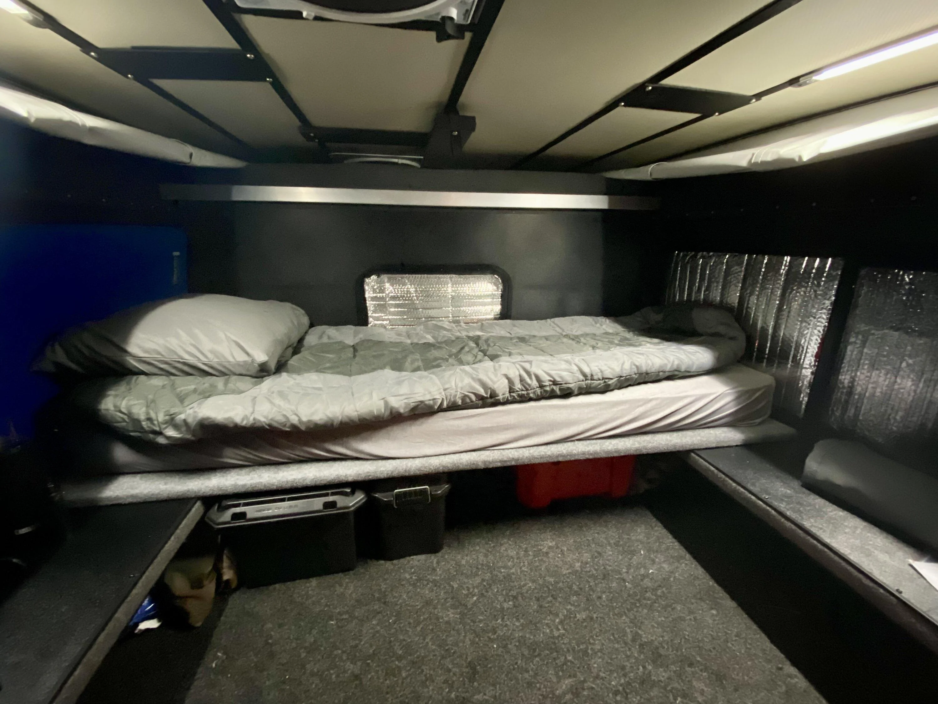

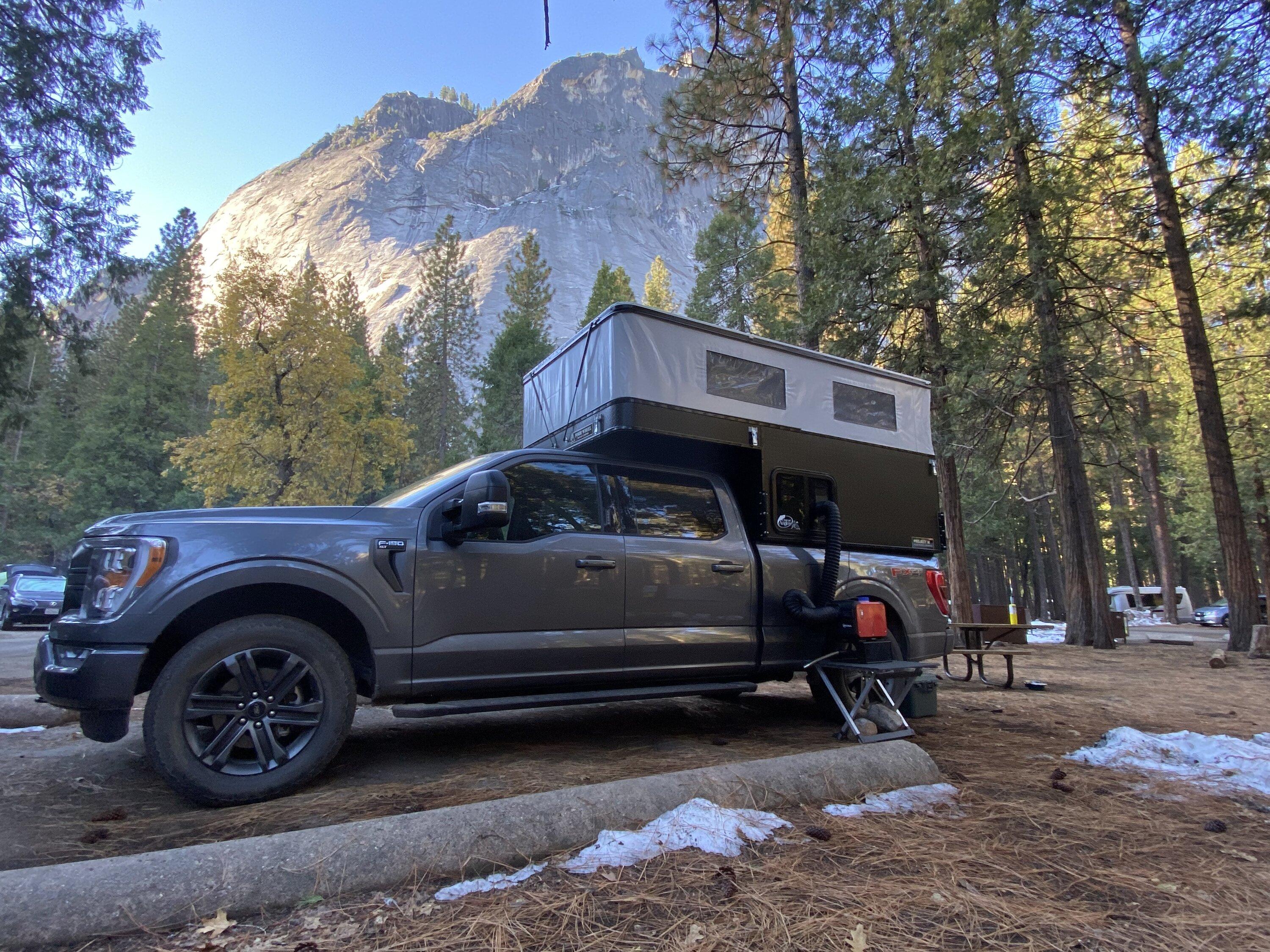

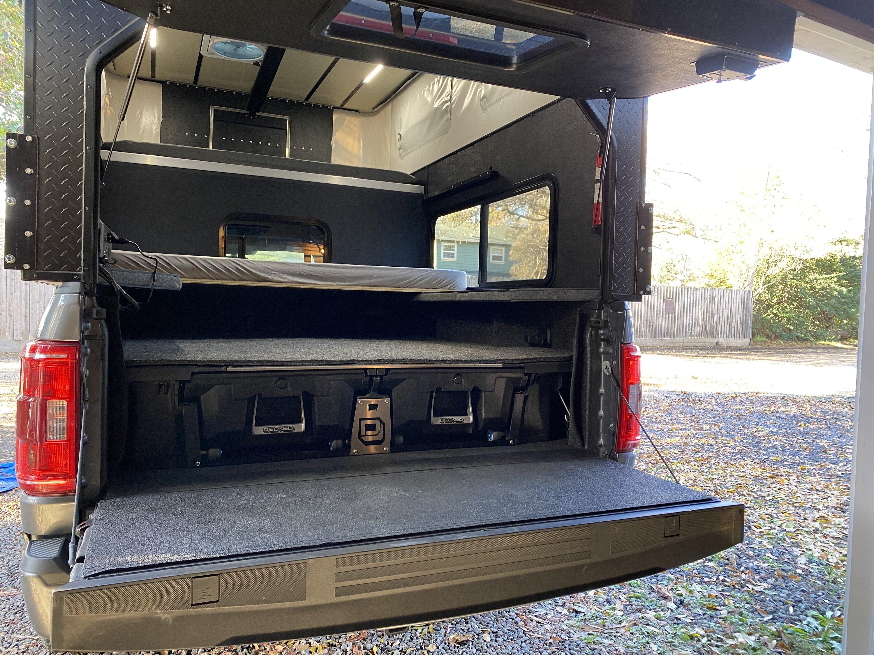

Good topper option for a half ton with 1800lb payload, happy with it so far. 480ish pounds
Some prefer to build them out with cabinetry and such, but what works for me is the drawer system with bedrug under it and bedrug universal mat on top of it, and a simple bunk across the side shelves to sleep in topper with roof closed/down.
Plywood bunk and bedrug mat can easily be removed when I need to haul large dirty hunting gear etc.

Awesome! Looks great and I love the simple nature of the setup. Guessing you're sleeping on the bunk instead of the over-cab area due to better heat retention?

Thanks
I sleep in it 2 or 3 nights a week when working out of town, and under those cicumstances, just going in there to sleep and parked in places where I dont want to appear as camping, I prefer to leave top down. That's one of the reasons this topper works better for me than a more aerodynamic wedge camper is the ability to sleep east west with the top down.
It does heat up and stay warm easier with top closed though yeah

This is awesome. If I were a single guy I would have picked up something like this, but the wife has allergies so we were worried about dust getting through without a full body slide in. Any issues with dust? For our setup I snagged a domestic toilet and camping fridge/freezer combo and we’re able to be comfy almost anywhere.
Also. Is that a swamp cooler you have connected outside the truck?

It isn’t totally sealed off, but I don’t get much dust at all with the addition of a RokBlock rubber tailgate seal, and bedrug. Still have a bit more sealing to do.
A slide in will be much better as a living space, the versatility of this topper just suits me better since it retains so much cargo space,
that is a diesel heater that is setup to operate outside and duct heat in

Why not just put the electric one inside the heated space? But I would add a CO detector inside if I was running the truck for power.

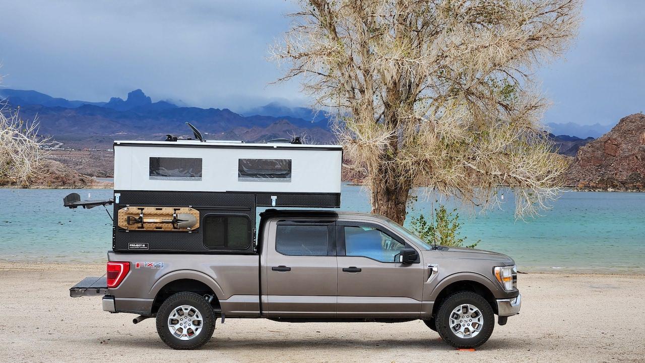

Well, @530Five-Oh, I have to say that you have fine taste. Perhaps we'll cross paths some time... :)

very nice and well traveled rig you have there!
I will keep my eye out and say hi if we see you
