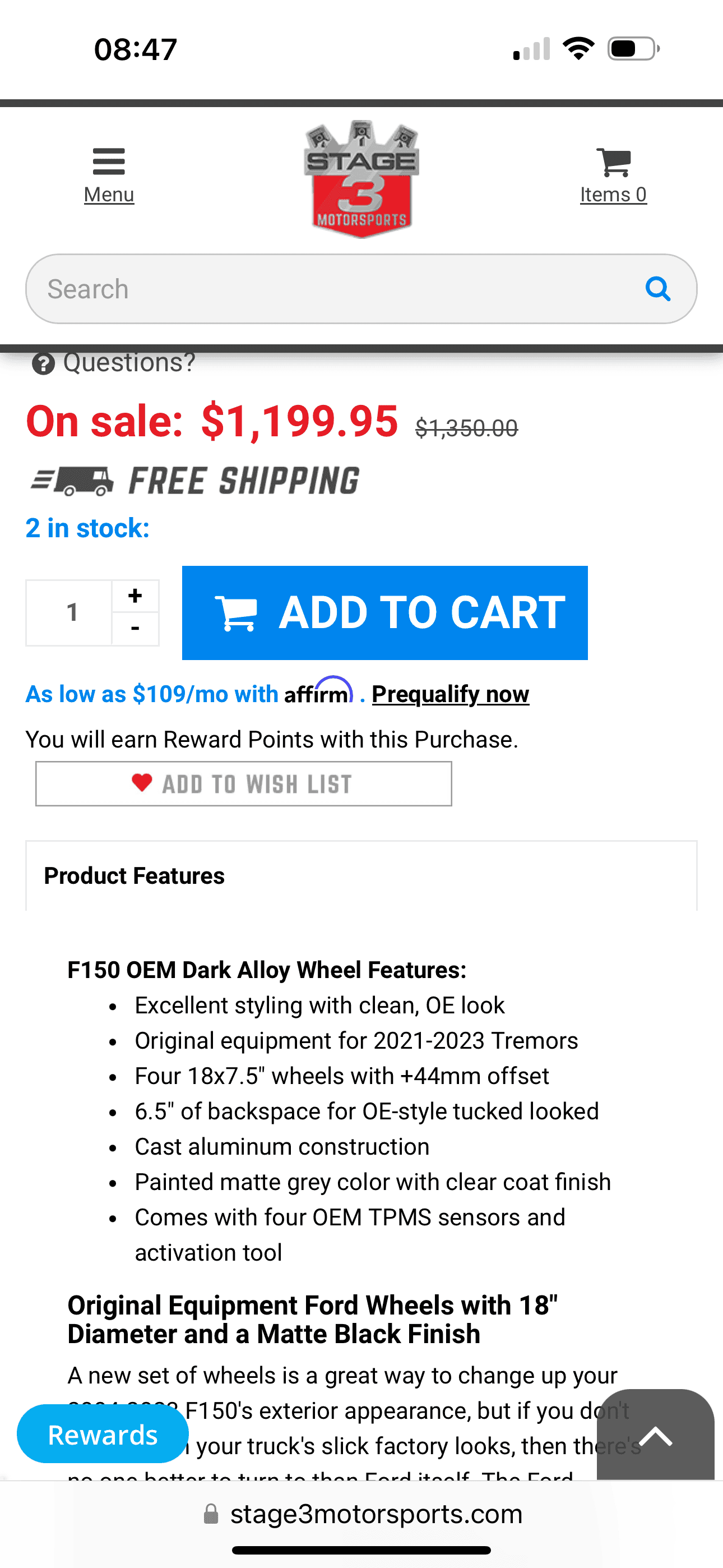

Ford F-150 FP Tremor wheel offset IMG_9493
And somehow this seller says 44mm offset ! Go figure

I believe the tremor and Raptor have same offset. wheels which is 34MM

I’m thinking the same as well. Thx

If you’re talking about OEM 18’’ wheel, the offset is 44.
