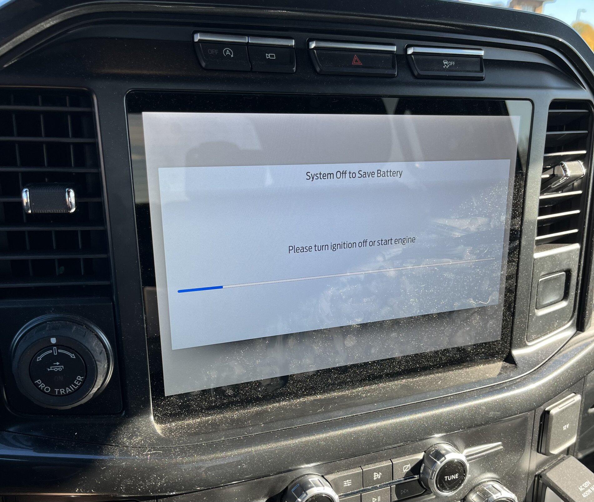

when You get out of the truck… make sure the system is not shutting itself off. Mine started doing this about a week ago and is at the shop now. It would look like this when you turn the ignition off.
my key fob still works but the ford app does not when I get this message:
Well I actually uninstalled ford pass, upgraded my phone to iOS 15, did a master reset and a ford pass reset to the truck then reconnected everything. Since then, it’s been working every time I try but it’s only been a day. I’ll report back in a week!
