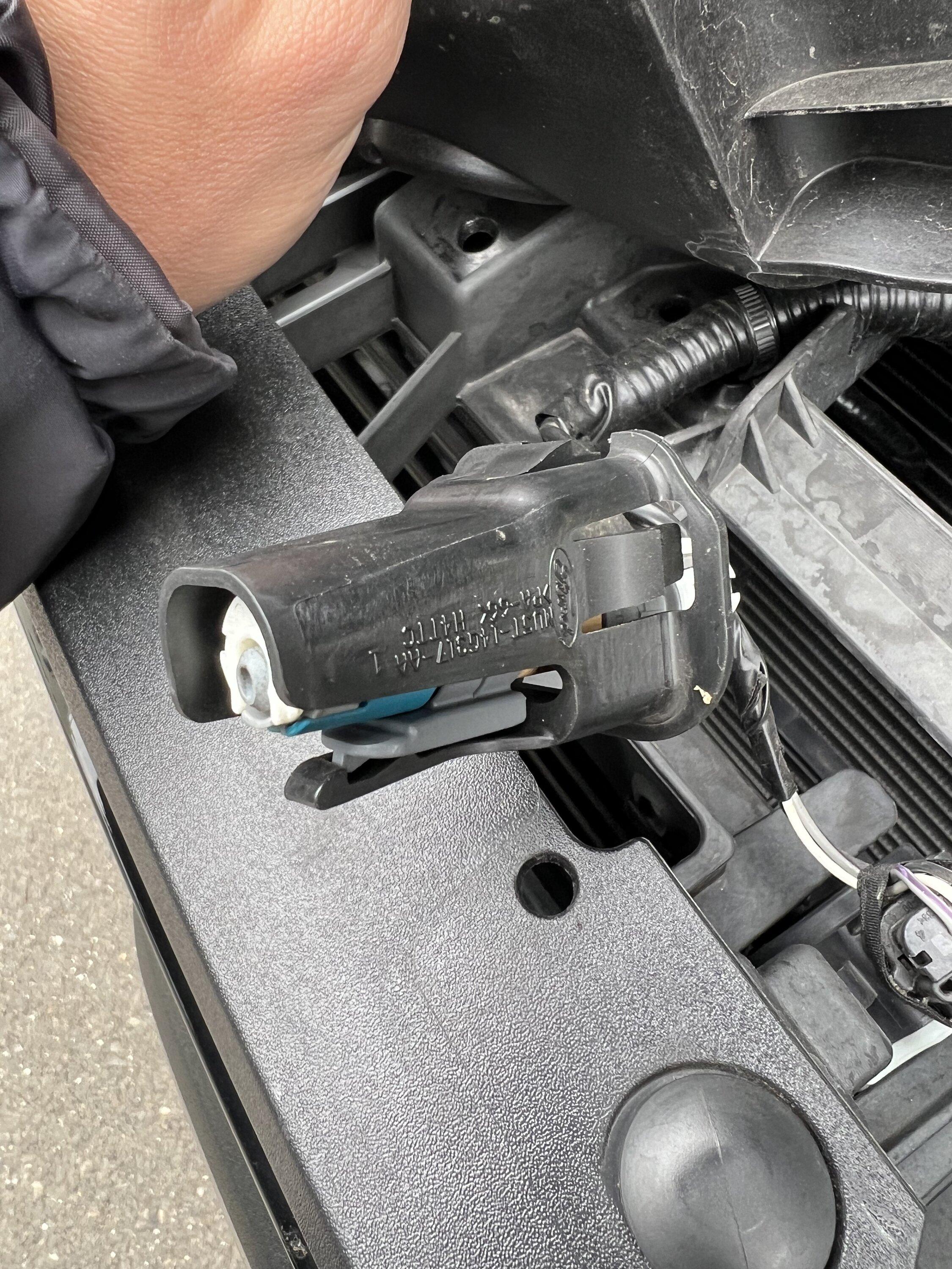

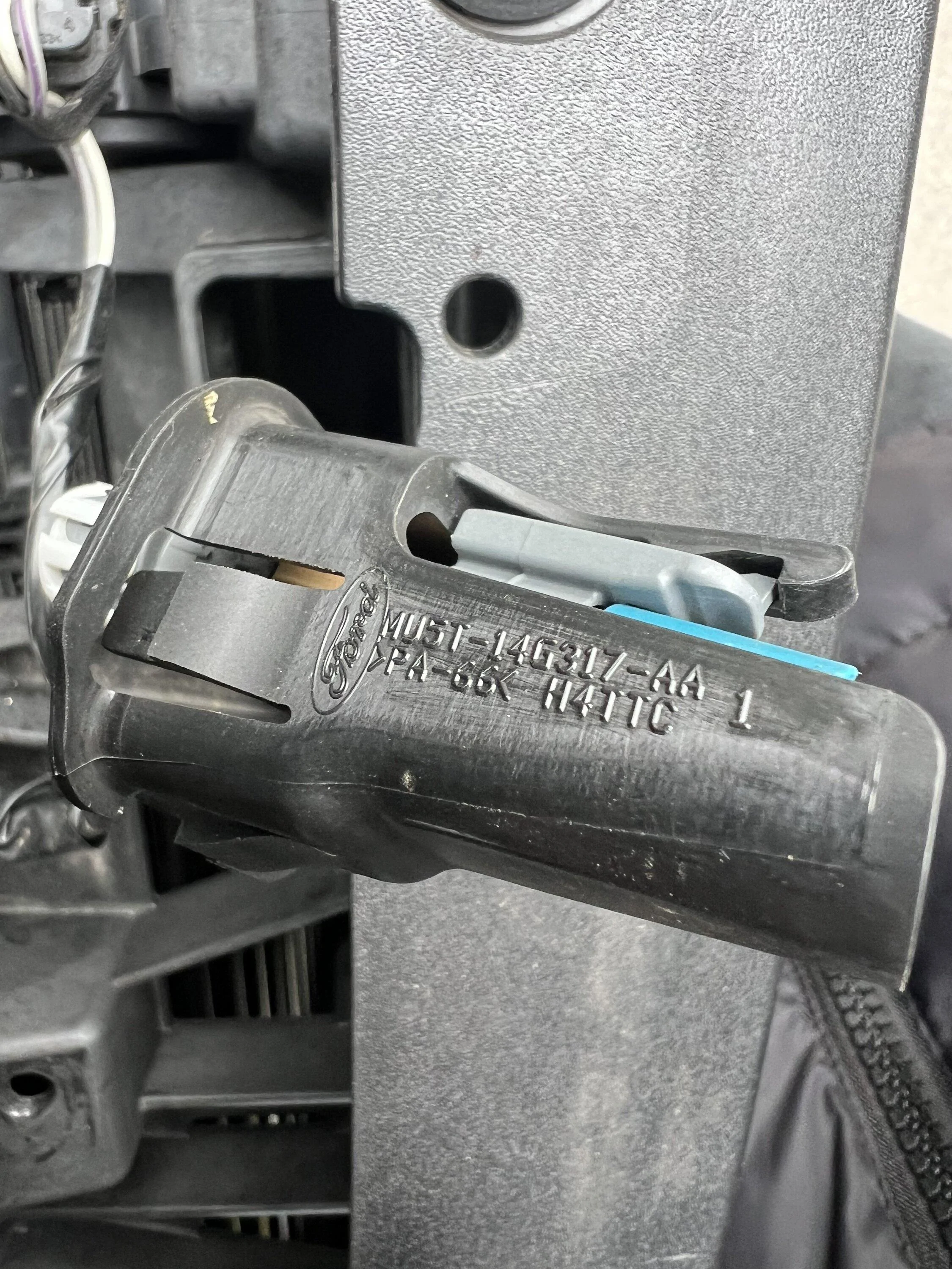

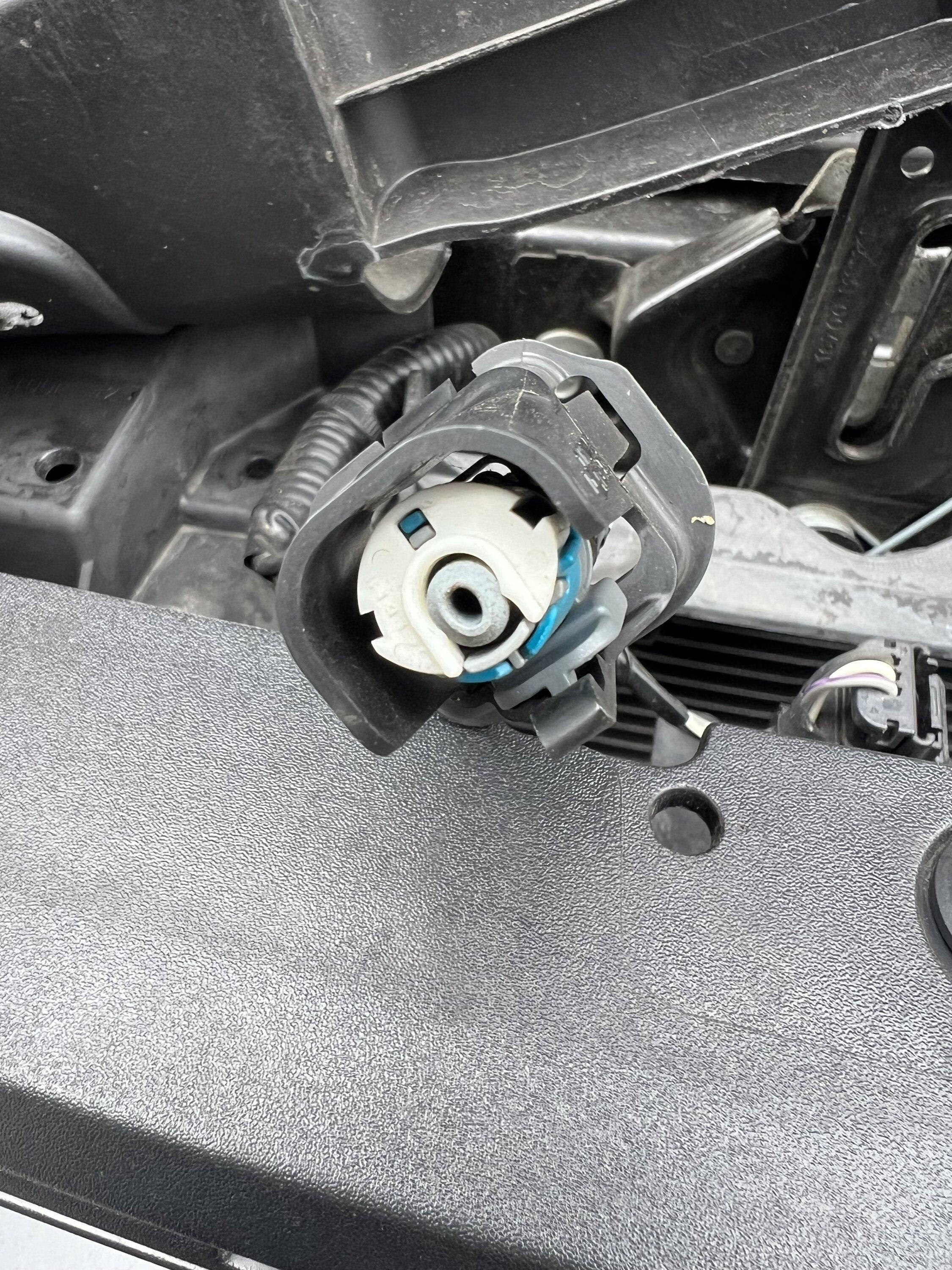

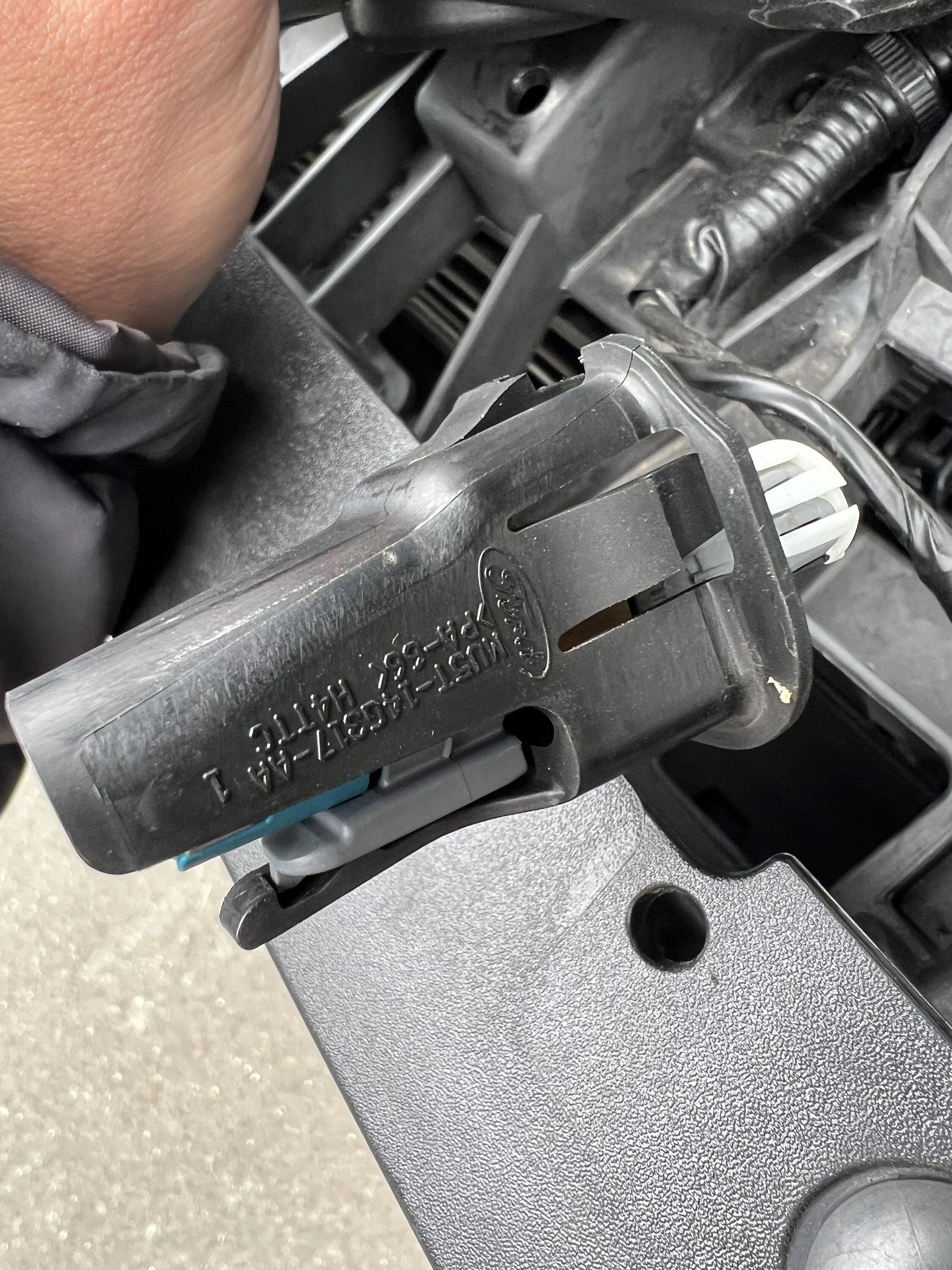

So I finally opened the front of my 2022 Lariat, and I found this hanging in there not attached to anything. Is this the connector to a front Camera? for some background info, the truck doesnt have a factory installed front camera, but I would love to install the OEM if the connect is there for it (oddly enough a few days ago the truck complained of front camera failure....lol)

Yes that is it, not sure if you can get just the front camera going or if you need the mirrors with cameras and a new ipma to be able to get it going, pretty much adding 360
Did u add a front camera to ur truck?

I did add to the front camera and yes i did connect something to that.

In my case I added the front camera, and both side cameras.
