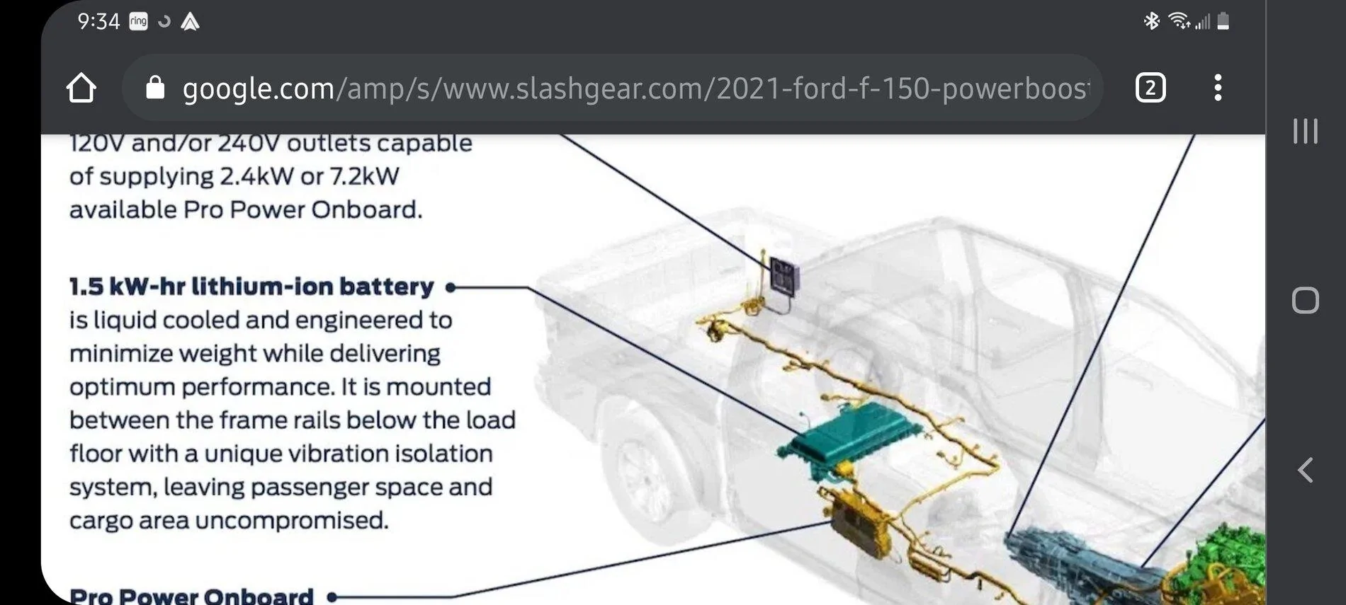

Just went out after the sun went down. Outside Temps at 103. Fans are all running normal. Do the powerboost have a cooling system for the batteries and inverters similar to the Tesla? I wonder is the fans are running full blast to cool the batteries? Tomorrow is supposed to be 115. I'll see what it does then...

Ford F-150 Engine fan runs continuously in 110 degree heat! Screenshot_20210614-213436_Chrom
Battery is liquid cooled so very possibly the fan was running to cool the batteries when the outdoor Temps exceeded 115. Any other AZ powerboost owners experience this?
