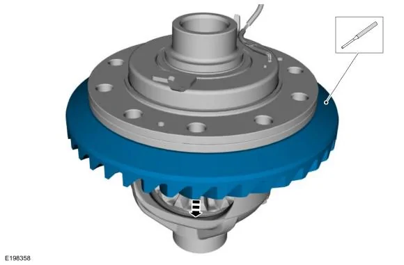

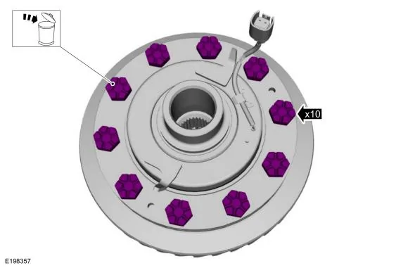

I can’t fall asleep so this is what my mind is on tonight. Regarding the 3.31 & 3.73 Electronic Lock RR axles, does anyone have a diagram or pics of theirs opened up that shows how they work and the mechanics of it all? I see a plug goes into my rear differential housing, which I presume is some sort of solenoid that makes it switch to the locked mode. But I am curious what parts exactly that Ford changes from the standard open axle to the electronic locking units. I have read somewhere about a lock pin, but can’t find much more.

Known as "ELD" (electronic locking differential) in the workshop manual, here's two clipped excerpts for your reading enjoyment .....
The ELD system consists of the following components:
  • ELD field coil, located at the rear differential
  • Rear differential with dog clutch
  • ATCM (all terrain control module)
  • TCCM (transfer case control module)
  • MSS (mode select switch; unique for ELD equipped vehicles), located on the instrument panel
When the operator activates the ELD , the ELD icon displays in the IPC message center. If the vehicle is driven above the disengage speed, the IPC message center no longer displays the ELD icon, alerting the operator that the ELD is disengaged. Once the vehicle speed drops below the re-engage speed, the IPC message center displays the ELD icon again. If there is a malfunction with the ELD system, a CHECK LOCKING DIFFERENTIAL message is displayed in the IPC message center, letting the operator know the ELD is not engaged.
Under certain conditions the ELD system has the ability to modulate powertrain torque output as well as system engagement/disengagement to protect internal ELD hardware.
The ELD feature allows the ABS to override the engage state during special events. When this condition occurs the ELD icon flashes on and off rapidly.
The differential locks when a PWM controlled magnetic field coil located inside the differential energizes. This locks the differential side gears and creates the locked differential.
The workshop manual has much more extensive discussion than just the above about the operation of the ELD system, including control logic flow diagrams and several tables of data.
Here's a couple of pics showing the ELD coil on the ring gear
Ford F-150 Discussion on the Electronic Locking Axles coil 01
Ford F-150 Discussion on the Electronic Locking Axles coil 02
Hope that helps with the insomnia ;) :)
