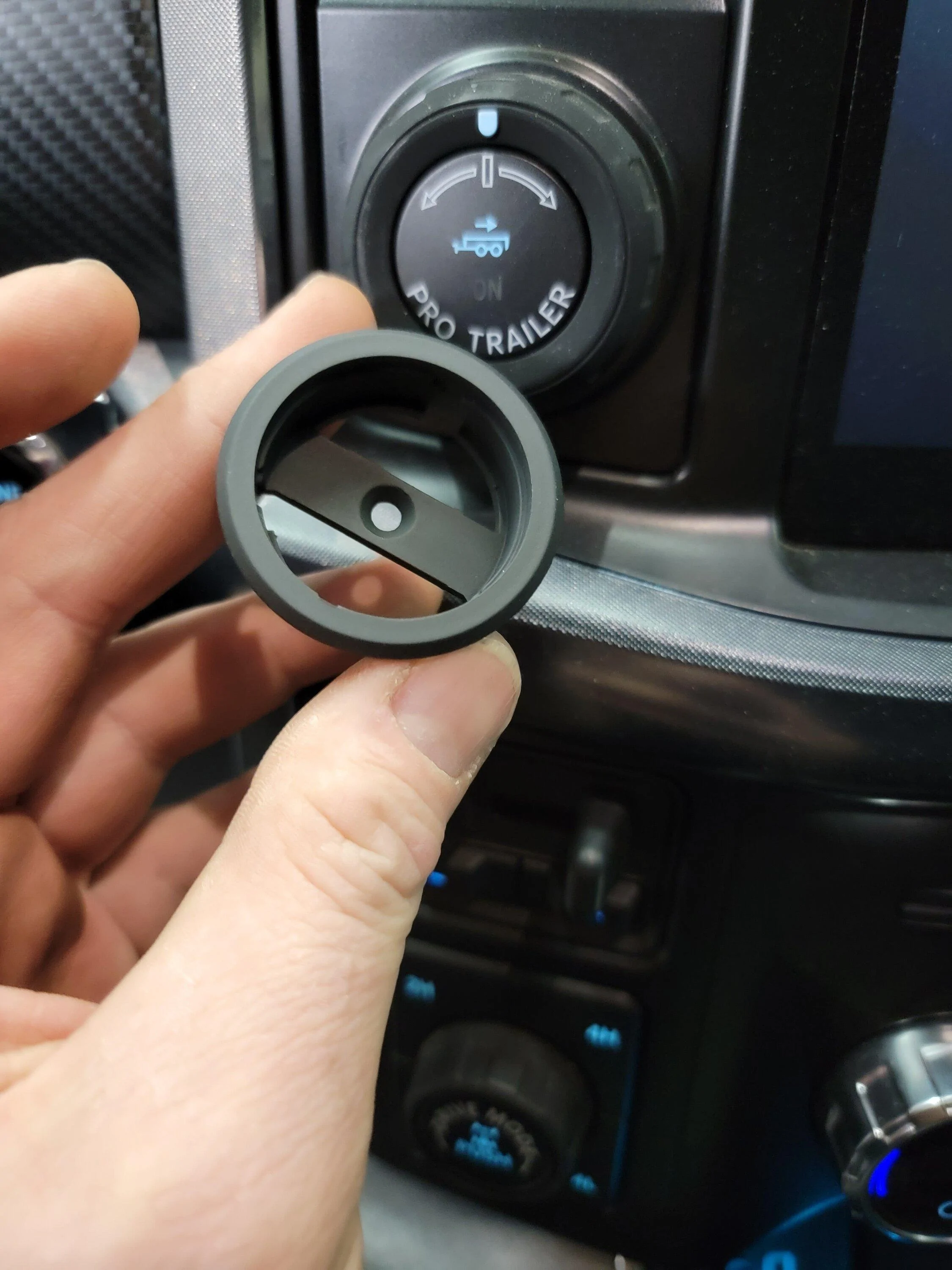

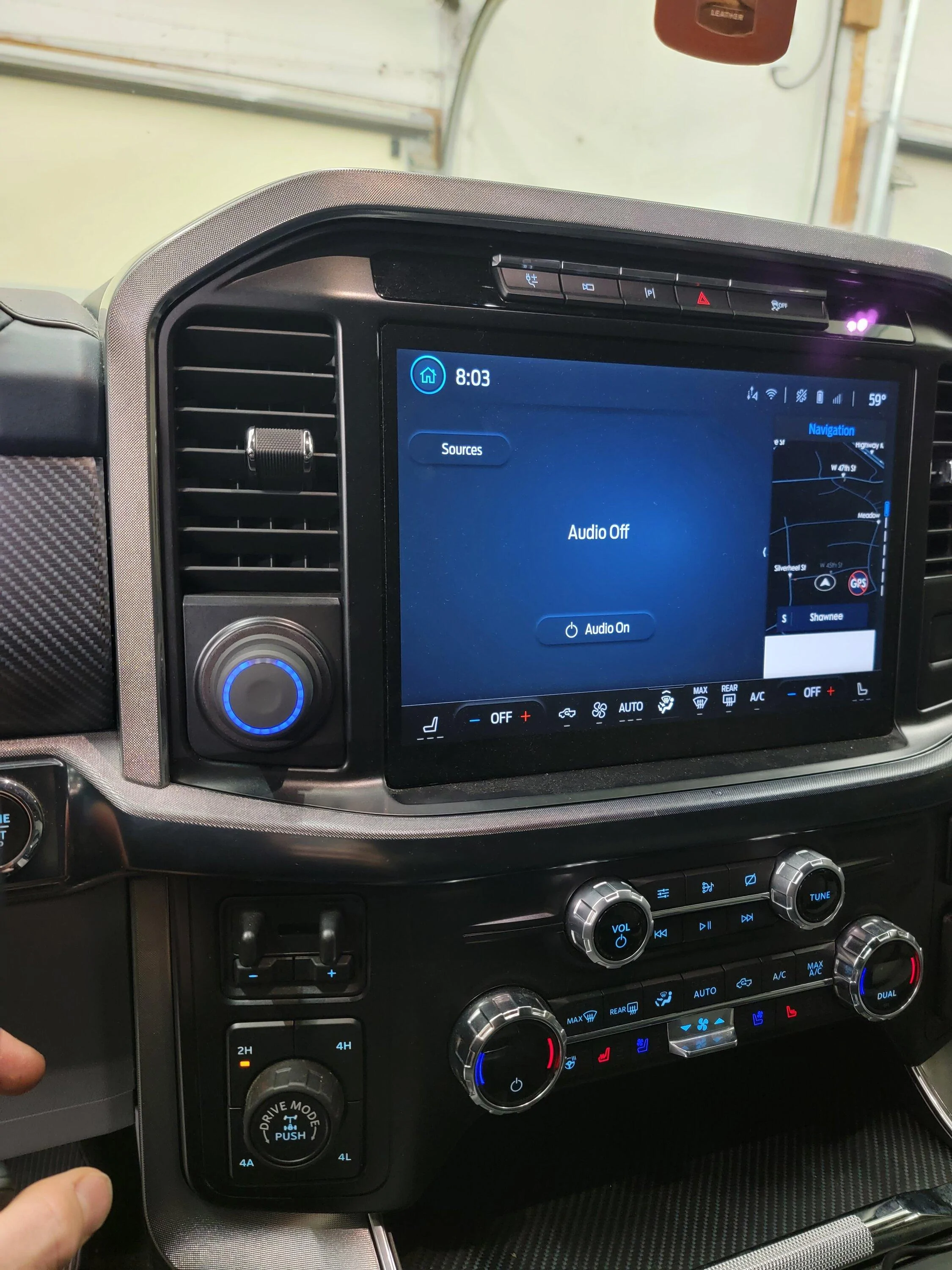

Audison (stateside) finally coughed up the DRC AC controller for their new Forza AF M and AF C DSP/Amps. This truck has the AF M12.14 Bit unit which has 12channels of amplification and 14 channels of DSP control

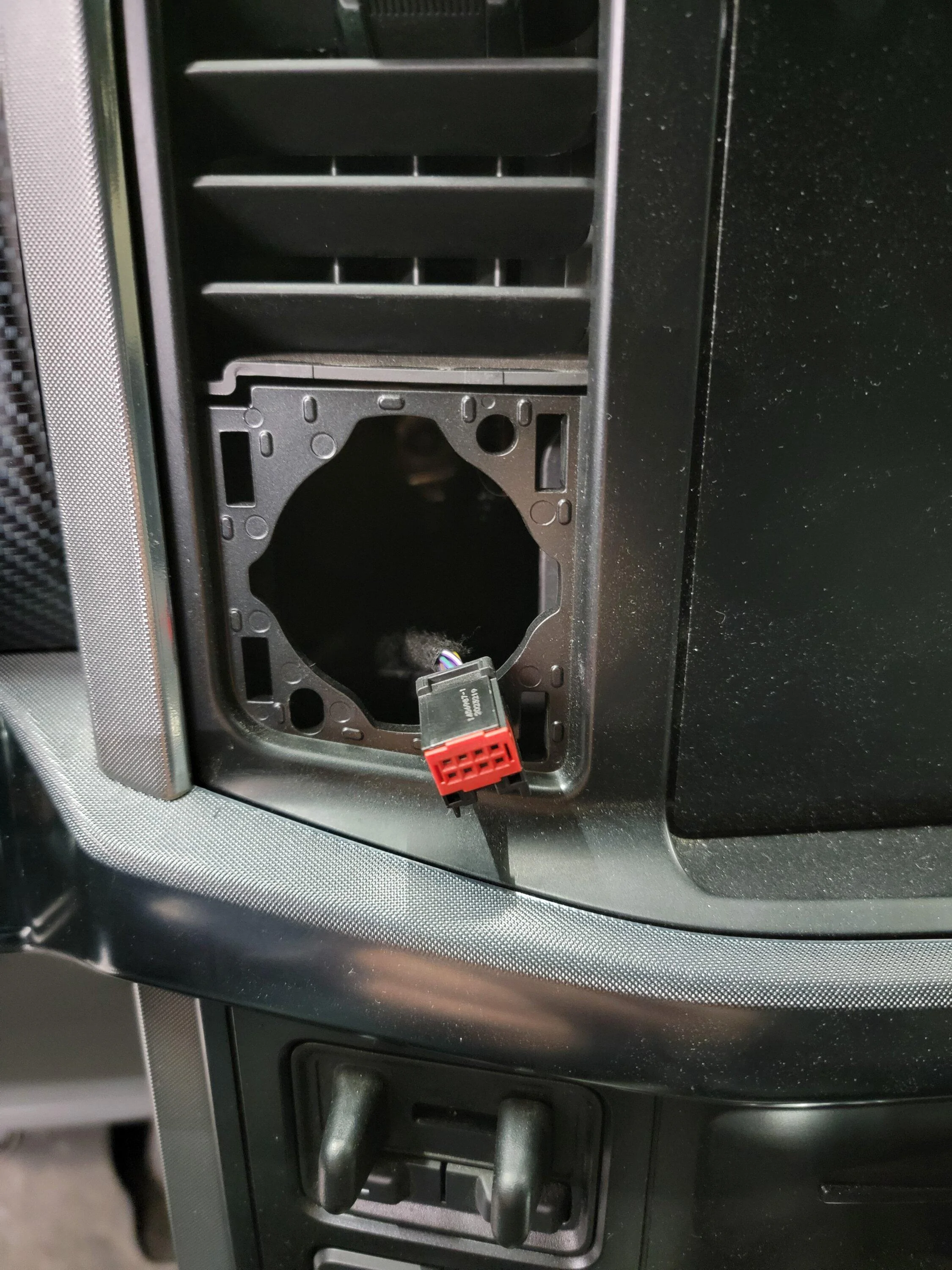

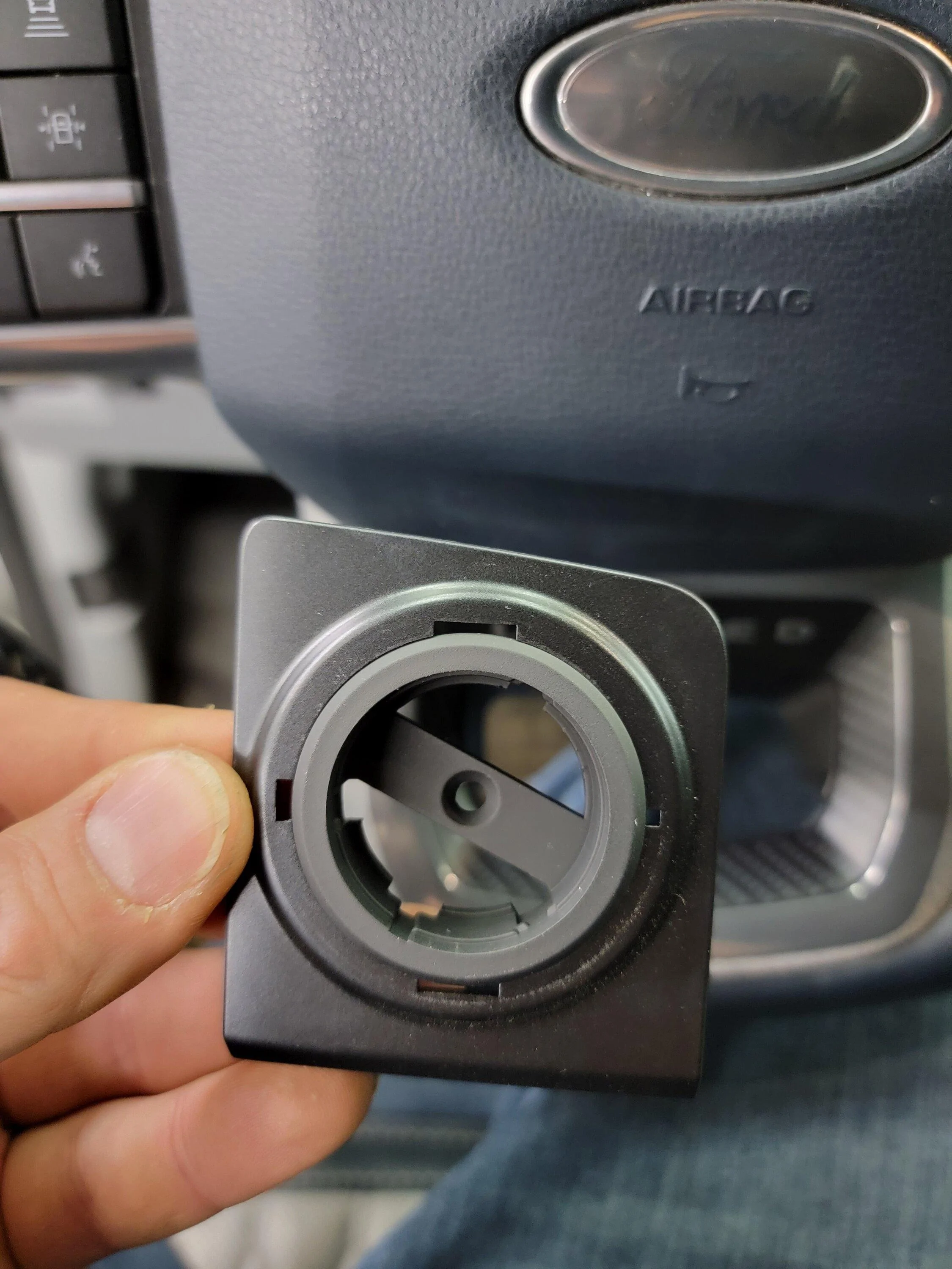

I wanted an OEM install and after about 5mins I chose the spot that was occupied by the Pro Trailer Backup assist knob. Having never used it, I saw no loss in removing it.
Then I designed and printed an adapter to fill the gap and center locate the recessed cup within the OEM plate.
