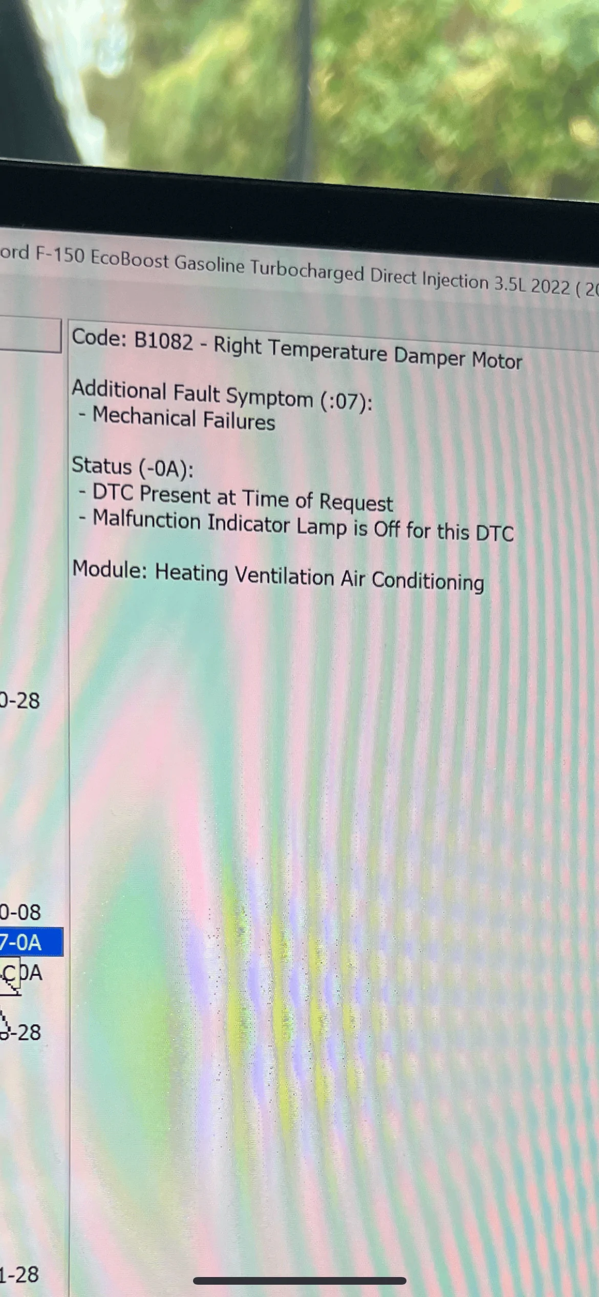

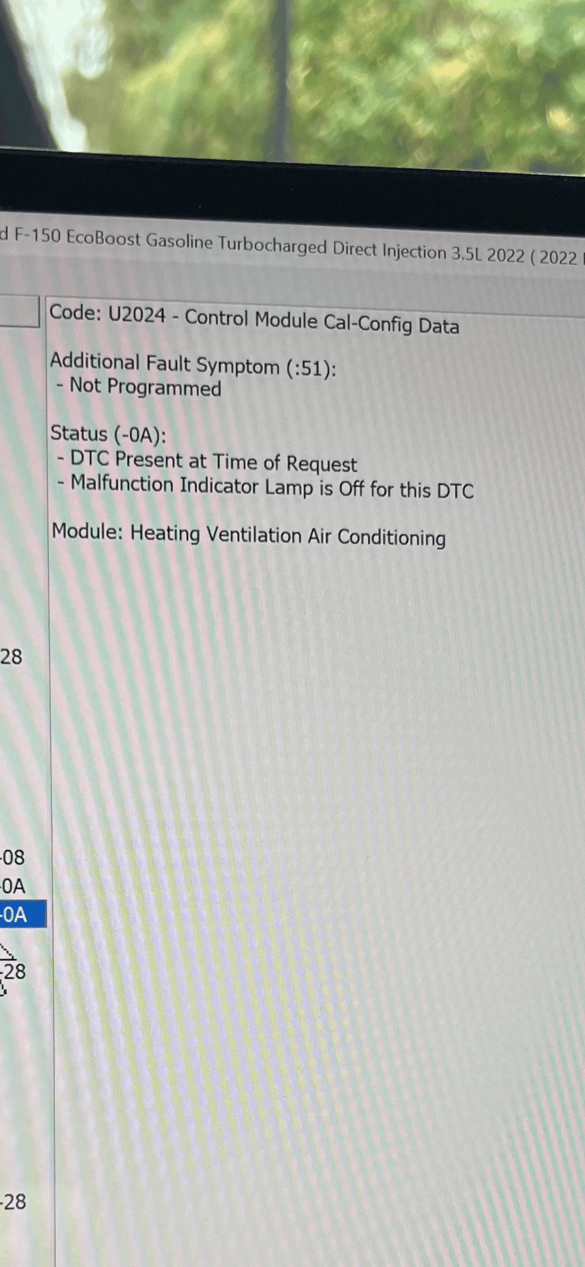

I swapped mine, transfered the as built codes in forscan. Everything works as before. But there is a dtc for “not programmed” but I heard that is normal.
recently I got a damper failure, someone said I need FDRS to run a damper calibration (end points) with the new controls
can someone confirm?
