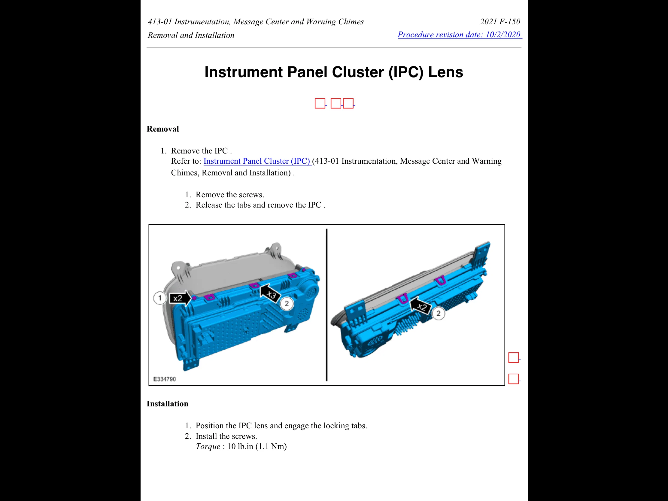

That’s a good question. I can’t tell whether the gauge cluster and the IPC are the same from the shop manual. What appears to be the electronics part of the IPC clips onto the back of what the manual describes as the “lens.” Can’t tell if the lens is just the plastic protector, the LCD display, both and whether you buy them separately or as a integrated unit. I had assumed that the IPC was similar to the APIM in that the module and the display were separate parts but that might not be correct.
Ford F-150 Digital Dash retrofit install? AD243A9E-5D99-451E-A05D-DA166A228E57
