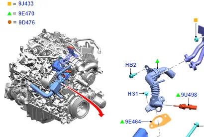

I've seen quite a few posts on coolant leaks, but it appears this is not as common as the exchanger.
2022 Powerboost Lariat
6.5ft Bed
Super Crew
6000 miles
What happened: Pro Power onboard warning came up as not available. Checked temp gauge and it was pegged. Got it to the dealer, he said there is a coolant leak and they would need to order parts. 3+ weeks later, still waiting on part ML3Z9E470B with no end in sight. All this over a connecting tube, so frustrating.
