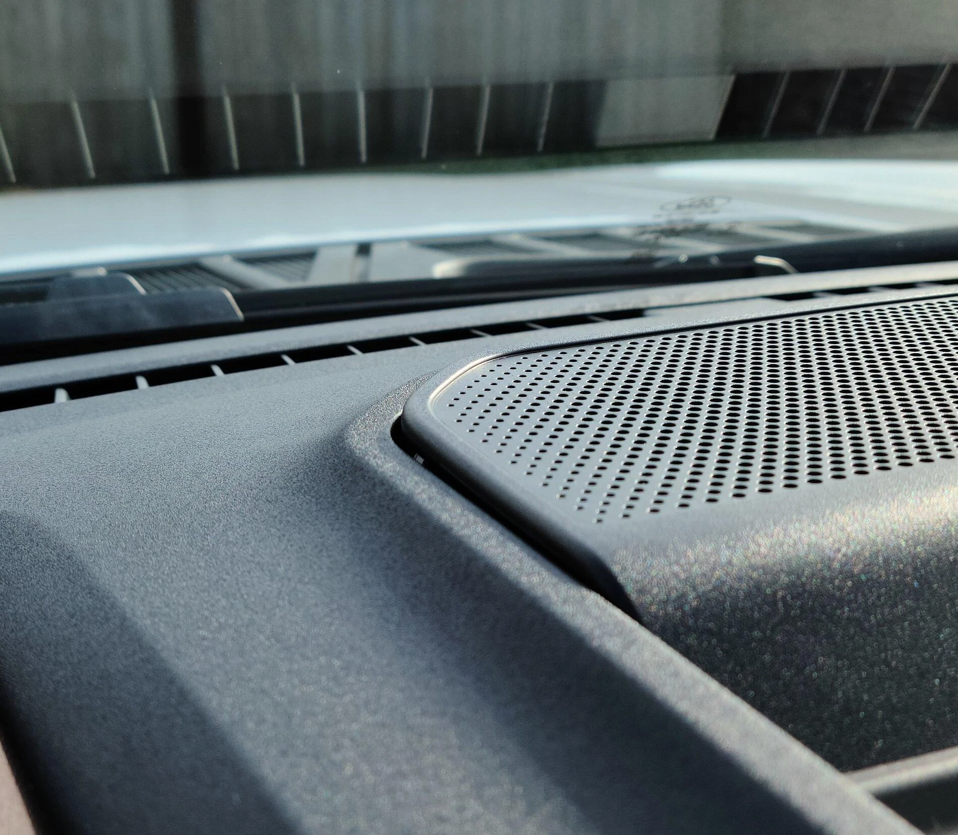

I've noticed the center speaker guard/cover on the dash is slightly more raised on the driver side than passenger side. Seems like it is not fully seated but I've pressed down on all sides and it doesn't seem to want to come down. How does your cover compare to mine?

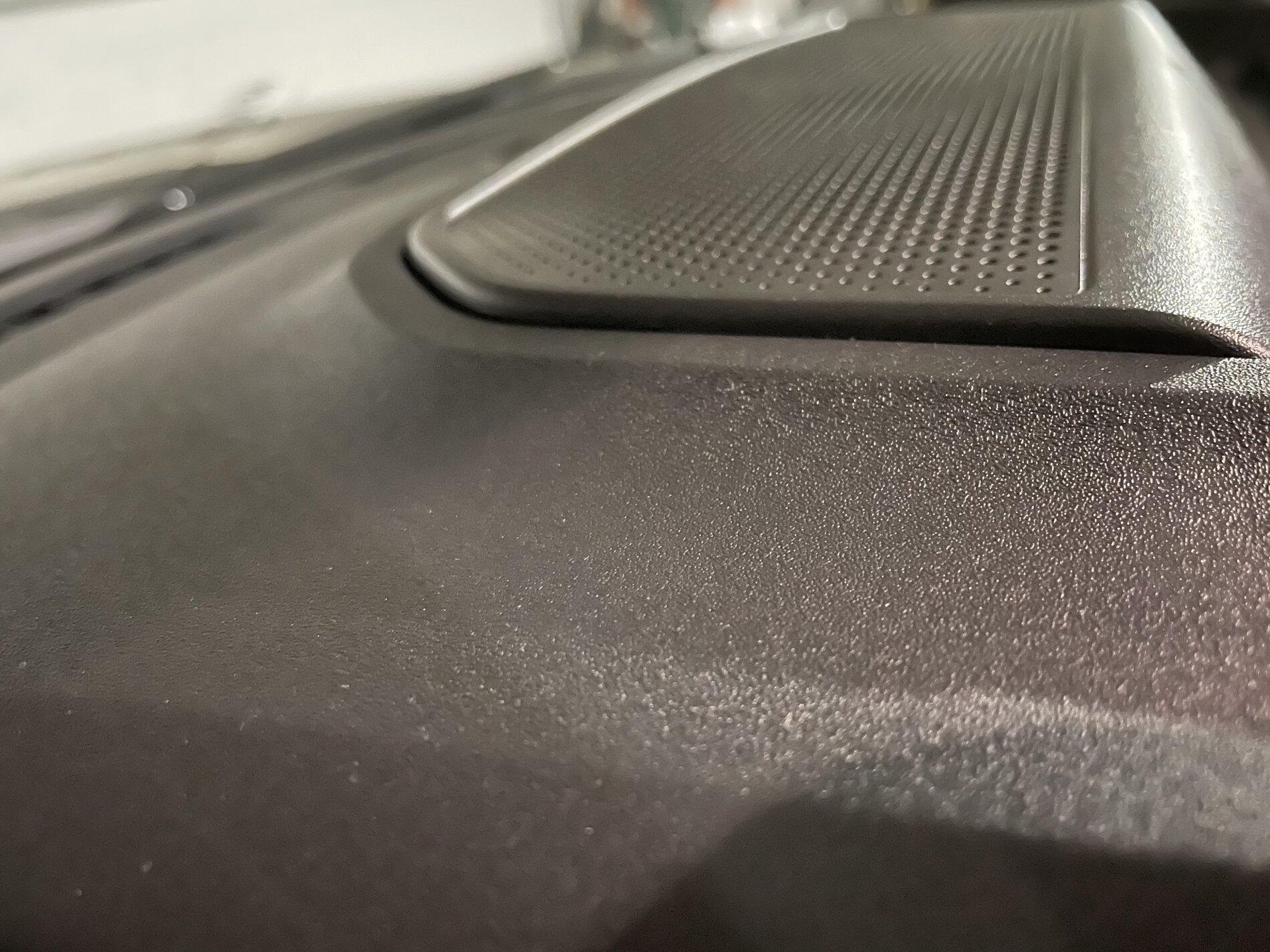

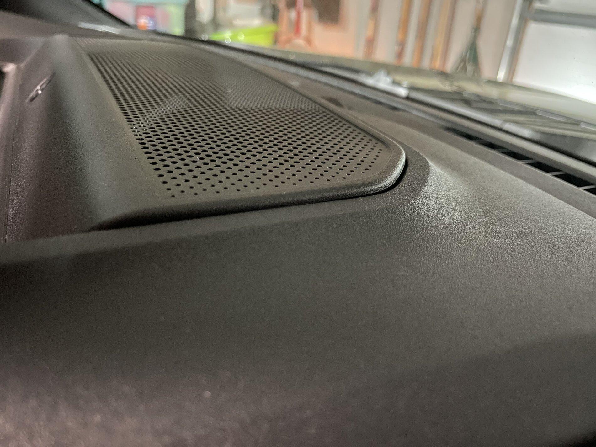

That's what I thought. Thanks for checking!
I'm going to use the Autostop Eliminator instruction video to dive into it. I trust myself more than I do the dealer.

Looks like that's a B&O system that's different from stock panel in video but prob same mounting points? looks easy enough to remove adjust replace....maybe...I just bought a plastic paint scraper, to do my eliminator install once truck arrives, should be be here this week, long before my truck...
From vid kinda looks like that grill sticks up a bit too though?

Randomly, I have the exact same problem in the exact same spot in my 22 lariat. I’ve noticed that if I remove the center speaker, cover, and then take out the two bolts, holding the speaker panel down, one of the dashboard clips is missing the little green insert to hold it in. My plan is to try to find a replacement for that. Were you able to get yours fixed?
