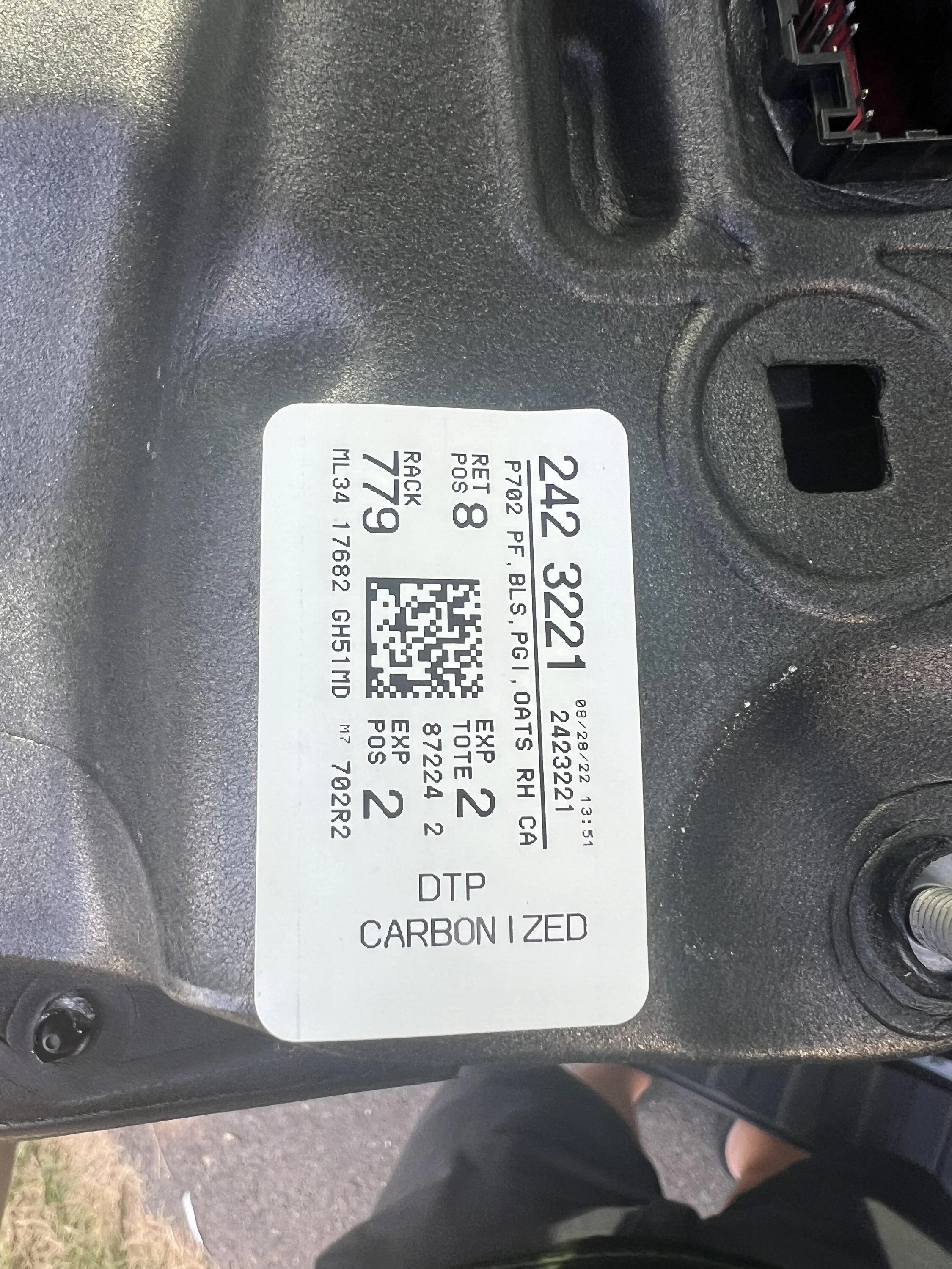

Can anyone tell me what this side mirror has ?

Based on this picture.
Ford F-150 Can anyone tell me what this side mirror has ? IMG_4469
discothan
Jan 4, 2021
728
690
SW Michigan
2021 F150 XLT
PF - power-fold
BLS - blindspot
PGI -
OAT -
CA/M - camera
RH/LH - righthand/lefthand

It doesn’t have a camera.

I’m CT but it’s def not what I see online usually it ends in LH/RH
PF - Power Folding
BLS - Blind spot
PGI- Power Heated
OATS - Air Temperature, Turn signal
CA - Cross Traffic Alert
???? Maybe?
The mirror itself doesn’t have the camera, unless it’s a complete unit, but I would think the mirror would be a separate part. The camera is mounted under the mirror bracket, perhaps there are different mounts for the mirrors with or without the camera. Doesn’t really make sense they would be different though.
