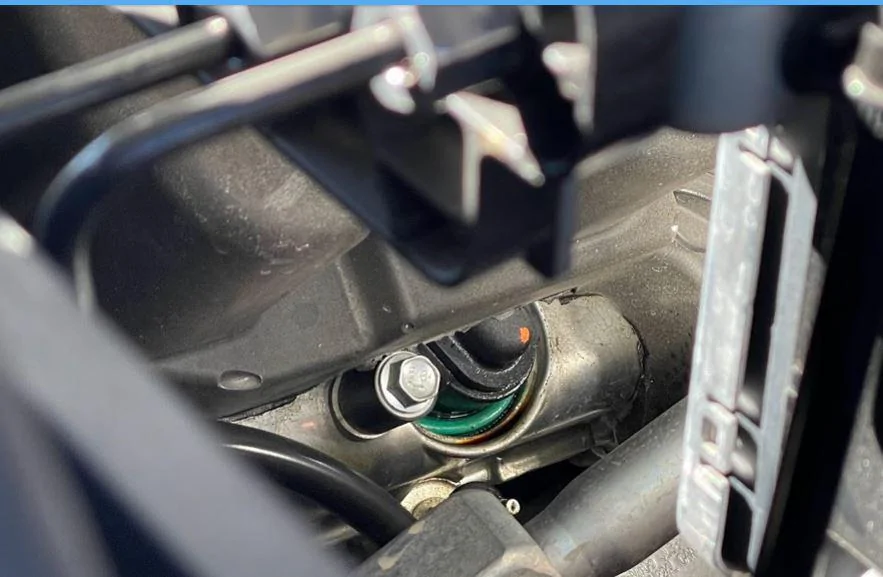

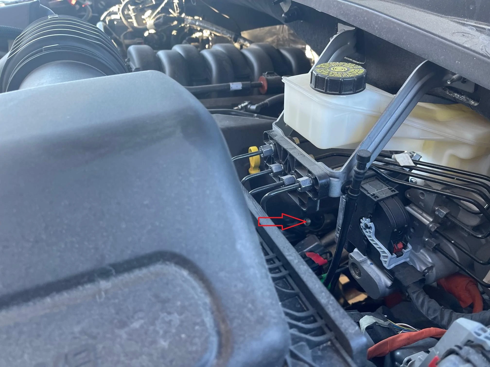

You're right about an oil leak because I just saw it, some component on the side/underneath the right side of the engine. That picture I attached shows where I see a small amount of oil pooled there in that seal area, kind of hard to see but that has to be it

There's a close up of where it's coming from
Interesting, that definitely looks like it! I wonder if that’s a sensor of some kind (thinking oil pressure but could be that green seal that we can see)
Glad you’re getting to the bottom of it!
