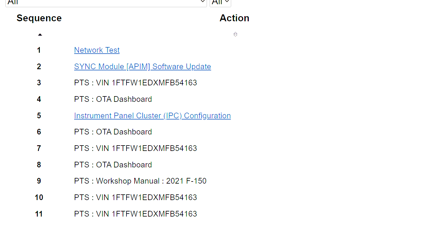

I dont know why its so hard for them. Your situation.. You have two more APIM updates. There is one available NOW.. Once they do that another APIM will be available.
Your IPC needs to be configured also. That is a issue. They need to run config on the IPC AFTER! AFTER they update the APIM to JV.. the final APIM version should be 22095
Once it is run config on the IPC. You have some config issues in there. You will be done after that

That worked. After 8 days trying, they did what you said. It took 5 hours to do it. I took it to a highway today and the screen changed to blue and and Blue Cruise worked great.
Previously they had updated the GWM software, the TCU software, reset the BMS, but nothing worked. They could not download USB software, possibly due to server issues. After a second attempt they were successful and they updated the APIM software to version 22905 and performed the IPC configuration.

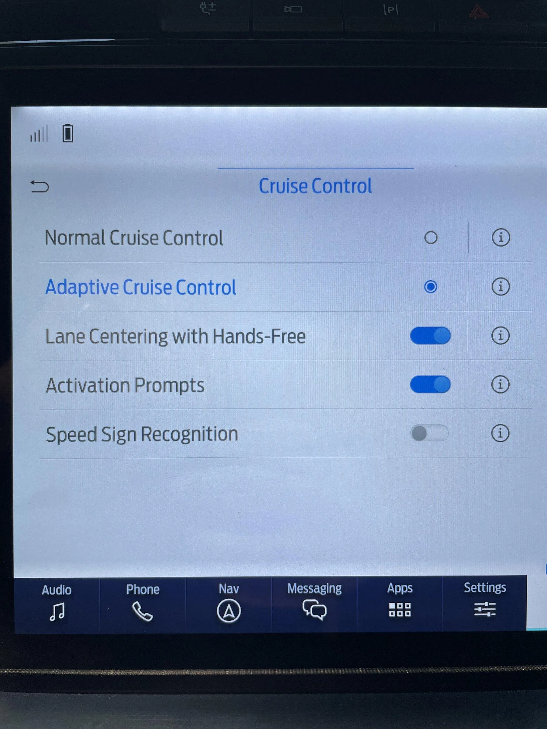

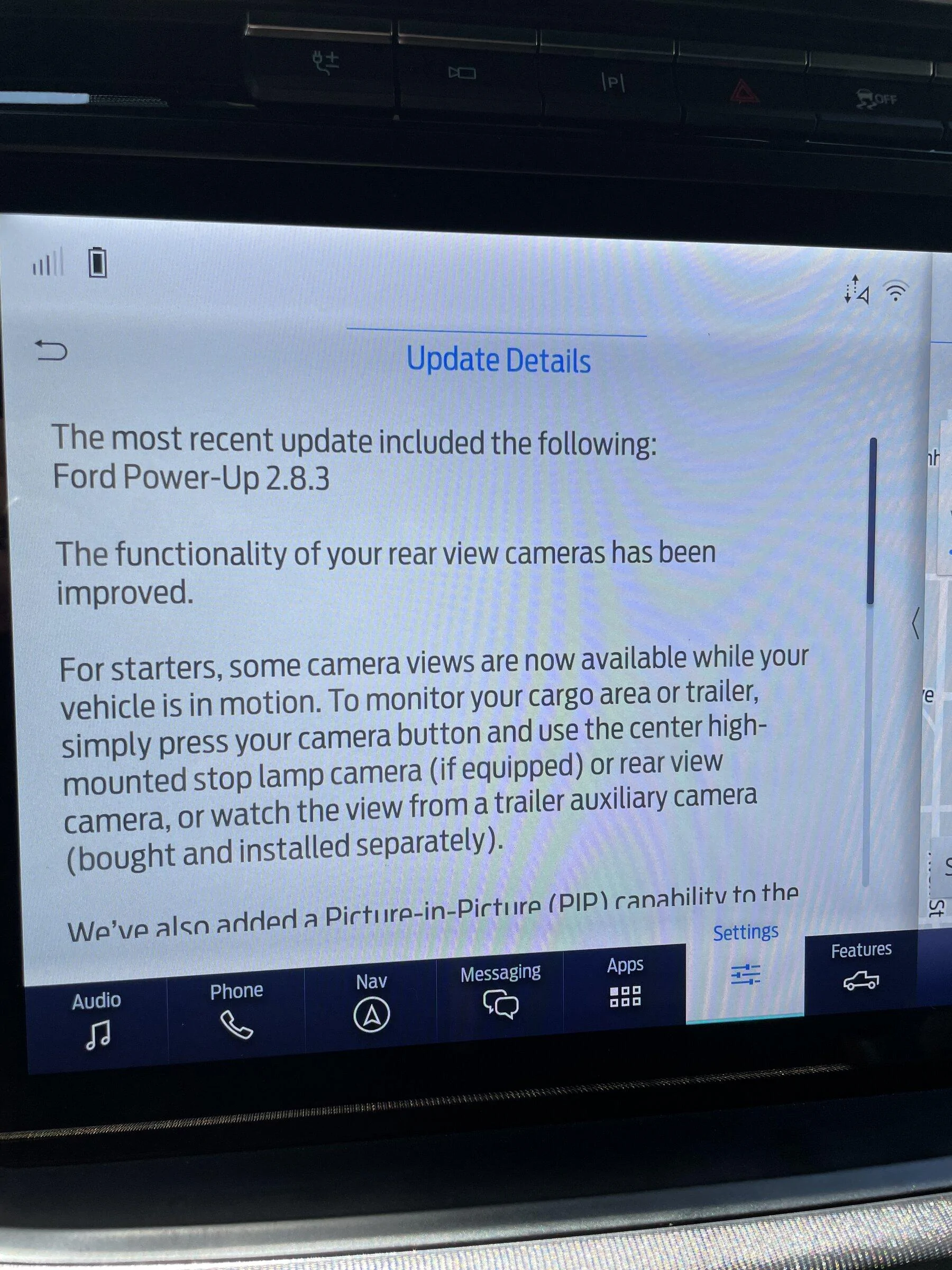

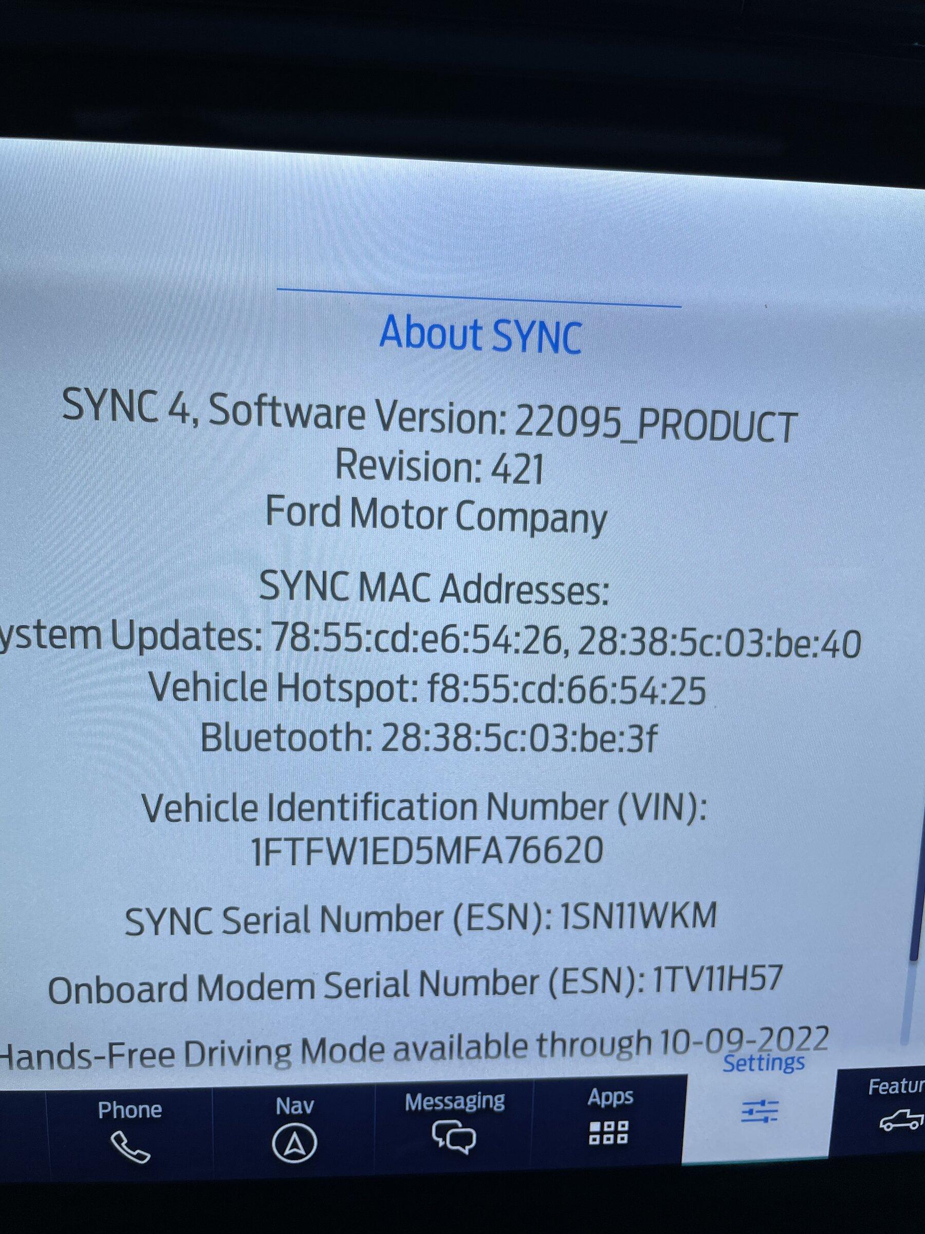

I still do not have blue cruise on mine. Dealer is still waiting for some sort of charger to try again. I’ve received two OTA updates since I picked it up a few weeks ago. Any chance you could check the status of mine again? I’ve attached a a screen shot of my most recent update and my new sync software number which changed with the most recent update. The cruise control option has also updated from “lane centering” to “lane centering with hands free”. However, I still have neither lane centering or hands free anything. Appreciate all your help.

yOUR tRUCK IS ALL SET TO GO. tHE ipc CONFIG IS WRONG THOUGH. Youll have to get forscan to fix it. OR ask the dealer to run a config on it. Everything else is all set to go.

It is in FDRS. IPS Config.
If you tell me right after they run it I can tell you if its fixed
