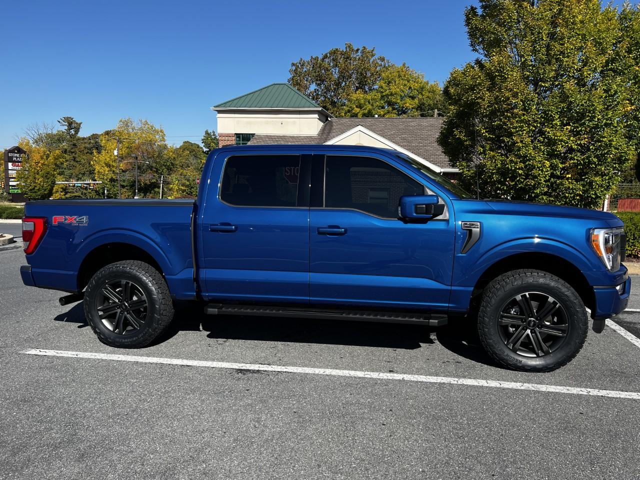

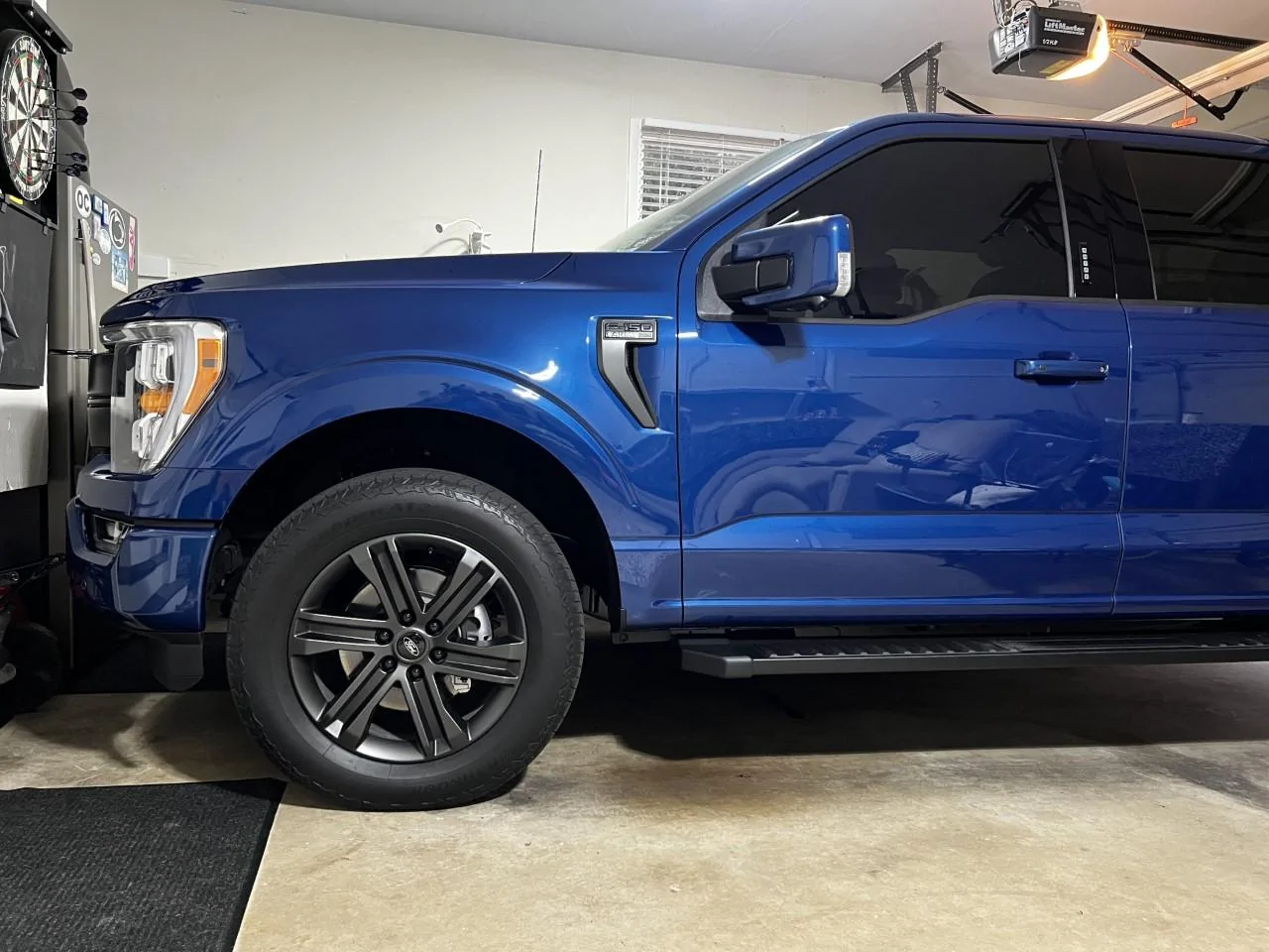

It's not going to be an apples to apples comparison but I recently installed Bilstein 5100 rear shocks and front leveling struts on my Lariat Supercrew 5.0 FX4. I started with 3" of rake (front 37-9/16", rear 40-9/16") and by setting the strut to 1-1/2" of lift, it now has about 1-5/16" of rake (front 39-1/8", rear 40-7/16") so I got a little less than 1-1/2" of lift . Since the 6112 kit comes with new coil springs I can't say what effect that might have but I would think it might get you closer to the advertised lift height since the coils are most likely a little stiffer. If you are looking for 2" of lift or a little less I would set it at the 2" notch since many people say that once the shocks break in they settle a little.
