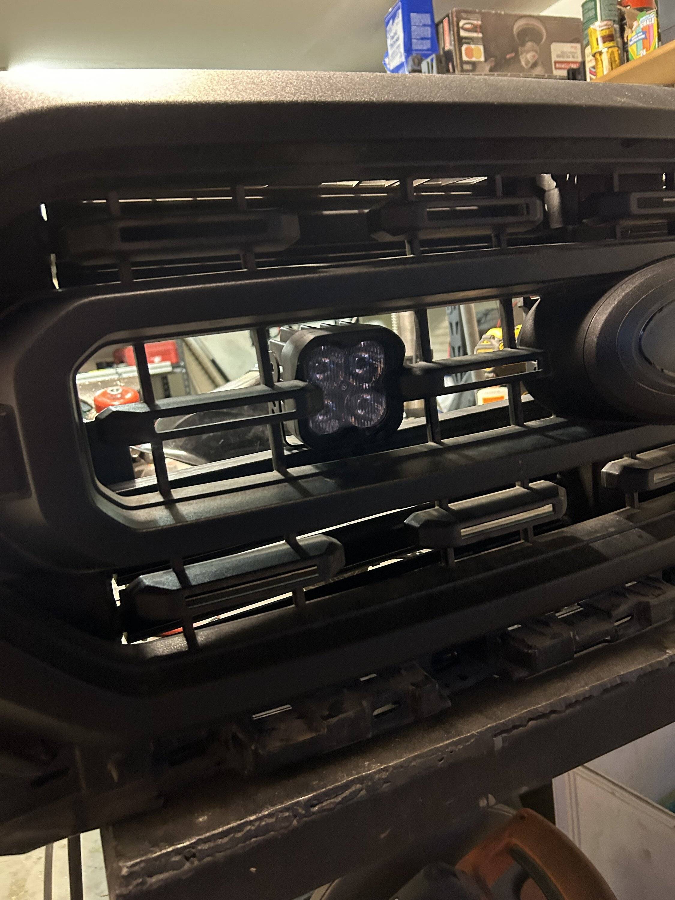

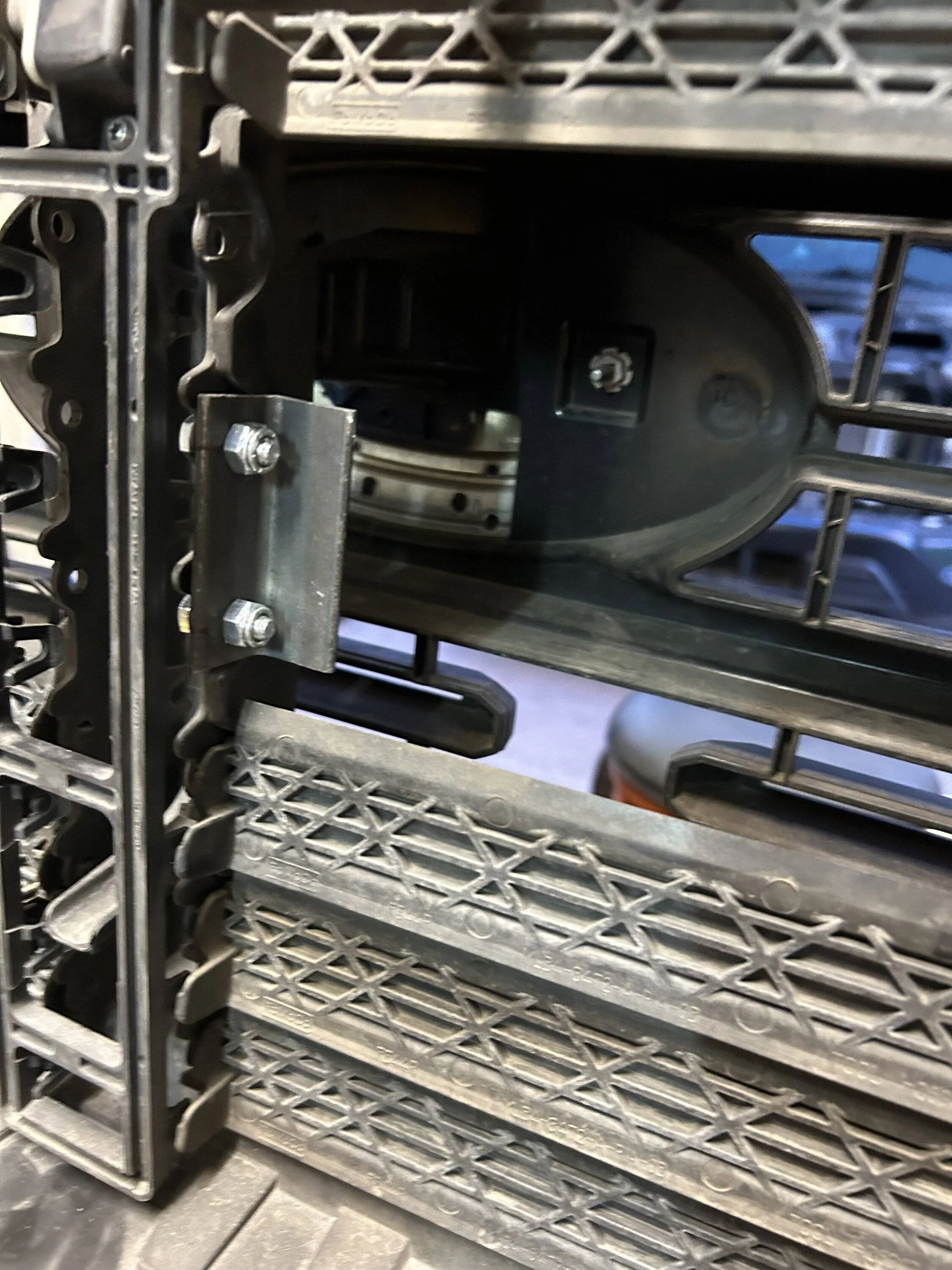

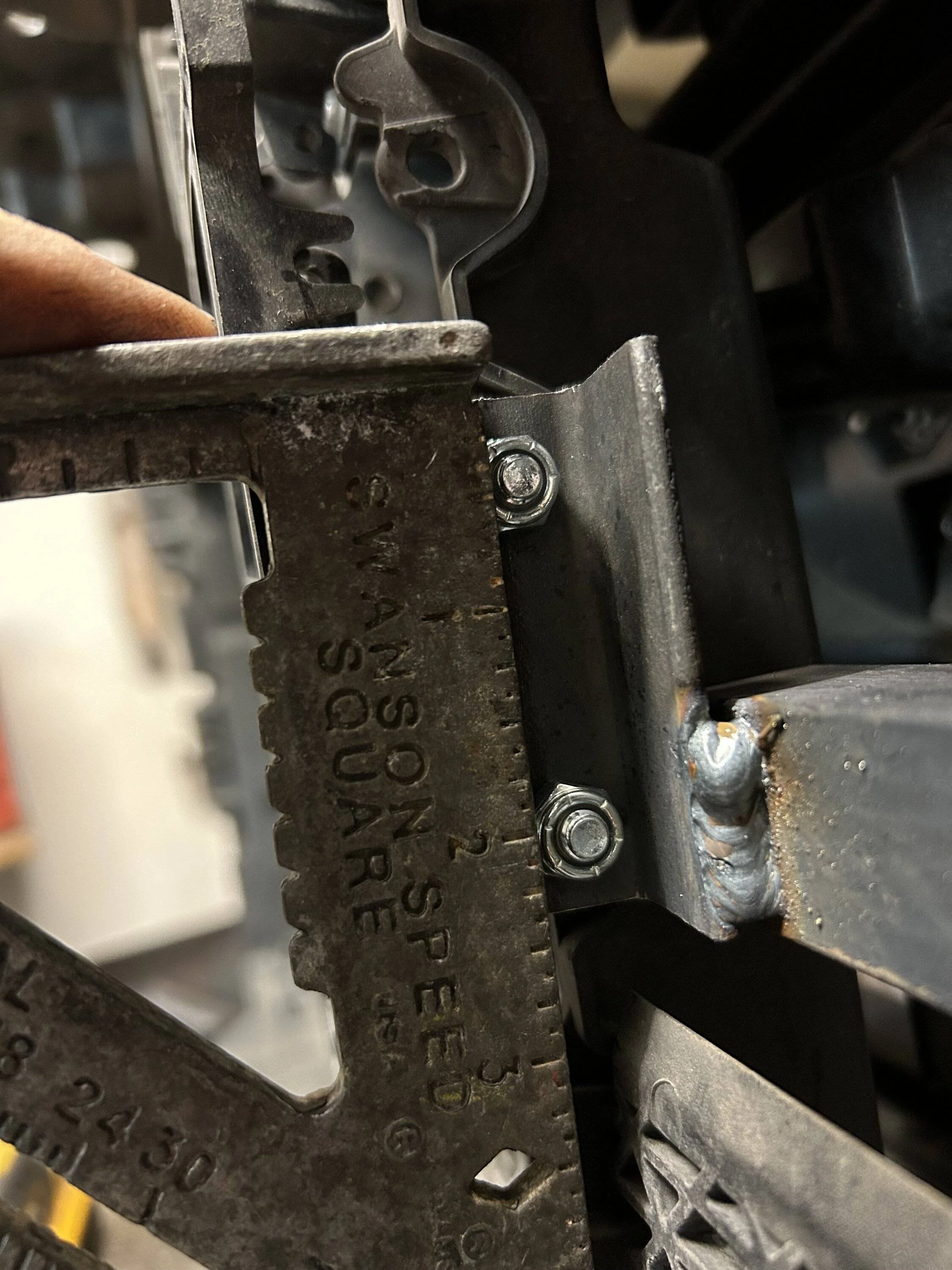

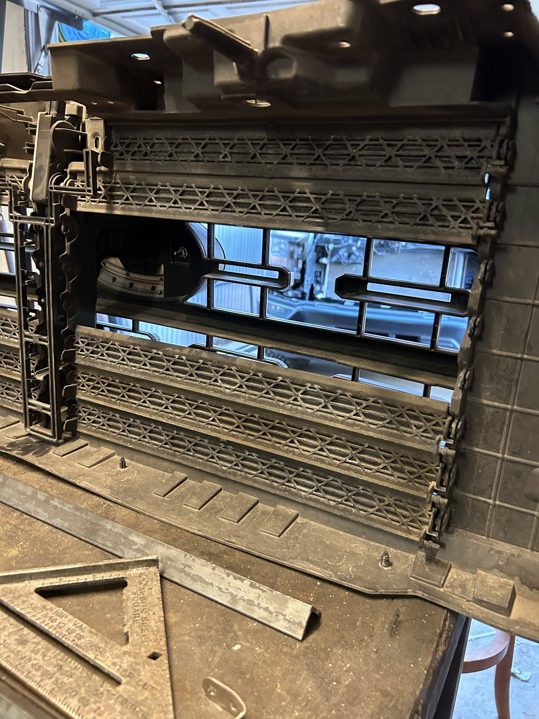

Had some scrap 1x1 1/8” angle from a gate project. And since the welder and grinder were out and I was already a mess, figured today was the day I tinker with this. Pop out 2 shutters per side. Cut 2 short pieces and bolted them to the active air dam brackets in 2 spots per bracket. (That’s 8 bolts in the 1/4x20 1” long flavor). Than cut a 15-16” long cross piece, eye balled it, tacked it, checked with the pod light, and welded it in. The only non reversible portion is using a cutter to trim back the plastic for the air dam shutters. A smaller bolt would eliminate this issue.
Anyways, my plan is to run a splitter harness from the oem fog harness.
Pics or gtfo….. feel free to copy, refine, and enjoy. These are junky Lasfit pods. BD, diode dynamics, and rigid should all work as well.

It was crazy simple vs other small lighting projects I’ve done. The active shutter system is super helpful for mounting stuff lol. Also don’t look too close at those bird sh1t welds.
