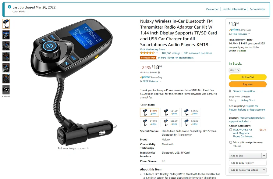

[SOLVED] I used a speaker I had laying around for a couple weeks, but ended up going with this:
https://smile.amazon.com/dp/B018E0I01I/
First I tried an old Belkin FM transmitter I had from the late 90's. Terrible static.
Then I tried a C.Crane FT-007 which should have been powerful enough to be heard inside my house. Marginally better than the Belkin, surprisingly.
Lastly I tried this, figuring enough people have been happy with it, since how often do you see a product with over 100K reviews.. Sitting under the drivers seat, plugged into a powerpole splitter and cigarette lighter outlet and also plugged into the ham radio, this solved my problem.
No static on the head unit.
I didn't want a transmitter that had a built in Lithium battery that would puff up in the heat, plus those aren't designed to stay on/charging 24/7. Had that happen with a dashcam. If you live in a hot climate, get a dashcam with a Supercapacitor to avoid that issue.
