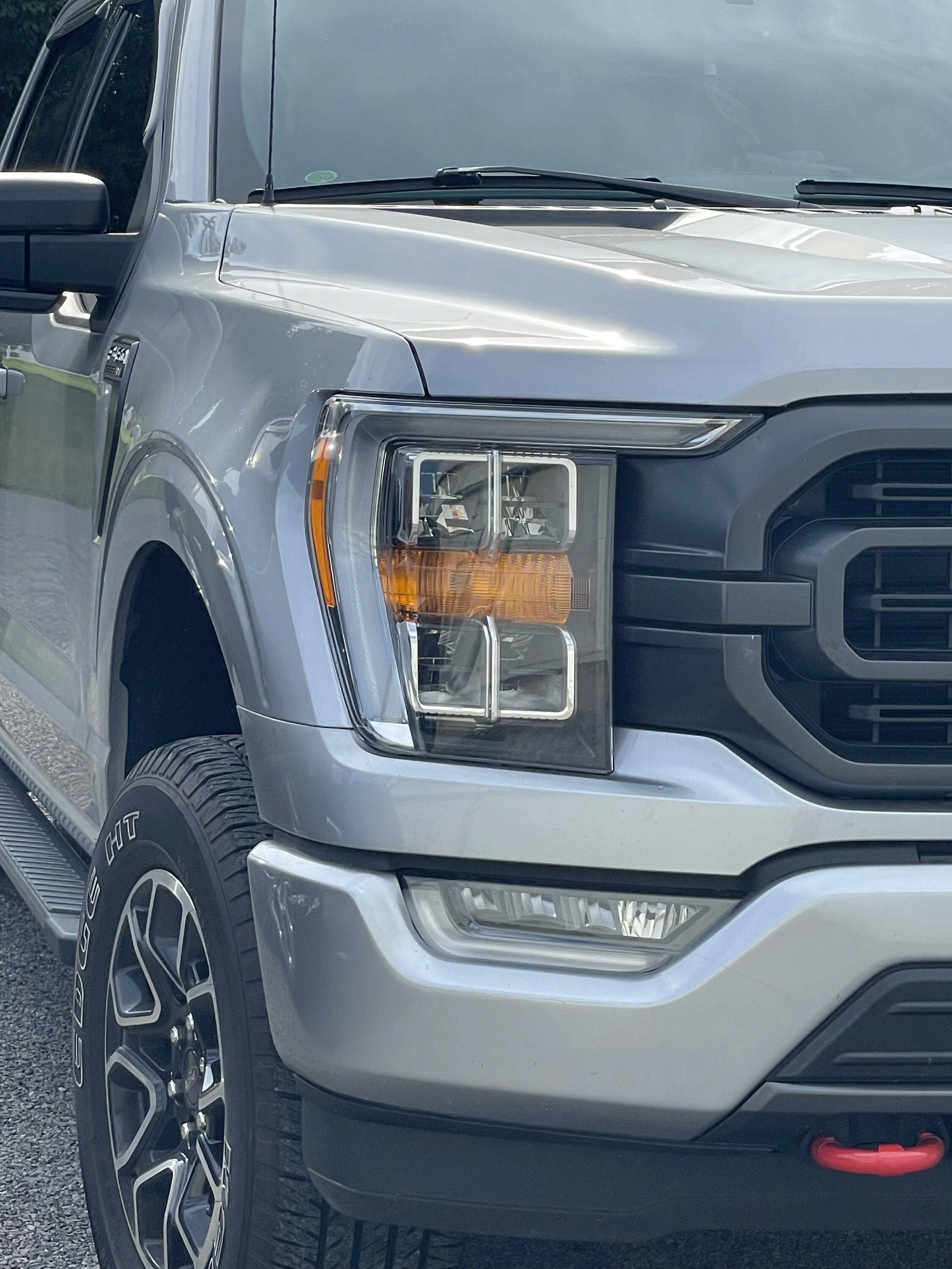

How in the world do I get the amber parking/running lights to come on? Or are they simply turn signal ? I don’t understand they are a dual filament bulb…any help greatly appreciated!!!!

I think the Raptor gets those nice amber DRL and the rest of us get the white. Maybe someone with Forscan knowledge knows if it is programmable or not.

Update. This light.

Have you tried moving lights from auto to parking? Not sure if that will work
There are only two wires to the tun signal socket. You would have to update the connector and add the park light wire to the new connector to get park lights to work in the quad setup pictured.

I have my DRL disabled, but wondering if that setting would also have the amber lights on while the normal lights are on?
I have a 2023 XLT 302a with the LED headlights if that matters
I don't know if you have figured this out yet... but yes. IF you have forescan, you can switch your DRL from headlights to parking lights. I did this! Love it so much more. Now my parking lights are my DRL and they are on all the time.
