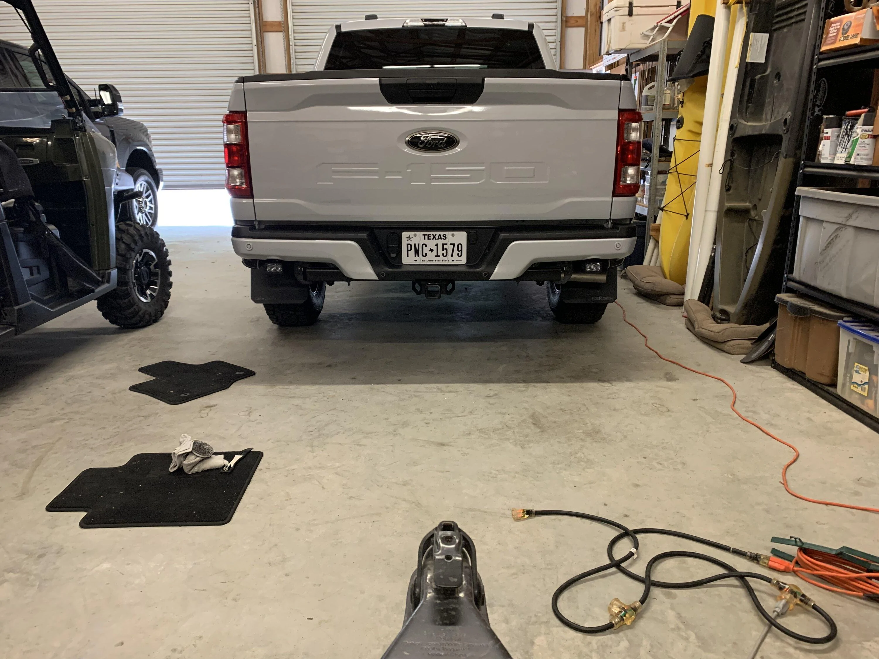

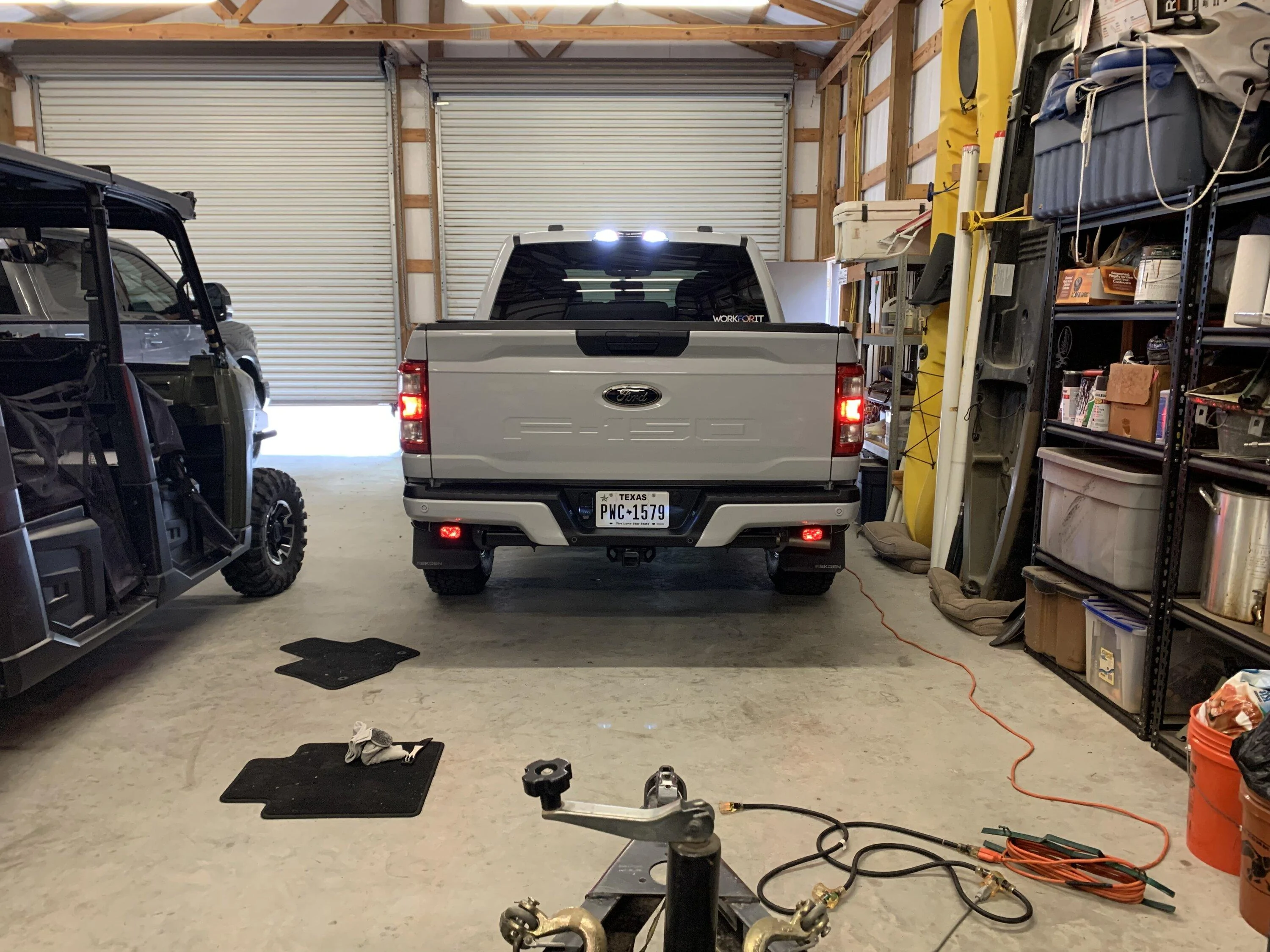

That’s an expensive part for a simple light. Maybe you we be better off with something like this.
Ford F-150 Adding Tailgate Handle with Trailer Light 1670614499065
Ford F-150 Adding Tailgate Handle with Trailer Light 1670614526456
SPV wiring harness and rear light brackets with diode dynamics ssc2 sports.
I can get some output shoots if needed!
