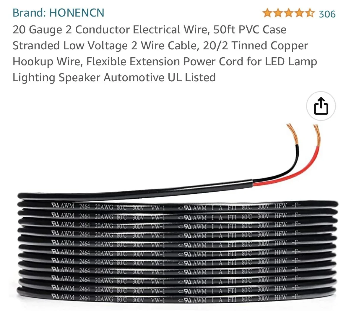

can’t help but think the speaker itself has 2 wires going in, a + and a -
You just need to break continuity by putting a switch inline on either line (a break in either will cause the speaker to be disconnected). Just give it a snip and run a line in and out of the switch using the same size speaker wire from amazon. Can’t imagine it’s that thick for such a small size speaker.
Should be very low risk, and putting this back to stock would just be putting continuity back (could be as easy as twisting the wires back together and covering with electrical tape and heat shrink). You wouldn’t do anything with the harness but rather the wires feeding the harness.
I’ve done many speakers hookups and I think you will find this should be pretty simple once you see the connector. If you find anything besides 2 wires going in, let me know.
If you have a picture of the speaker harness that you unplugged, post it here
This should be all you need:
