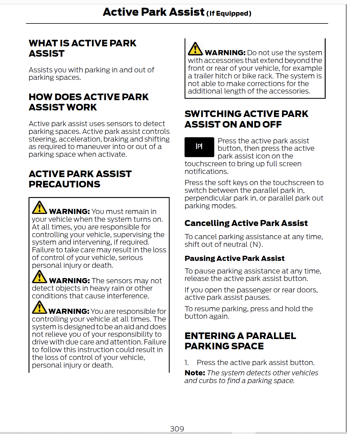

I never tried it out until today as I'm looking at the trailer hitch assist in the for scan thread and it seams the APA is needed for it to work.
Well when I hit the button all I get is this screen. I assume I don't have it. Anybody else have this?

Might be wrong but I think the trailer assist (I've never used either) is a different thing from the Active Parking Assist function. I found this to double check...that is the screen telling you to take the first step to start the parking assistance.
Ford F-150 active park assist or not 1697767170080
