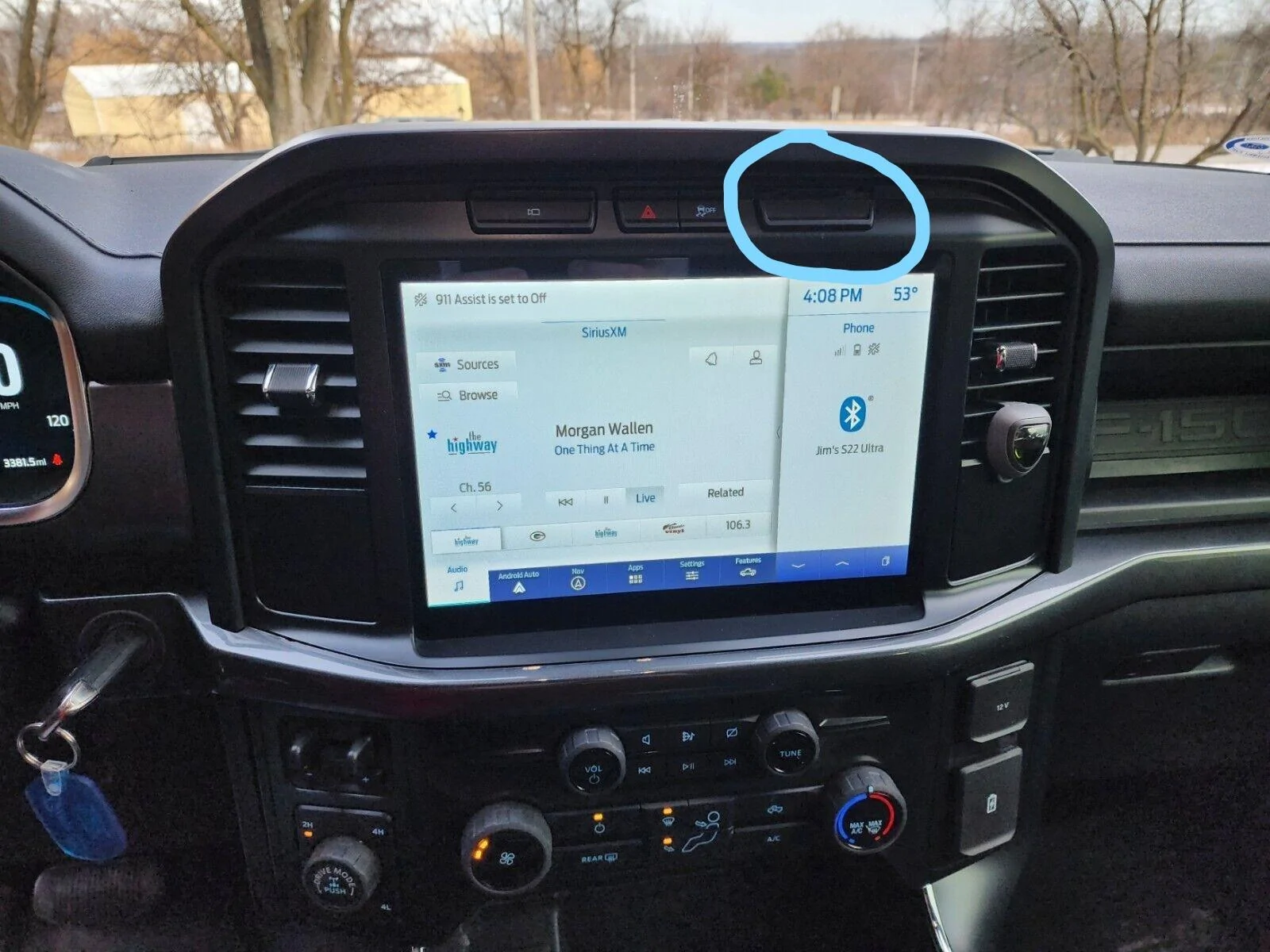

Ford F-150 8" to 12" Center stack screen upgrade Information Inkeds-l1600
I just did this swap, Anyone have the part number for this blank all black switch? I don't want the one with the silver trim as it wont match.
Ford F-150 8" to 12" Center stack screen upgrade Information IMG_0936
evoslayer
Nov 16, 2022
113
48
MI
'22 F150 XL RCSB 5.0
It's not a factory blank switch, it's a normal traction control button with a vinyl sticker overlayed.
The other option is to add hill descent control and then fill up the dash with real switches.
