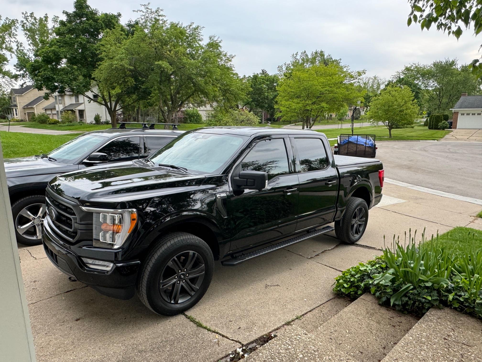

Couple of pictures before level

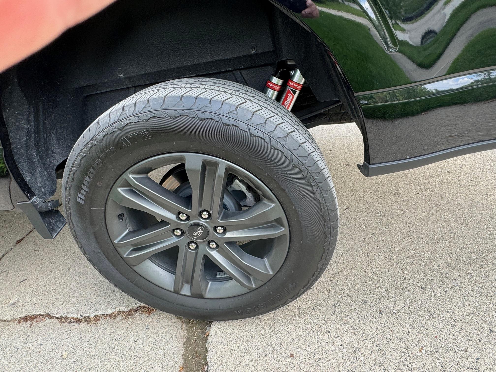

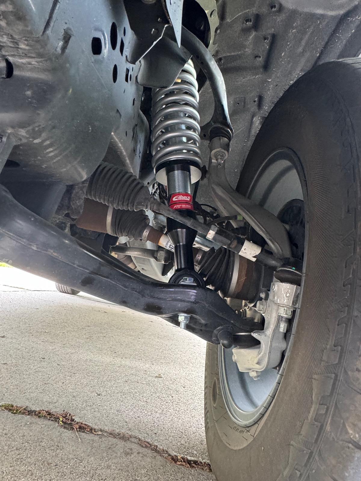

Pics of package before install
Well scheduled for installation Wednesday morning at a local shop. Will let you know how it goes! Hopefully more pics added tomorrow with complete level.

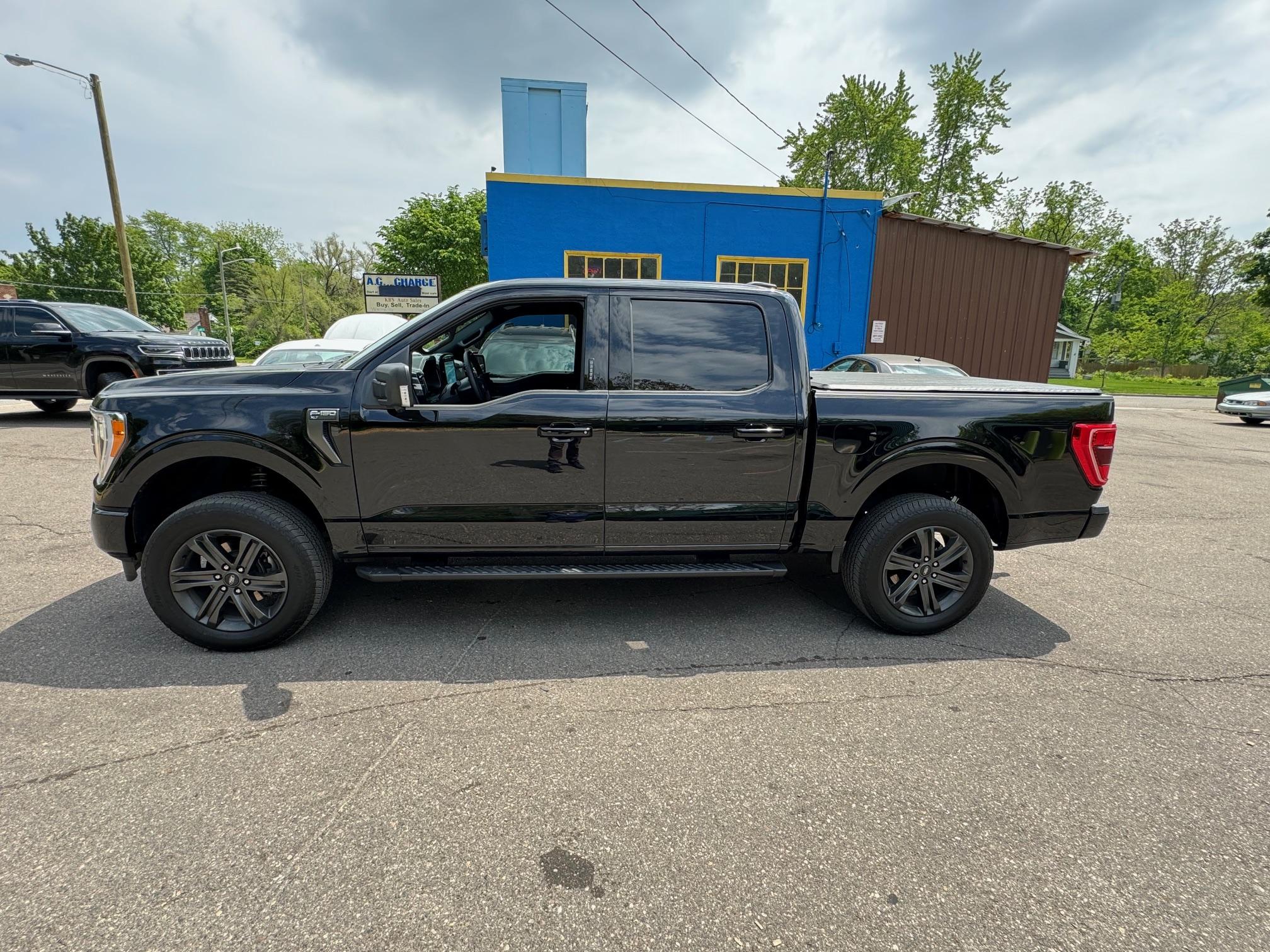

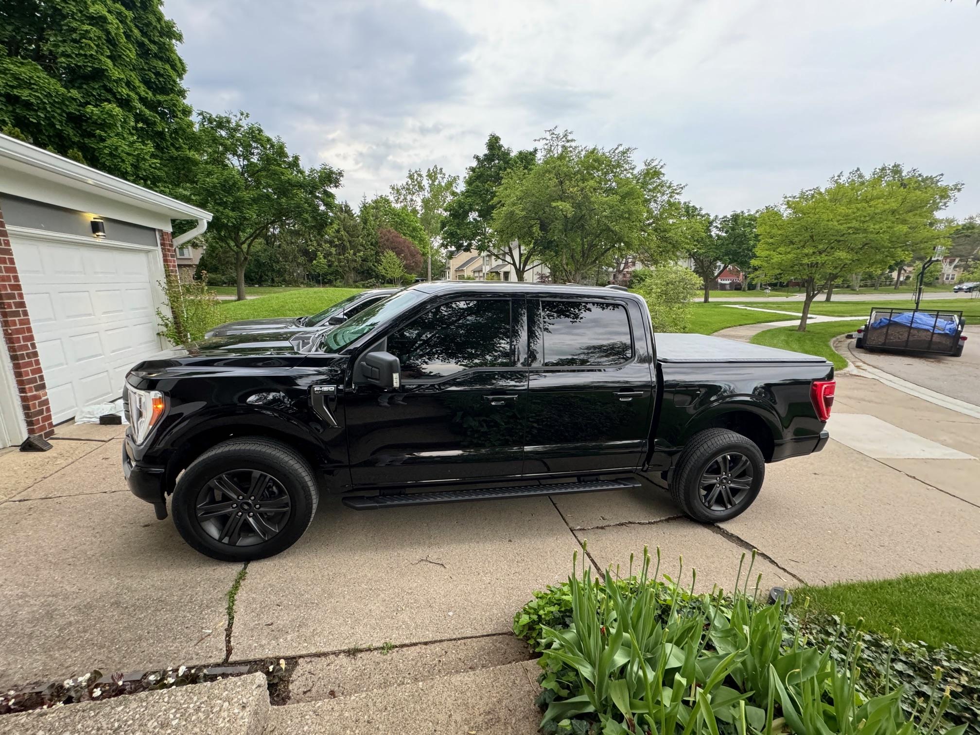

Shout out to @Hotshot Offroad
Got the kit installed today. Pays to have a good relationship with your local shop as they got me in at 9:00am this morning. Called at 2pm to tell me it was ready for pickup. Less than 48 hrs from order to install!!
First impressions. Love the look. Much more imposing even with stock tires. I was surprised how well they filled the wheel well but I am obviously going to get 35's as soon as I decide which ones to get. I'll get to that in a moment. Need to adjust the headlights down a bit. Does anyone know what the spec is for the headlights? Like focused beam height at 10 feet or something? gonna need to google that....
The ride so far seems very compliant. It still feels like a truck. I only have driven it about 4 miles back but I took it down some roads that are pretty torn up and in poor condition. Previously with the stock suspension there was a bit of jitteriness from the rear and it felt a bit hoppy at times in the front. With the Eibachs installed, it felt very planted and the bounciness was dramatically reduced. Can't wait to see how it does at higher speeds and handle the highway. I am hoping there is still level of cushiness that was there previously but I will report back once I have more miles under my belt with the level. Off road testing will need to wait until I have my tires and can get out into the country and some trails.
I am scheduled for an alignment tomorrow morning. I noticed a slight pull to the left and the steering wheel slightly off center after the installation. The shop I was at did a great job at getting it close but alignments are not something they are very good at...I wasn't charged for one. I want to take it to one with a full rack to put it on and get it dialed in correctly.
First pic is at shop before I got in it.
